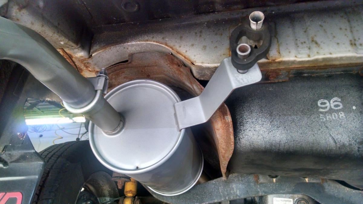

franbev Posted March 29, 2017 Share Posted March 29, 2017 Here's mine. Link to comment Share on other sites More sharing options...
skishop69 Posted March 30, 2017 Share Posted March 30, 2017 Right. That's what it's supposed to look like. One muffler in the back. No resonator up front. Link to comment Share on other sites More sharing options...
