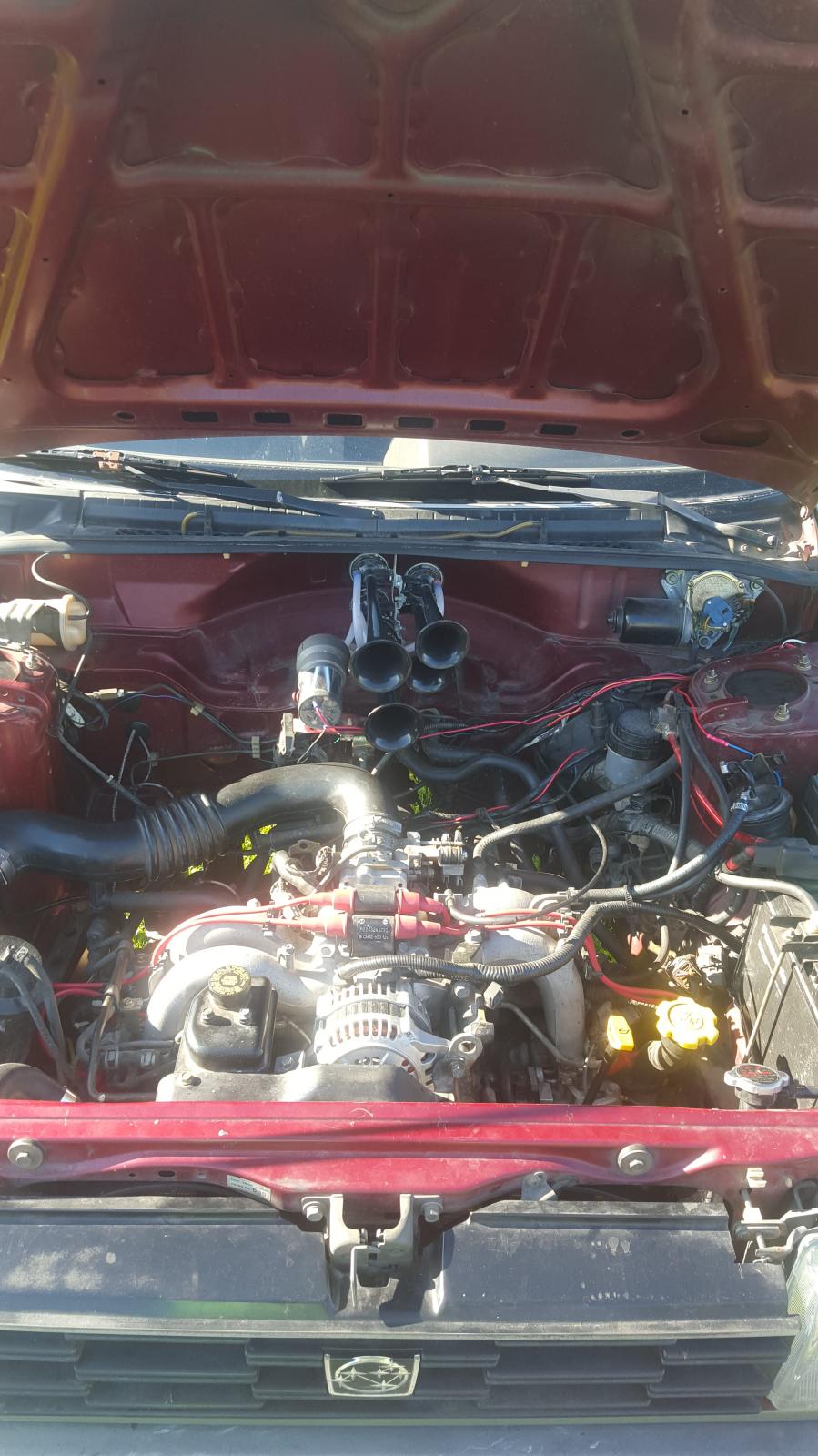

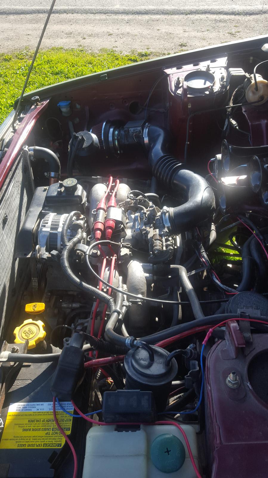

Torry33 Posted April 30, 2017 Share Posted April 30, 2017 (edited) I've been wanting to build another lifted wagon after giving my daughter my 93 lifted Loyale.So I found a super clean 86 GL wagon and picked it up for my project.155,000 miles on a rust free car with incredible interior for the age.This is the KEEPER!so plans include a 4 inch lift and an EJ SWAP!!and it happend today!did a power steering transplant from a 91 Legacy to my GL,that didn't have power steering.a couple of mods to that and it fit it there!Next I got ready to drop the EJ in.Slapped on my ADF adapter plate and clutch pack.cut the nipples off the EJ mounts and lowered the motor.after a few adjustments and BAM!its all bolted up in the engine bay.hopefully I can get it fired up tomarrow!have a thinned out harness that looks in order.that process took three days!installing the high pressure fuel pump out of a Loyale and running new fuel lines.Have a brand new radiator and some 12 inch cooling fans.Making progress! Edited May 22, 2017 by Torry33 Link to comment Share on other sites More sharing options...
Torry33 Posted May 1, 2017 Author Share Posted May 1, 2017 Got more done today!Radiator is in with hoses fit.got the EA hose to fit the top outlet and had an old hose laying around that fit the bottom.power steering pump is hooked up and the intake with all the breathers are in place,just need a cold air filter to fit in there nice.redid the fuel filter to the EJ style in the engine bay,with high pressure lines.old fuel pump is hanging by the wires,ready to get swapped for the high pressure one.been dodging rain drops all day here!sucks doing this in the driveway but Idont have garage.getting it together!soon as i get this EJ dialed in I will start getting things together for the lift.already have some 235/75/15 on 6 hlole mazda wheels.would like to get some pics up as soon as i can figure out how to post them.cooling fans and start the harness tomarrow! Link to comment Share on other sites More sharing options...
Torry33 Posted May 12, 2017 Author Share Posted May 12, 2017 Its ALIVE!!Got the EJ running!runs strong,and this thing hauls butt in the little GL!Had some problems with the alternator wiring but got that sorted out.most of my gauges dont work and all my dash lights are on but it runs good.so im just going to put in some after market water temp and oil pressure gauges for now.Time to start getting things ready for the LIFT!!!My last one i did was a simple 2 inch strut lift.This time im going BIG!!4 or 6 inches of lift is in order!time to break out the welder and cut off tools!also scored some square tubing of various deminsions for free to build a bumper guard and sliders for under the rockers!got a little cold air filter and modified the mass to fit.sits in there nicely!have one cooling fan on a toggle switch,seems ok for now,have another if i need it for hotter weather.got the stereo in there too,gotta have tunes!had the original subaru radio.kinda a pain to fit a full size Pioneer in there but with a little cut and weld to the stock braket and PRESTO!still have to fit the trim piece. Link to comment Share on other sites More sharing options...

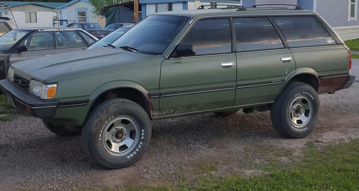

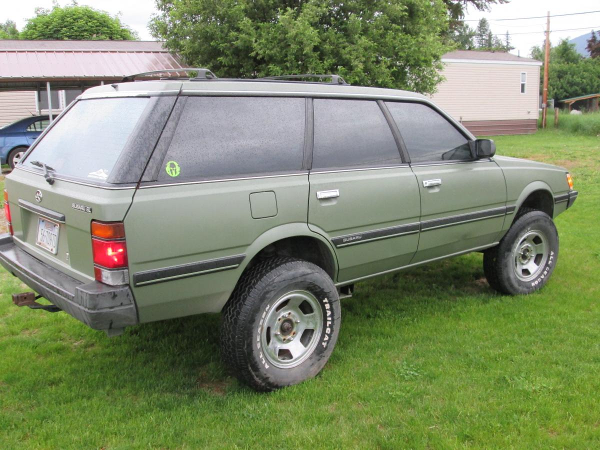

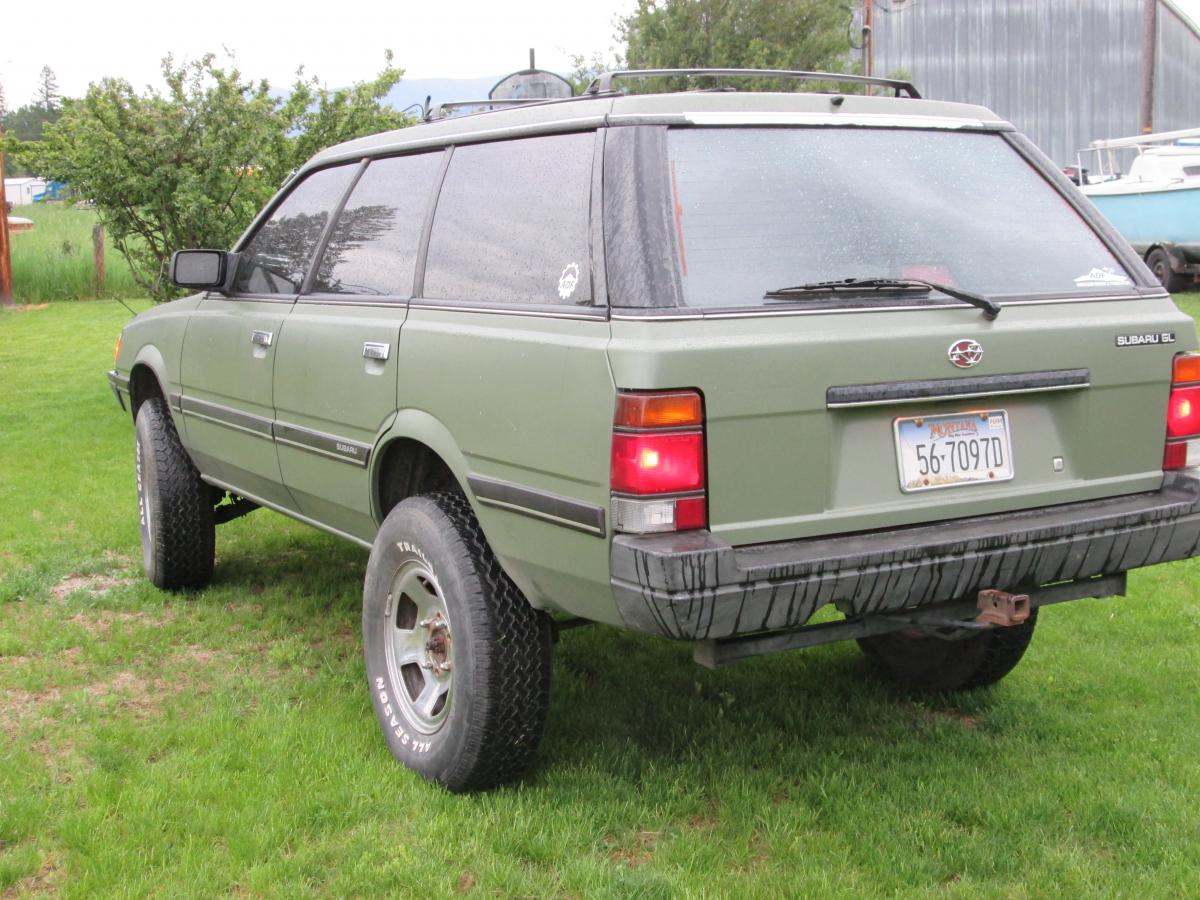

Torry33 Posted May 21, 2017 Author Share Posted May 21, 2017 ALL I CAN SAY IS HOLY COW THIS THING IS HUGE!!got the rear done yesterday and it is AWESOME!went to a yard sale and they were giving away piles of metal!i grabbed as much of it as i could.used some angle that i got for free for the rear strut lift.did the diff drop and the axle angles are perfect!5 inches of lift with 235/75/15 tires with no cutting on the fenders and all the original mud flaps still intact!starting the front today! 1 Link to comment Share on other sites More sharing options...

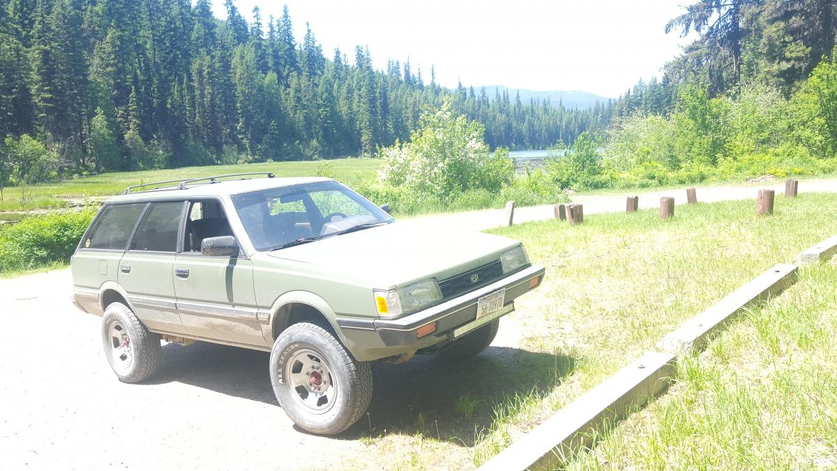

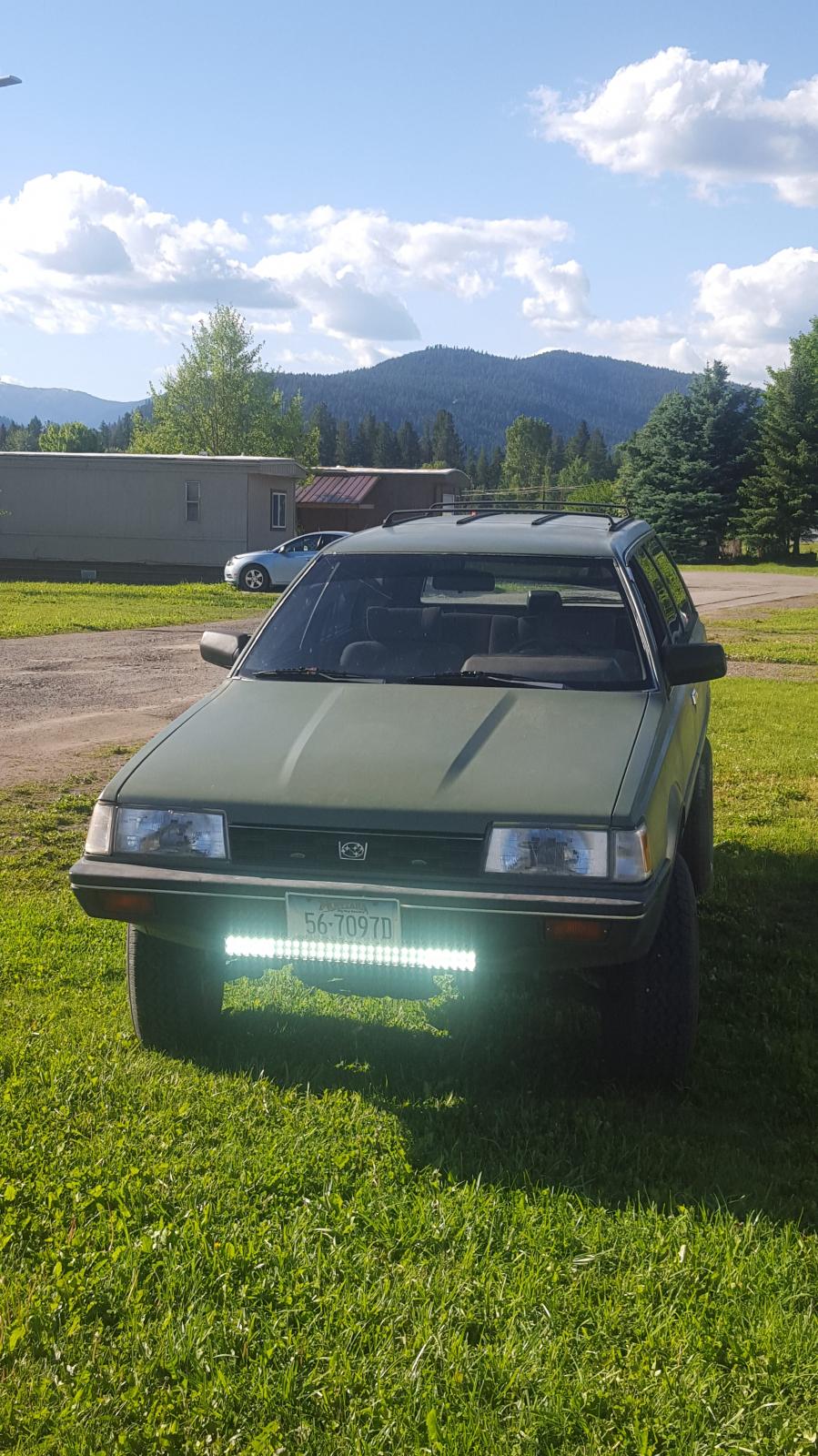

Torry33 Posted May 27, 2017 Author Share Posted May 27, 2017 (edited) ITS DONE!!got the front lifted and all the little things sorted out.what a good feeling to look at a tranformed Subaru that i built!this thing is a blast to drive and people are always checking it out!It Memorial Day WEEKEND and i got it done just in time to take it out and enjoy it!gonna be hittin some back roads for sure!should have no problems with clearance since i built a custom exhaut that tucks up where the driveline used to be.super cool!need to build a roof rack to carry a spare tire and get some LED ligts mounted.gonna build a front bumper too and add a winch!fun stuff! Edited May 27, 2017 by Torry33 Link to comment Share on other sites More sharing options...

Torry33 Posted June 5, 2017 Author Share Posted June 5, 2017 just got my LED light bar from UPS so im hooking that up today! Link to comment Share on other sites More sharing options...

Torry33 Posted June 6, 2017 Author Share Posted June 6, 2017 EJ swap out of a 91 legacy Link to comment Share on other sites More sharing options...
