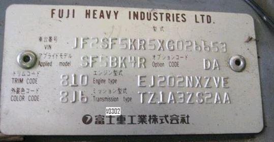

deadletter Posted May 9, 2017 Share Posted May 9, 2017 So I bought a 2001 Legacy/outback (before they became separate body models, I believe) and it had a bad transmission. He sold me, with the car, a transmission. I have the engine out and was swapping the two transmissions when... the flex plate doesn't match the torque converter. 1) I haven't tried yet, but can I put the old torque converter on the new transmission (if it fits)?2) Can I purchase the flex plate from a forester that would match the transmission I have? The transmission that I HAVE (the bad one) has a sticker that says tz1a3zs2aa-p4 The new one is tz1a3zc3aa-pm. I might have those backwards, I'm away from the shop right now. I'm not finding these in the lists of transaxles - and when I google it, the results are russian. Thoughts? for reference, when I bought it, the bad transaxle drove with a 'clunking' but not too bad. After a hard parallel park, it drove with a crazy heavy clunk back to the shop and was done. Link to comment Share on other sites More sharing options...

wtdash Posted May 9, 2017 Share Posted May 9, 2017 (edited) google: Old:Tz1a3zs2aa 1999 Forester - only site OTHER than Russian was from an Australia site and it showed this trans attached to an EJ20.'New": tz1a3zc3aa 2002 Forester - 2001-2002 - parts.subaru.com I'm going out on limb here....that original trans you removed was not the right one, either. I can't get to opposedforces.com from work but if you use that site and drill down to YOUR car - 2001 Outback - you'll find the 4EAT listed under the transmission section. And if you look under the TRAIN >> Differential (trans)>.Gear-set hypoid you'll see the FDR. Edited May 9, 2017 by wtdash Link to comment Share on other sites More sharing options...
