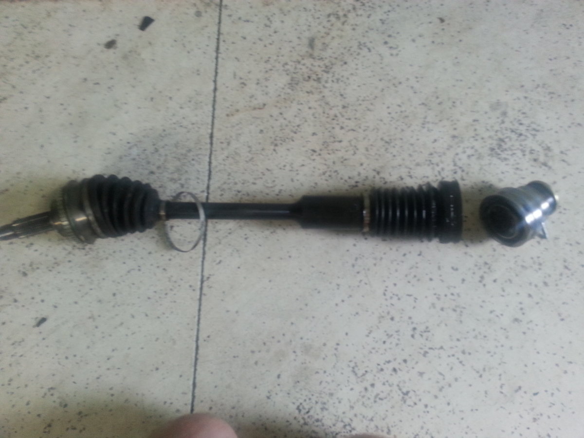

rotamonkey Posted January 19, 2019 Share Posted January 19, 2019 (edited) Interested to know if anyone has had any luck finding decent replacement axles? Finally got my subaru buggy out and the axle sheared on the shakedown. Is there anything bulletproof we can get that isn't custom? Edit: these were the SB8001HD axles, both failed in the same way within 3 months, not the CV's the axle material is the problem. Both snapped. Edited June 8, 2019 by rotamonkey Long term review Link to comment Share on other sites More sharing options...
idosubaru Posted January 20, 2019 Share Posted January 20, 2019 16 hours ago, rotamonkey said: Interested to know if anyone has had any luck finding decent replacement axles? Finally got my subaru buggy out and the axle sheared on the shakedown. Is there anything bulletproof we can get that isn't custom? For me the axle teeth were shredded on the inner CV, that's an aftermarket axle, what brand is it? It’s not uncommon for new aftermarket axles to blow up even on average daily drivers. Have you tried OEM used axles ? Link to comment Share on other sites More sharing options...
scalman Posted January 20, 2019 Share Posted January 20, 2019 (edited) aftermarket ones doesn't even work on stock cars , i buy used OEM's from scrapyards for cheap in pairs and have no prob. so big NO for aftermarket . wanna do it cheap ? go with used OEM's , buy a lot of them. they will hold ok still. Edited January 20, 2019 by scalman Link to comment Share on other sites More sharing options...
FerGloyale Posted January 20, 2019 Share Posted January 20, 2019 19 hours ago, rotamonkey said: Interested to know if anyone has had any luck finding decent replacement axles? Finally got my subaru buggy out and the axle sheared on the shakedown. Is there anything bulletproof we can get that isn't custom? For me the axle teeth were shredded on the inner CV, did you run a "turbo" axle 25 spline, on a non turbo trans? (23 spline) Or are you talking about the splines inside the CV cup that engage the cage? Link to comment Share on other sites More sharing options...
rotamonkey Posted January 20, 2019 Share Posted January 20, 2019 (edited) Thanks for the heads up. I will give the OEMs a go before I start looking for smaller wheels and tires. Spline counts were fine the axle itself must just be useless material, bad heat treating or something, snapped like a toothpick from flat on loose dirt. Failed where the inner axle (not the trans side) meets the CV. Edited January 20, 2019 by rotamonkey Link to comment Share on other sites More sharing options...
idosubaru Posted January 20, 2019 Share Posted January 20, 2019 1 hour ago, rotamonkey said: Thanks for the heads up. I will give the OEMs a go before I start looking for smaller wheels and tires. Spline counts were fine the axle itself must just be useless material, bad heat treating or something, snapped like a toothpick from flat on loose dirt. Failed where the inner axle (not the trans side) meets the CV. wash-rinse-repeat, that’s what they do. lost track of Subaru aftermarket axle failures. two new ones blew to pieces less than 100 miles out of the box on stock daily drivers. waste of time when there are perfectly good OEMs everywhere for cheap. Note earlier poster - asks about axles blowing up, tries more aftermarket axles, and blows up more axles. That’s about par for the course. Link to comment Share on other sites More sharing options...

rotamonkey Posted January 21, 2019 Share Posted January 21, 2019 Only running 30" tires, it is a small buggy. I was hoping that there would be some 300m / cro-mo replacements or something like that but as you say, better for the CV to snap than anything else. Time for a trip to the wreckers. Ill check the Cardone axles out as well. Thanks a ton. Link to comment Share on other sites More sharing options...

rotamonkey Posted January 23, 2019 Share Posted January 23, 2019 After some running around Ive grabbed some OEM second hand for now. Problem is to get the female connection at the transaxle side you are looking at CVs that are from cars near 20 years old and there aren't so many still around in the wreckers here. Subaru cant supply any part numbers without a VIN so Ive been struggling to get anything direct. Does anyone have a breakdown of part numbers by any chance. Link to comment Share on other sites More sharing options...
pontoontodd Posted January 23, 2019 Share Posted January 23, 2019 13 minutes ago, rotamonkey said: After some running around Ive grabbed some OEM second hand for now. Problem is to get the female connection at the transaxle side you are looking at CVs that are from cars near 20 years old and there aren't so many still around in the wreckers here. Subaru cant supply any part numbers without a VIN so Ive been struggling to get anything direct. Does anyone have a breakdown of part numbers by any chance. If you go to subarupartwholesale.com you don't need a VIN. If you need a VIN, the easiest way is just to look up that car on ebay motors and find one for sale, I think they all list the VIN. Link to comment Share on other sites More sharing options...
1 Lucky Texan Posted January 23, 2019 Share Posted January 23, 2019 I haven't looked for axle numbers but, you could try www.opposedforces.com Link to comment Share on other sites More sharing options...
rotamonkey Posted January 23, 2019 Share Posted January 23, 2019 (edited) Thanks, Opposed Forces definitely did the job, for those interested it looks like the P/N's for the female trans side axles are: 28321FE041/ 042 28321FE061 28321FE092 Looks like there are a ton of variations but the later numbers seem to be later model variants, roughly $400 AU Each brand new. Edit: unfortunately there seems to be a few lengths of Subaru axle shaft, some with an inch or less difference without other visual changes. Be careful with part numbers... be sure to check your exact application. Edited June 8, 2019 by rotamonkey Important note to add Link to comment Share on other sites More sharing options...
