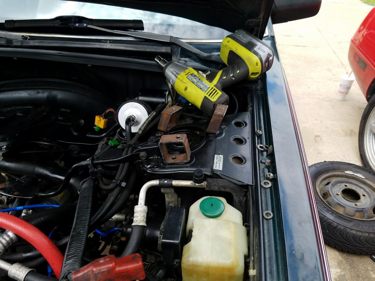

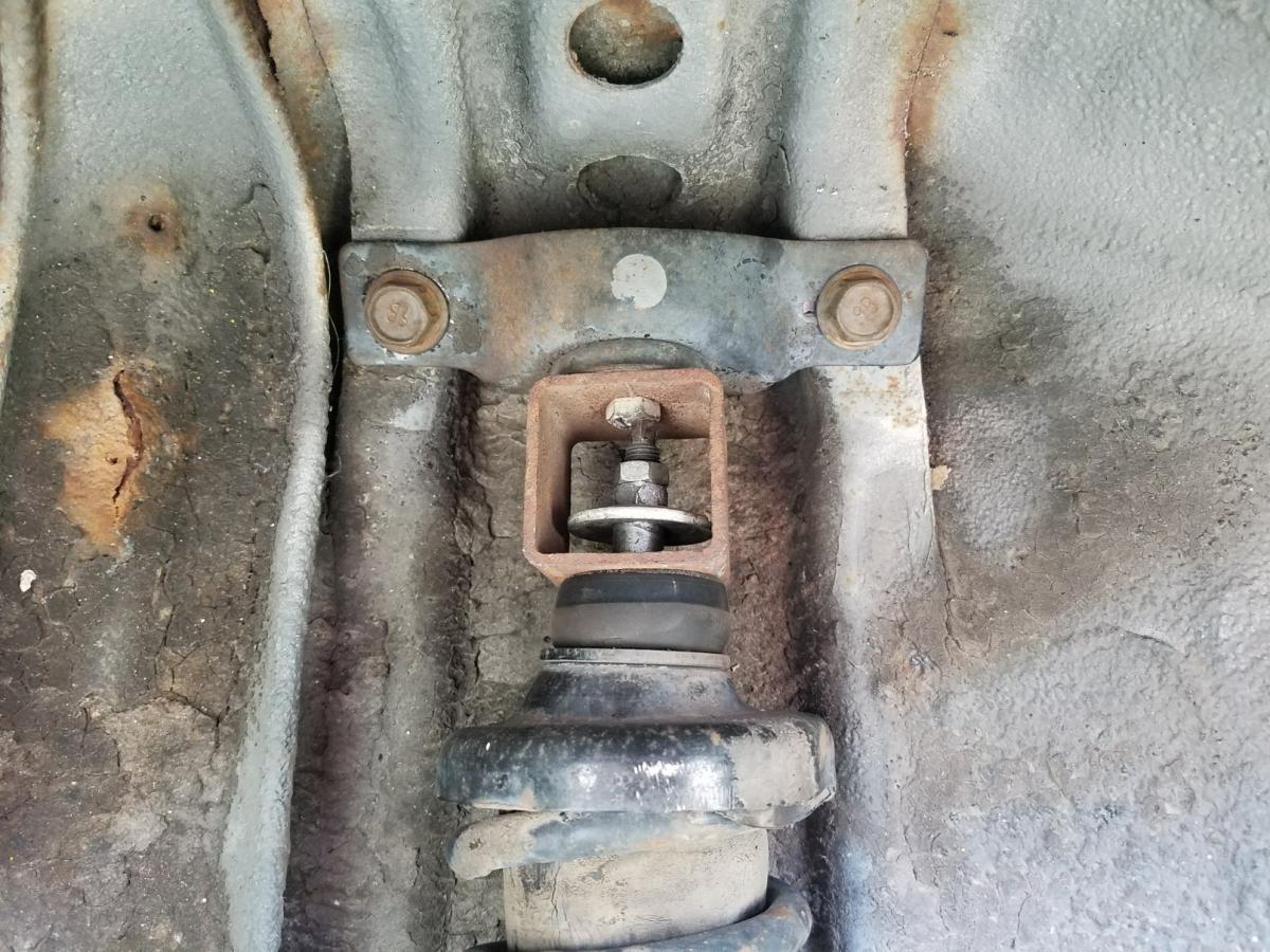

TheGageinator Posted May 27, 2017 Author Share Posted May 27, 2017 (edited) Pics of the strut spacers Edited August 20, 2017 by TheGageinator Link to comment Share on other sites More sharing options...
