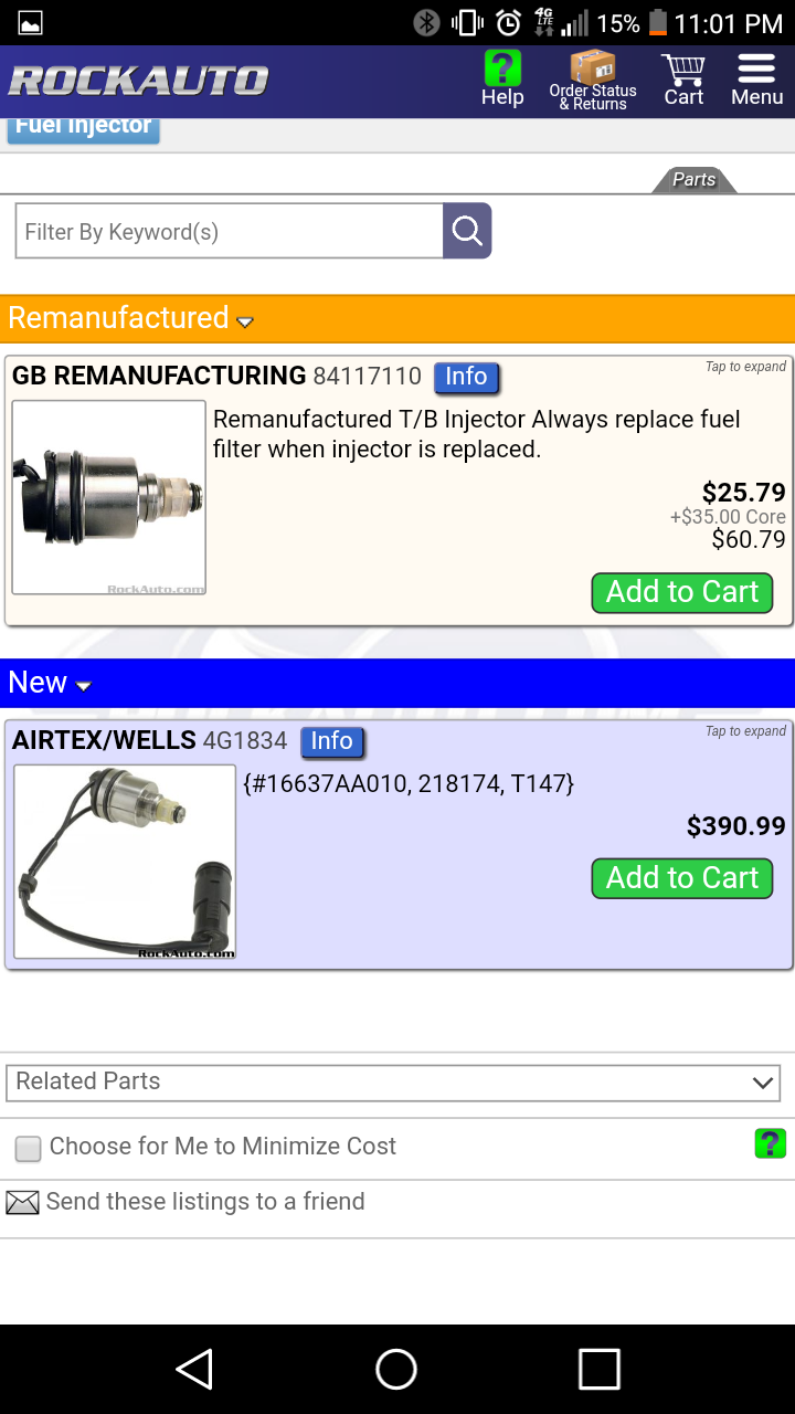

l75eya Posted August 25, 2017 Share Posted August 25, 2017 Literally took me about 3 minutes to look up a 93 loyale on rockauto and screenshot it. Link to comment Share on other sites More sharing options...
