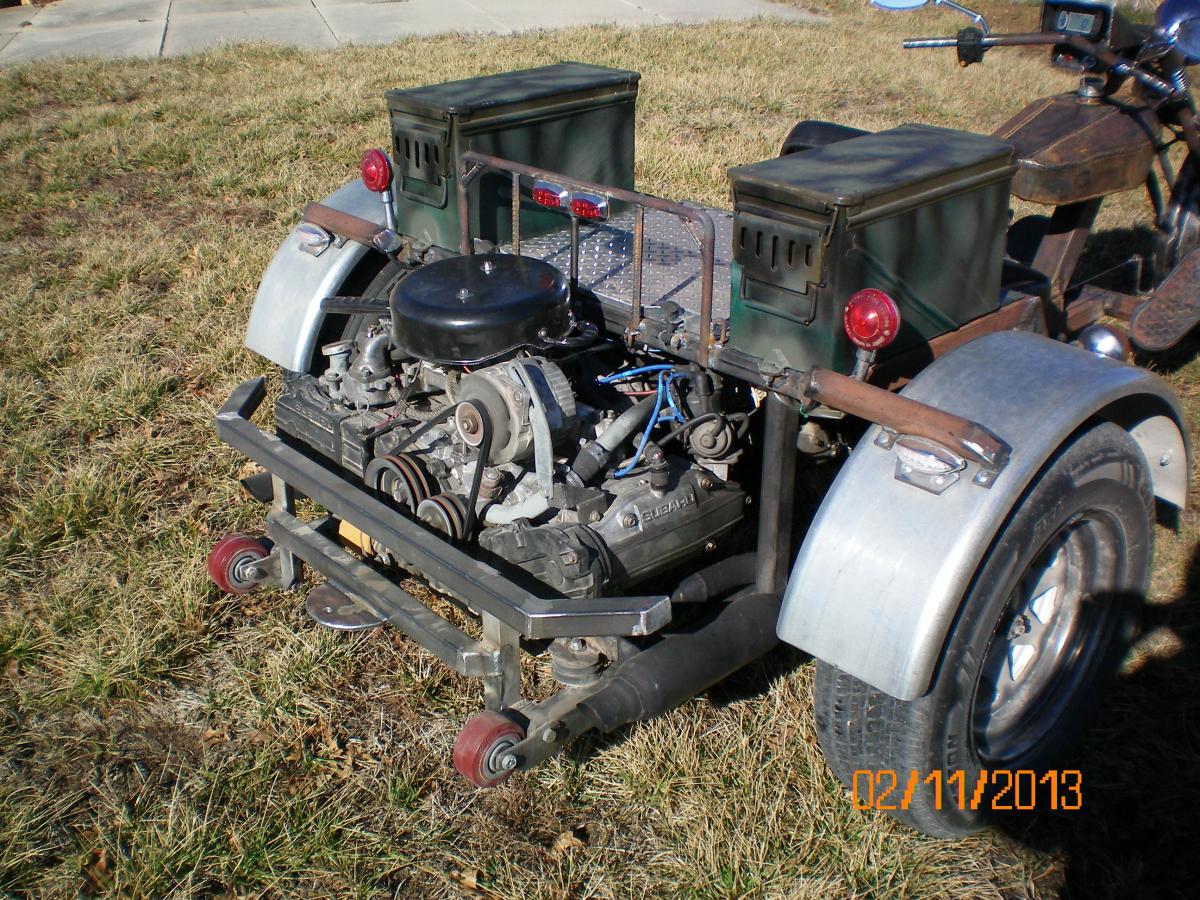

Crazyeights Posted August 24, 2017 Share Posted August 24, 2017 (edited) You don't see "wheelie bars" and an EA82 in the same photo very often! LOL Edited August 24, 2017 by Crazyeights Link to comment Share on other sites More sharing options...
