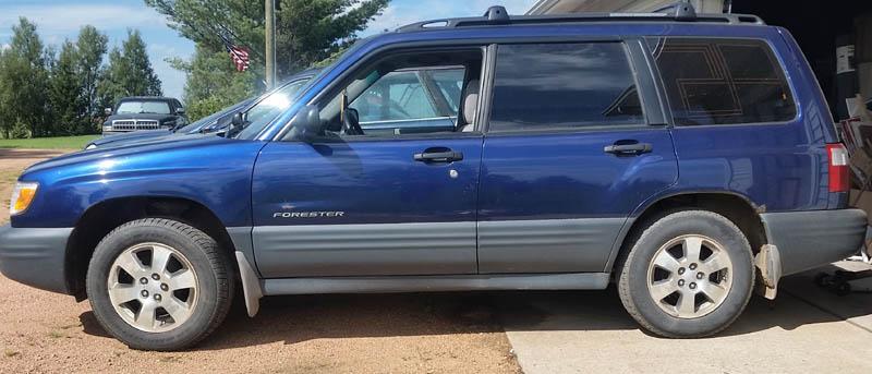

thook44 Posted August 30, 2017 Author Share Posted August 30, 2017 oh, the lust....https://i0.wp.com/offroadsubaru.com/wp-content/uploads/2016/02/IMG_3737.jpg right?..lol! so, i was talking to my wife about all this stuff and she's like..."uh, what about the sunroof?"...haha! well, those didn't come factory until 2001. hmmm... Link to comment Share on other sites More sharing options...
matt167 Posted August 30, 2017 Share Posted August 30, 2017 That Forester is at least a 2001. Those tail lights were used 2001-2002 only, and the front is a little bit different than 1998-2000 too.. Sunroofs were not standard in 2001. I have a 2001 "S" with no sunroof and a 5spd with cold weather package. It's an odd one for sure You could swap harnesses or merge an older ECU. People do that with the older Turbo ECU's in states that do not require to be plugged in for any inspection... But it would be a complete waste of time for a N/A EJ22E Link to comment Share on other sites More sharing options...

matt167 Posted August 30, 2017 Share Posted August 30, 2017 yes...it is indeed a 2001 in the pic. hence the factory sunroof/2001 reference. i just posted it for fun not sure what you mean "merge" an older ecu. unless you mean running in tandem? this leads me to suspect you may still not understand what is i'm asking at this point Harness merge is extremely popular in Subaru usually to gain turbo engines.. Basically all the cars are close enough but different enough that nothing matches up perfectly if you were to just swap harnesses. What you end up doing is using most of the donor harness which is modified to fit the car your putting it into using remements of the harness you took out.. Things like cluster wiring, light wiring, HVAC wiring all need to be converted to the car your using by using those parts of the harness, matched up and spliced using diagrams ect...... It's an involved process that costs $800-1000 to have done professionally. You could put a 1994 engine in a 2004 something doing it that way, with a couple big hiccups. One being your speedometer will not work without "hackery". 1994 as far as I know were all cable driven speedo, so speed sensor would have to have a seperate circuit as the harness will not have it. ALL of the HVAC is different and if you know the SG6 HVAC has the funky dial for the switch, you have to make all that work... The other big one is, you loose OBD-2 compatibility and then the value of it drops pretty much 100% if you ever wanted to sell, and you WILL hate this car when your done.. The only swap I would even consider for this crazy project is a 1998 Forester harness and cluster complete into 1999-2002 Forester. OR you could also use the wiring harness from a 1997-1998 Impreza wagon with some minor adjustment. Link to comment Share on other sites More sharing options...
