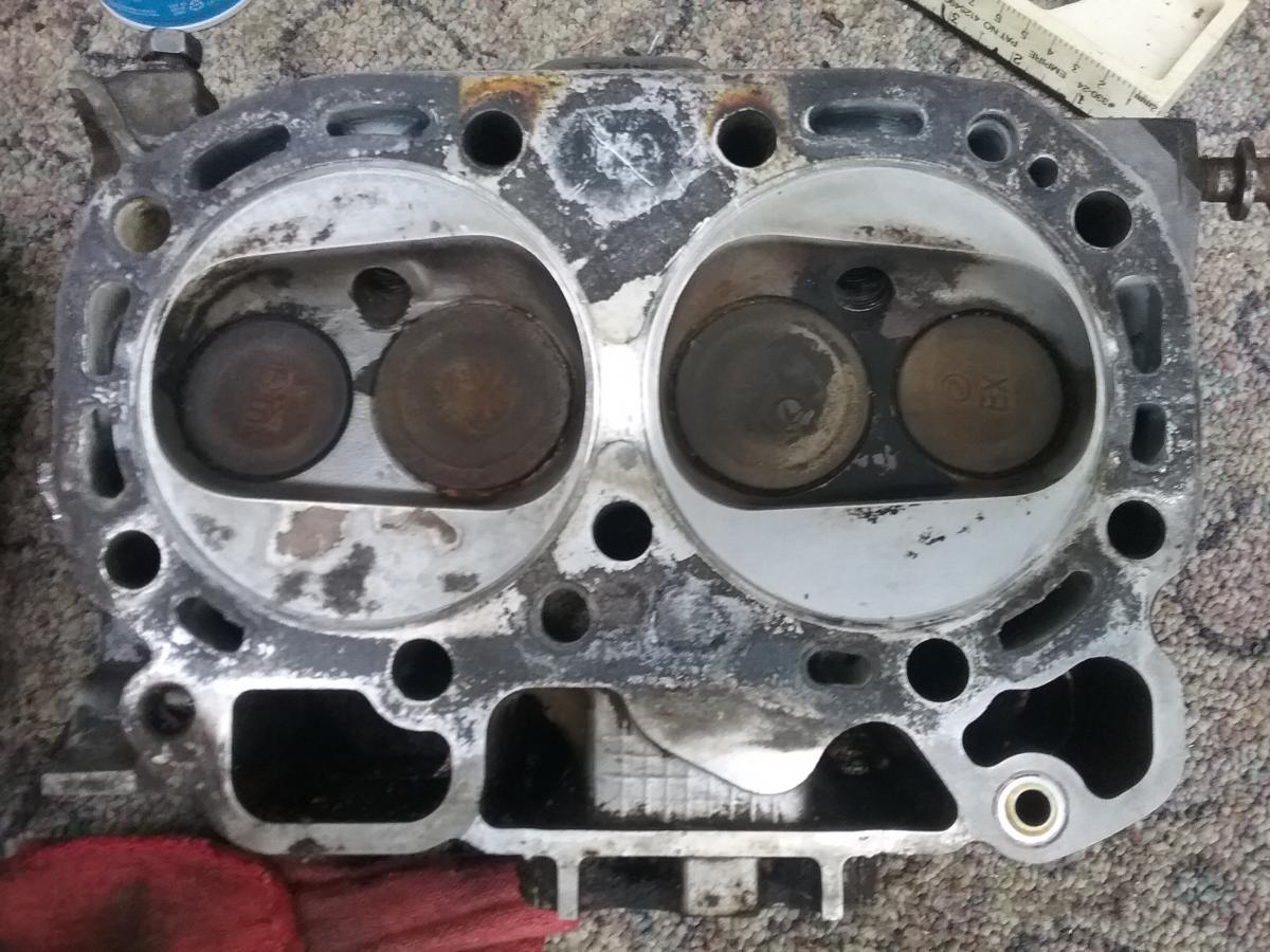

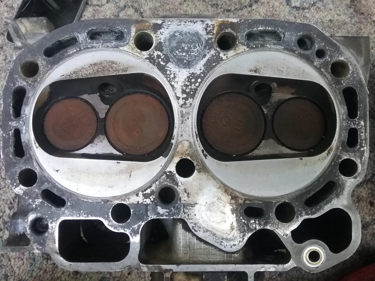

MWLoyale Posted September 6, 2017 Share Posted September 6, 2017 Hi, I am currently cleaning up my heads on my first rebuild and I have some questions. First of all my driver side valves aren't seated flush like the passenger side valves. Will this be an issue if I just put it all together as they are (do I need to replace the valves or seals)? Second, what's the best way to get the clean the carbon build-up? I've been using carb cleaner on a rag and it's only gotten me so far. I'll post pictures soon, thanks. Link to comment Share on other sites More sharing options...

DaveT Posted September 6, 2017 Share Posted September 6, 2017 AS far as I can see from the pics, it looks like different batches of valves or something was used. Notice the small differences between them. I've never done much about cleaning everything, just get rid of loose stuff, wire wheel the valves if they have lots of crud on them. One engine I rebuilt had loads of crud stuck on the intake side of the intake valves, you can't see it until you remove them. You do need to resurface the face of the heads, either by machine shop, or the post apocalyptic method, to get rid of the marks made by the fire rings of the head gaskets.. Link to comment Share on other sites More sharing options...
