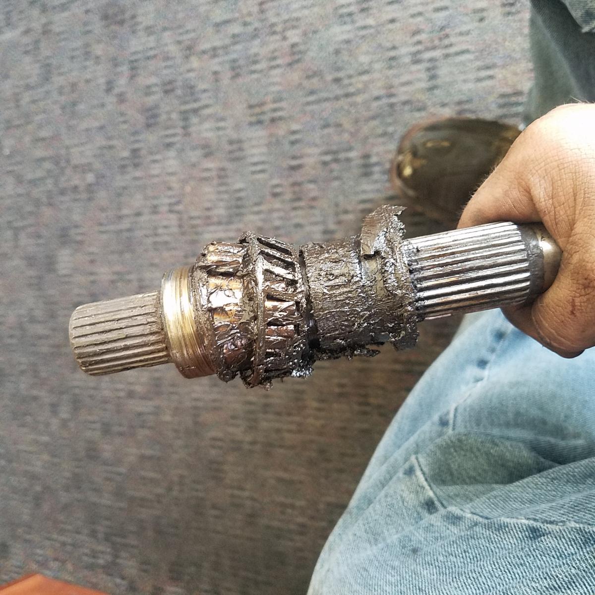

XHighOctanex Posted September 19, 2017 Author Share Posted September 19, 2017 So this has now become an emergency situation. On the way to work today the bearing completely imploded and stranded me on the side of the freeway for about a half hour while I got the axle off and checked everything and limped the car to work. I'm supposed to be going on a trip this weekend and as always something has to break last minute. The entire bearing is garbage now, I have a new one and everything is loose but I'm gonna have to get that stupid nut off and hope I didn't hurt the spindle. Any recommendations? Link to comment Share on other sites More sharing options...

XHighOctanex Posted September 20, 2017 Author Share Posted September 20, 2017 (edited) Update, today got the rear nut off easy with the control arm off the car and a modified gm socket (2 prongs cut off) gonna send it to napa to have everything pressed and should be good Edited September 20, 2017 by XHighOctanex Link to comment Share on other sites More sharing options...
XHighOctanex Posted September 20, 2017 Author Share Posted September 20, 2017 Clean it up, new grease, reinstall it. 20k at least on this puppy. The cage by the way is cracked in half and I'm missing about half the bearings Link to comment Share on other sites More sharing options...
