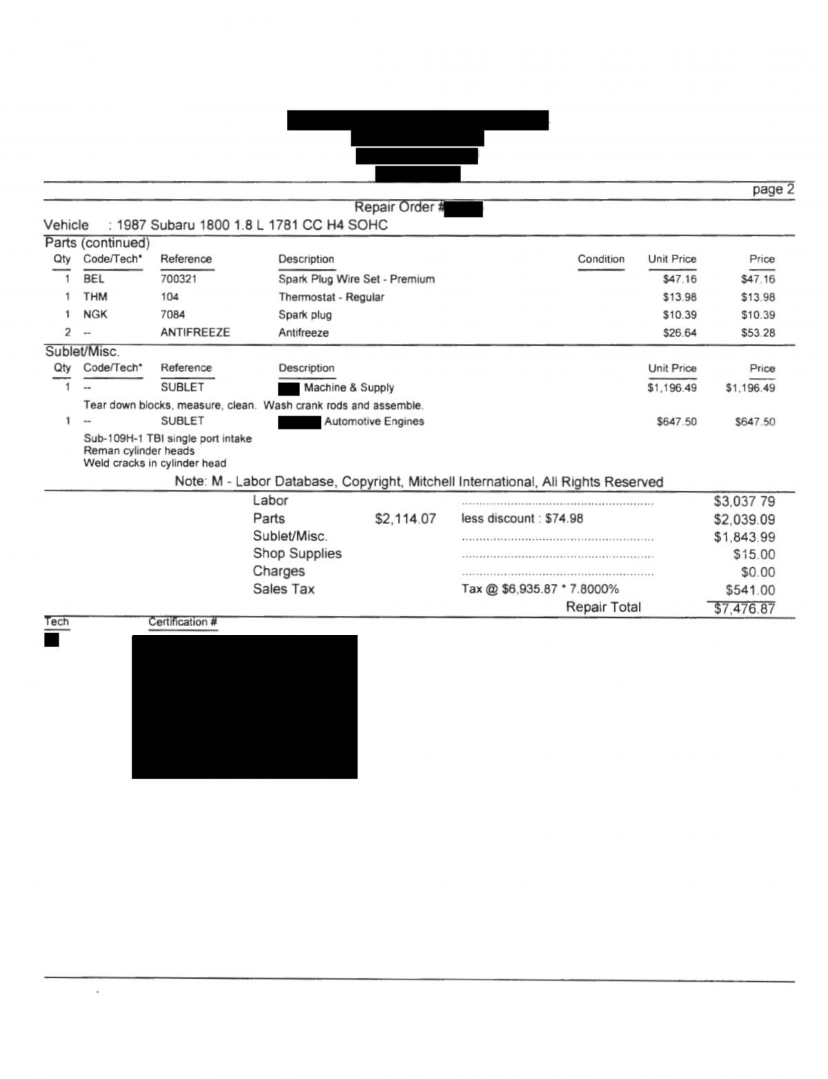

jono Posted October 6, 2017 Share Posted October 6, 2017 I reckon we would all love to see copies of receipts worth seven grand on this engine!! Link to comment Share on other sites More sharing options...
PalouseLeone Posted October 9, 2017 Author Share Posted October 9, 2017 On 10/6/2017 at 10:42 AM, jono said: I agree withGloyale on the single pin connector in black being the knock sensor connector but can't see how it is in that position for the photo, maybe series two are wired that way? It should then fit to a green knock sensor just next to the rear pcv breather tube back of the block at the top rear of cyl #3 OK, thank you for your help. I got the Chilton repair manual in the mail and your description of the location is much easier to follow compared to the manual. On 10/6/2017 at 10:44 AM, jono said: I reckon we would all love to see copies of receipts worth seven grand on this engine!! Here you go. So the car was stolen off his lot while awaiting to have ball joint, clutch, and flywheel replaced. We actually paid for the ball joint, clutch, and flywheel and the installation costs previously, the mechanic shouldn't have left those on the same repair order as the engine. The kid who stole the car was also ordered to pay the mechanic $1,600 in damages. The irony in this situation is that we specifically purchased a turbo with the mindset that it would simplify a future EJ swap. This would have been the perfect opportunity to do it. Several times the mechanic's secretary told me they couldn't find an EA-82T anywhere or that they found one, but it was damaged. Each time the secretary told me they were having troubles, I suggested that the mechanic swap the EA-82T for an EJ, but I never received a positive response. It seems like in the end, swapping in an EJ may have been less expensive and less of a headache for the mechanic. Link to comment Share on other sites More sharing options...

rdweninger Posted October 10, 2017 Share Posted October 10, 2017 I am just amazed at the $26.62 per gallon antifreeze. And he billed for 2 gallons! With a 6 quart cooling system, at 50/50 mix, only 3 quarts of antifreeze is required. Link to comment Share on other sites More sharing options...

GeneralDisorder Posted October 12, 2017 Share Posted October 12, 2017 On 10/10/2017 at 7:22 PM, rdweninger said: I am just amazed at the $26.62 per gallon antifreeze. And he billed for 2 gallons! With a 6 quart cooling system, at 50/50 mix, only 3 quarts of antifreeze is required. Normal shop pricing. I charge 25 a gallon and that's for pre-mixed with distilled water (I buy in bulk 50 gallon drums). Though I would have charged for 1.5 because they is system capacity. GD Link to comment Share on other sites More sharing options...
GeneralDisorder Posted October 12, 2017 Share Posted October 12, 2017 That invoice is a horrow show. This "mechanic" knows nothing about Subarus or turbocharged engines obviously from the pictures. I wouldn't trust that thing to make it around the block given the inept way things have been hooked up just on the basic visual you have done. And leaking fluids.... god only knows what's gone on inside the engine. You can definitely spend a PILE of money on an EA82T. I have a customer that's spent well over $20k. And we still haven't done an EJ swap. Frankly they just aren't a viable platform to take to a mechanic anymore unless it's a specialist. I'm sure he did have serious problems finding a good engine. You can't get parts for these anymore. I've bought "the last one in the country" probably a dozen or more times working on EA's in the last few years. GD Link to comment Share on other sites More sharing options...
