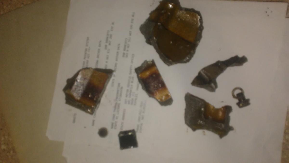

Badchad14 Posted October 13, 2017 Author Share Posted October 13, 2017 Well here is the too of motor under the intake tubing. Catastrophic failure just as I suspected. Only worse than what I originally thought. Hope the pic loads. Need a new engine block. Both halves. What's the best route to go in this situation. Funny thing car still starts and runs. No oil and half the engine missing. Subie all the way. Advice? Link to comment Share on other sites More sharing options...
Badchad14 Posted October 13, 2017 Author Share Posted October 13, 2017 At this point in time the axle failure is irrelevant unless the binding and breaking caused the failure which in my mind yeah it probly did have a large part of this happening. Trans and engine rebuilt 94000 miles ago and it's at 261xxx. Money is all I need to get it going and jobless unemployment isn't gonna buy me a damn thing. Where to I start obvious pull the engine and trans but least expensive option to get it built up again. Any ideas. Link to comment Share on other sites More sharing options...

Badchad14 Posted October 13, 2017 Author Share Posted October 13, 2017 My motor is fried. No metal on top side left and intake cracked. Probly scrap this for the 100 dollars and hope to buy the legacy gt sedan. Link to comment Share on other sites More sharing options...
