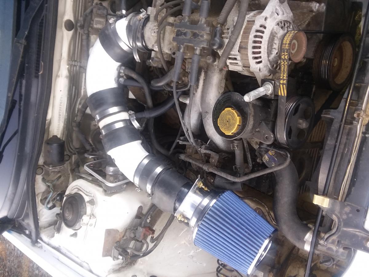

Subieguy165 Posted October 29, 2017 Share Posted October 29, 2017 (edited) Can I get some thoughts on this intake short ram tube I made Edited October 29, 2017 by Subieguy165 Link to comment Share on other sites More sharing options...
GeneralDisorder Posted October 29, 2017 Share Posted October 29, 2017 But why? Something to do? I get it but you could prep a used 2.5 block with your time and eventually gain ~30 HP. That intake won't do anything for performance. Really on a 2.2 there isn't much that will. GD Link to comment Share on other sites More sharing options...
Gloyale Posted October 29, 2017 Share Posted October 29, 2017 But why? Something to do? I get it but you could prep a used 2.5 block with your time and eventually gain ~30 HP. That intake won't do anything for performance. Really on a 2.2 there isn't much that will. GD Yeah....uh.....that will work, but having no flex might not be good for hte MAF/airbox as it will be straing on it when engine torques. I hope you don't have a cone filter on the end of that either. those things are the worst. Hot dirty air though a glorified scotch brite pad. 1 Link to comment Share on other sites More sharing options...
Fairtax4me Posted October 30, 2017 Share Posted October 30, 2017 Not gonna be well received on this board. Like Gloyale said, the intake tube needs a section where it can flex because the engine moves when the car is driving. PVC is rigid, Probably gonna break something. Link to comment Share on other sites More sharing options...

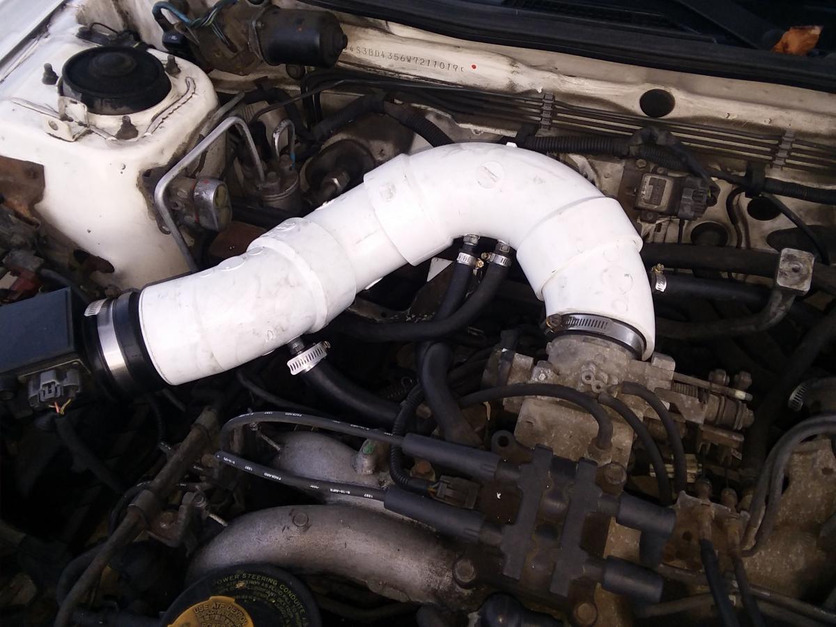

Subieguy165 Posted November 2, 2017 Author Share Posted November 2, 2017 Have an update he silicone collars on all the joints now and the ends of the pipe as well Link to comment Share on other sites More sharing options...
Subieguy165 Posted November 2, 2017 Author Share Posted November 2, 2017 Yes something to do Link to comment Share on other sites More sharing options...
DOHCEJ22E Posted November 2, 2017 Share Posted November 2, 2017 I don't see anything wrong with that when it comes to function. For as crude as the design is, and what it is made out of, you have removed the resistance caused by that silly resonator baffle/flex point. Less resistance = easier flow, hands down. Besides, it's the snorkus you have to be wary about removing. Aftermarket intakes are basically the same thing, but made of metal (so they hold heat longer) and more expensive. You will have to keep an eye out for shifting/cracking, but really, if you left the filter box in place, it has rubber points that allow a modicum of movement in regards to vibration/torque anyway. 50/50 chance in that it works great, but may not last too long unless you get much stiffer engine mounts. Link to comment Share on other sites More sharing options...
Stevo F Posted November 4, 2017 Share Posted November 4, 2017 I like the idea of a less restrictive intake tube. I'm not sure what year car this is, oer what your original intake system is like, but I like using the '95- '96 EJ22 intake pipe on my later '97 & '98 Legacy's because it is less restrictive. This along with the MSD coil mod gave my '98 wagon 2- 3 more MPG. Actually going to do the same 2 mods to my '97 GT with EJ22 this weekend. Link to comment Share on other sites More sharing options...
lmdew Posted November 4, 2017 Share Posted November 4, 2017 The stock tube from 90 - 95 are about the same as you made without the joints. Link to comment Share on other sites More sharing options...

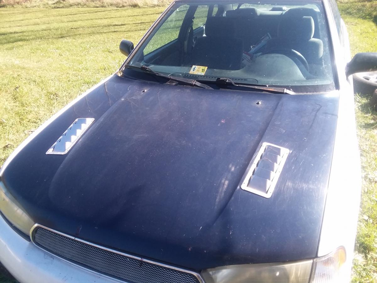

Subieguy165 Posted November 28, 2017 Author Share Posted November 28, 2017 Made some changes from y'alls input and had some vents laying around and thought I'd use them Link to comment Share on other sites More sharing options...
