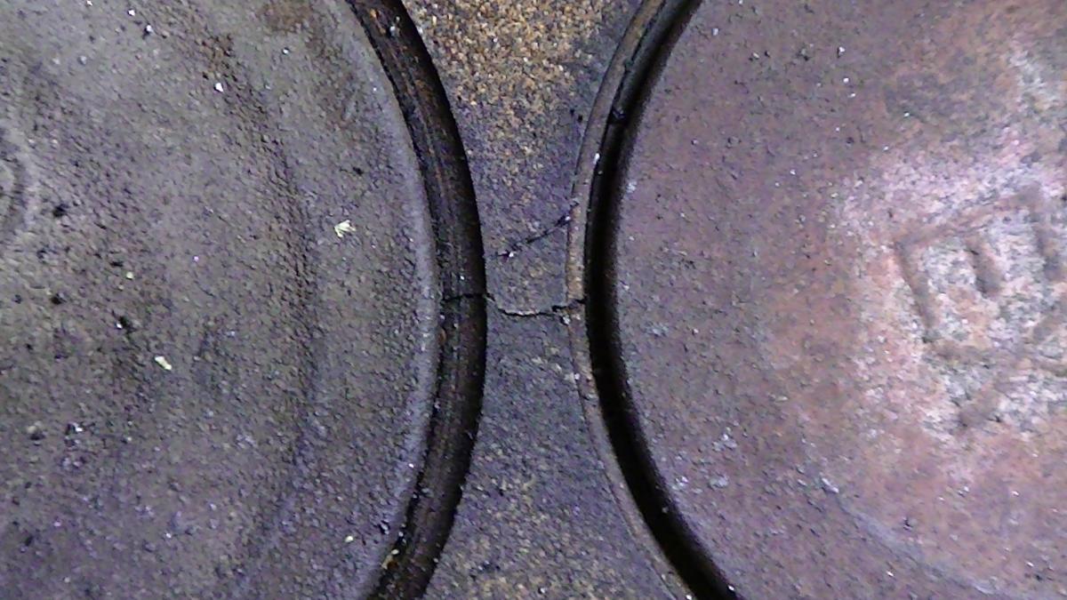

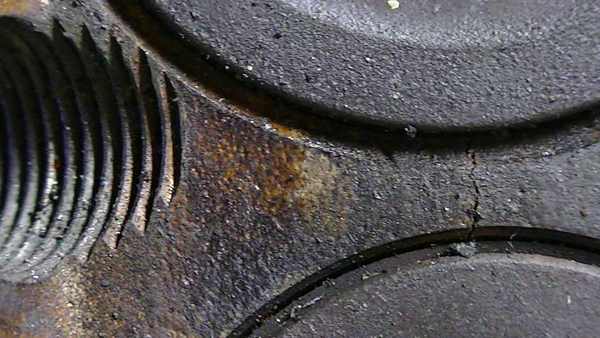

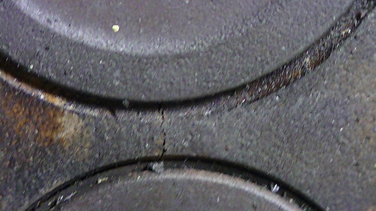

somick Posted November 21, 2017 Author Share Posted November 21, 2017 Your first count said three valves leaked, yet none of the exhaust did. Wondered how many valves you had on one head! You know, from past experiences with ea82 heads don't take short cuts. You put so much into rebuilding it and installing it , no fun finding cheapskate genes caused more headaches for you. Any visible cracks between valves combustion chamber side? You had a coolant leak....where, how? The valves leak under that test just means you had an extra problem about to happen. I always use petrol with a little oil coz think it is thinner than water and when petrol dries leaves oily residue about. Thanks jono!!! This is the post I have been looking for! The surface between valves CRACKED. See attached pictures. Now I do not know if it is worth to proceed withe the repair. What do you think? To answer your another question: the coolant was pushing back into the radiator when I started investigating a slight overheating. I decided that that was a blown head gasket and removed the heads but could not see any obvious signs of blown gasket. Thanks again, Sam Link to comment Share on other sites More sharing options...
DaveT Posted November 21, 2017 Share Posted November 21, 2017 There was a TSB years ago about small cracks between the valves. They are not a problem. Nearly every head I've had off an ea82 has them. I've not had any problem caused by those small cracks. I've read about people trying to fix them, they come back. The coolant pushing out of the radiator and overheating is typical of failed headgaskets. It is not always visible. It only takes a very tiNY pinhole of a leak to let gasses at hundreds of psi to leak into the cooling system. Link to comment Share on other sites More sharing options...
jono Posted November 21, 2017 Share Posted November 21, 2017 Now you mention cracks! I have had a set weld repaired that failed again years later. Two tests are cheap easy vacuum test once valves been sealed ground lapped etc then there is the pressure test costs more but is more definitive that I recommend for more piece of mind. Like many others have used heads with harmless cracks A sealing product called seal wel uep one L also worked wonders Link to comment Share on other sites More sharing options...
idosubaru Posted November 22, 2017 Share Posted November 22, 2017 They isuakku have those cracks. Benign. If the car was significantly overheated and limped along forever then they could crack into the water jacket. Otherwise on a normal head they’re so commend one doesn’t ewakky even worry about to Link to comment Share on other sites More sharing options...
somick Posted November 22, 2017 Author Share Posted November 22, 2017 Now you mention cracks! I have had a set weld repaired that failed again years later. Two tests are cheap easy vacuum test once valves been sealed ground lapped etc then there is the pressure test costs more but is more definitive that I recommend for more piece of mind. Like many others have used heads with harmless cracks A sealing product called seal wel uep one L also worked wonders Thanks jono. When I finish working on the heads I will stop at the local garage and find out how much it will be. Sam Link to comment Share on other sites More sharing options...
