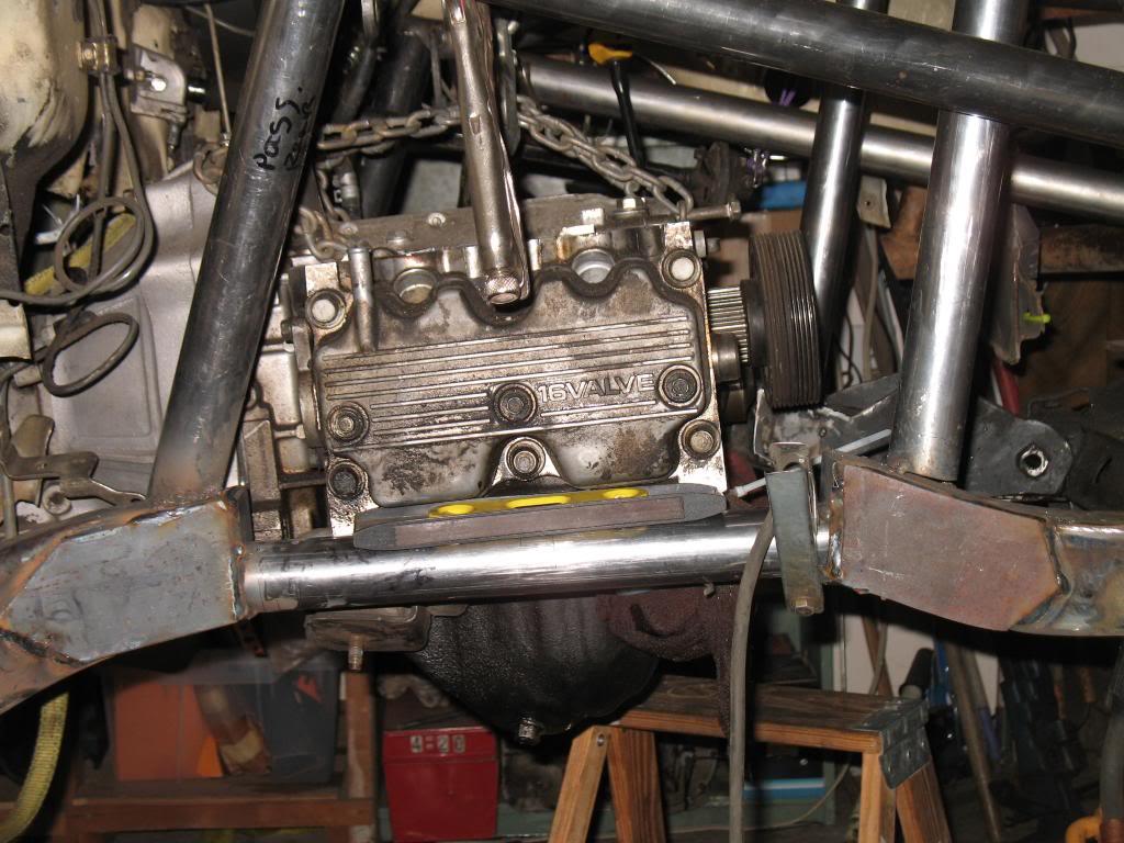

Numbchux Posted December 4, 2017 Share Posted December 4, 2017 (edited) What engine are you using? With either transmission, the transfer gears in the back of the transmission will be the weak link, as they're not designed to carry full power. The extra gearing of the transfer case and axles will help that, but if you're making more than EA power, that may be an issue. If it's an EJ, those transfer gears are very easy to source, and even upgrade. Here's a thread that might interest you. Subaru engine in a Toyota, not finished, but some good information: http://www.ultimatesubaru.org/forum/topic/134618-smiley/ The important part, what he had to do to the Toyota frame to get the Subaru engine to sort of fit. This is an Early SOHC EJ22, the smallest EJ engine: And that's after completely removing the transmission tunnel to raise the drivetrain up into the body as much as possible. If I were building something like that, I would definitely use one of Bill's adapter bellhousings to use a Toyota transmission. Stronger, and without the front diff in the transmission, it won't require the engine/transmission to be nearly as far from the front diff. Which means better ground clearance and/or lower COG, depending how you build it. Another thread that might interest you. Toyota Axles under a Brat. Not the whole frame...but still. Link to pictures in the last post. http://www.ultimatesubaru.org/forum/topic/89301-82-brat-solid-axle-build-done/ Edited December 4, 2017 by Numbchux Link to comment Share on other sites More sharing options...

sumoco Posted December 5, 2017 Author Share Posted December 5, 2017 (edited) Ej22 with a 5 speed d/r currently. I know the welded center diff on an ej22 trans isn't the best but it's very available if and when it breaks. Plus I want real suspension. I've read through that thread a few times, he's using the Toyota body as well so I feel like it would be a little bit of a different fit? Edited December 5, 2017 by sumoco Link to comment Share on other sites More sharing options...
