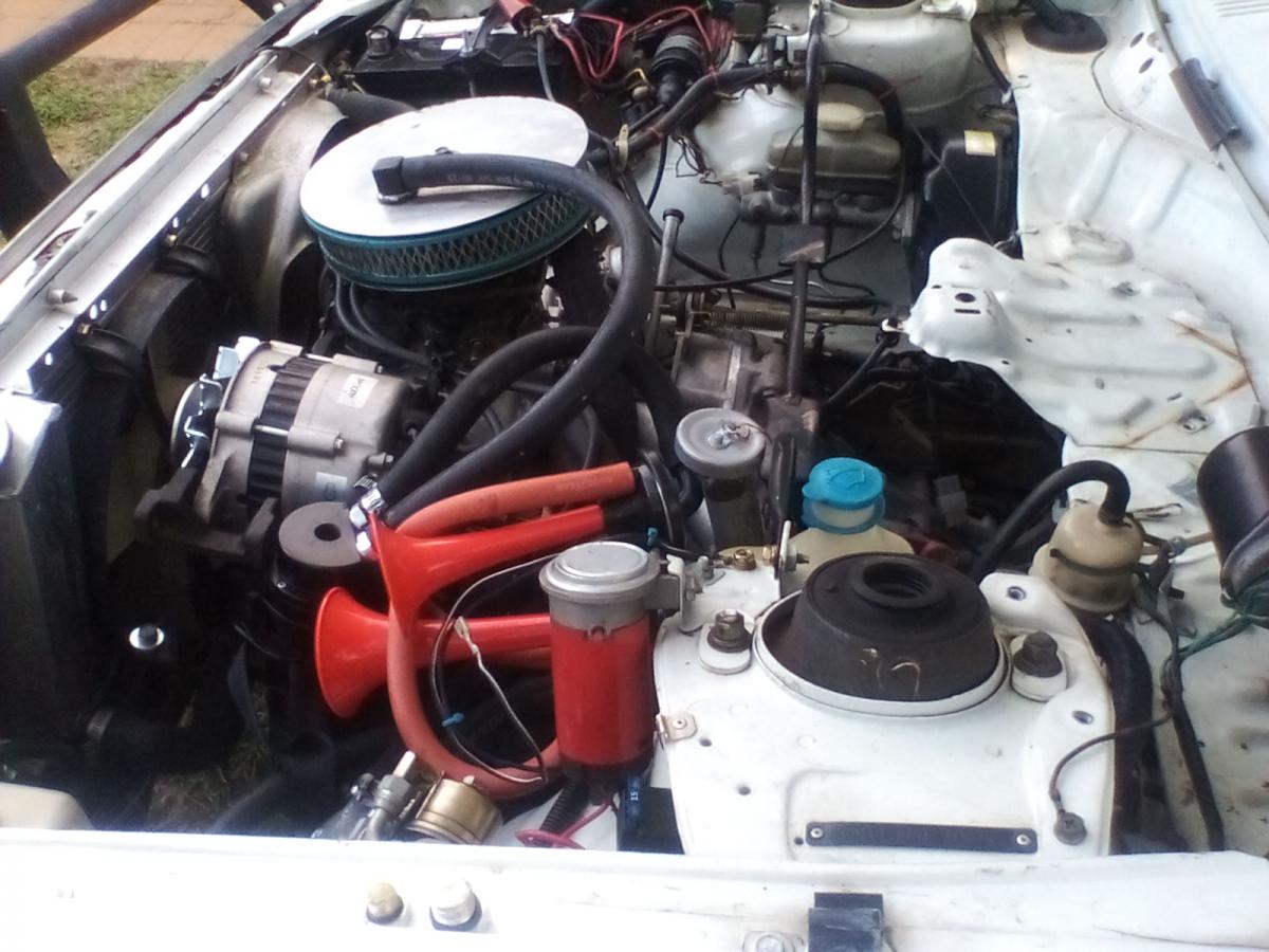

jono Posted December 6, 2017 Share Posted December 6, 2017 Got not oil in water Got no water in oil 120,000km since rebore rebuild Never over heated but worked hard Catch can off lhs rocker fills up with buttermilk about 700 ml when full. Bit puzzled Any ideas, corrosion somewhere? Slight Welch plug? But are brass Link to comment Share on other sites More sharing options...

jono Posted December 7, 2017 Author Share Posted December 7, 2017 (edited) Um, no one drive , ah ha... you guys don't do roundabouts like we do - clockwise! Its all modified so no petroleum carburetor, no factory air box, has an exposed air filter element with rebreather on top plate if air filter above an Impco propane carby As a precaution to prevent any oil dropping in on air filter element, and because I had the canister kicking about chucked it on Just as well as it has caught the crap, it has served its purpose. Blow by does not produce steam to mix with oil to make buttermilk Normally if a mild steel ferrous metal Welch plug was in it to rust out I would understand and expect water in my oil I am gonna have to do a comp test for starters. It was starting to lose water but first thought it was from its cheap nasty eBay radiator Edited December 7, 2017 by jono Link to comment Share on other sites More sharing options...

jono Posted December 9, 2017 Author Share Posted December 9, 2017 Not normal for me. Sorry GD, my fault for not hexplaining how different this one is. Catch can is black, cylindrical strapped to all AC bracket feeds to top of air filter. RHS is alone with one way valve and bare filter Link to comment Share on other sites More sharing options...
