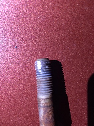

mkoch Posted December 19, 2017 Share Posted December 19, 2017 Here is a photo of an exhaust manifold stud which I removed. There is aluminum stuck to about five turns of the thread, at the end. What should I replace the studs with? The pitch is m10 1.25. Should I tap the holes at 1.25, or drill them out and go larger? Mkoch Link to comment Share on other sites More sharing options...

DaveT Posted December 19, 2017 Share Posted December 19, 2017 That much aluminum on the threads, probably stripped, not enough to nothing left to hold. I have used heli coils several times, no problem for this. Link to comment Share on other sites More sharing options...
mkoch Posted December 19, 2017 Author Share Posted December 19, 2017 Here is the image! Link to comment Share on other sites More sharing options...
