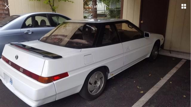

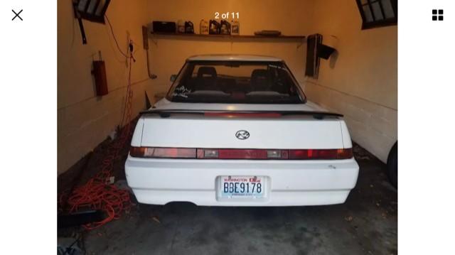

subarubrat Posted December 25, 2017 Author Share Posted December 25, 2017 (edited) The first two are the XT I bought as it sits now, a super clean body! This is a pic of the test mule that Subaru used for the EG33 development. I am looking for any info on those front fenders! They could have been one-offs done in house or sourced from who knows where. Their solution for the rear is functional but ugly, and wouldn't be near wide enough for my needs. Edited December 25, 2017 by subarubrat Link to comment Share on other sites More sharing options...

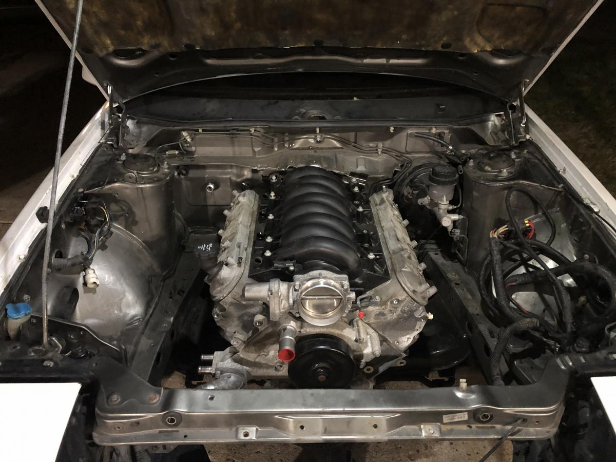

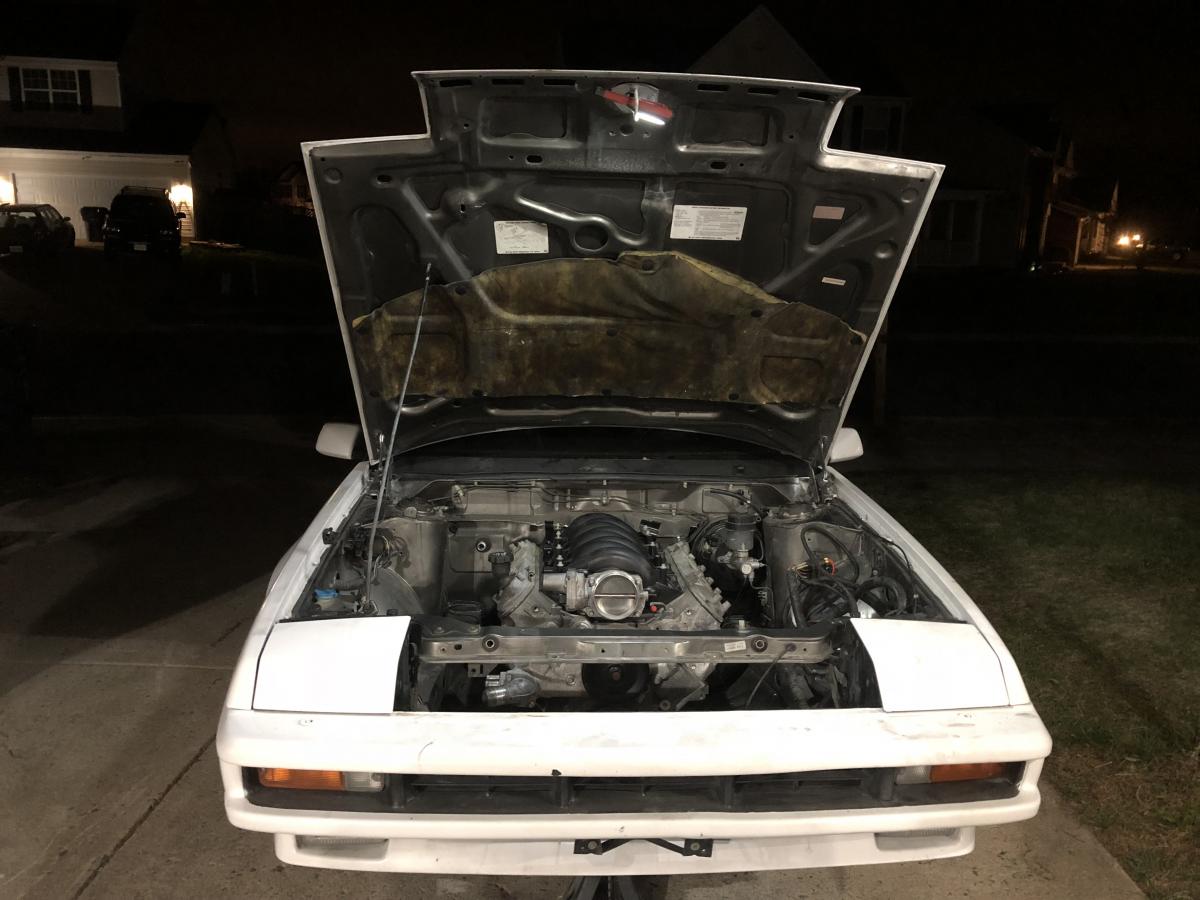

subarubrat Posted April 7, 2018 Author Share Posted April 7, 2018 The engine is in! It is far from complete and the big work lies ahead but it is a huge step. The front cross member had to be notched about 2 inches and the oil pan pretty much matches the contour of the bottom of the cross member. I am linking the two halves together and connecting the cross member to the firewall and front radiator support to stiffen the front end for the increased power. The bottom of the oil pan is the same as the frame rails so no problem there, the motor mounts, headers, and intake all clear and the hood closes nicely with over an inch of clearance to the hood fire blanket. The trans tunnel will need to be enlarged and that is next, then once the trans is in I will tackle the rear end suspension and driveline. Link to comment Share on other sites More sharing options...

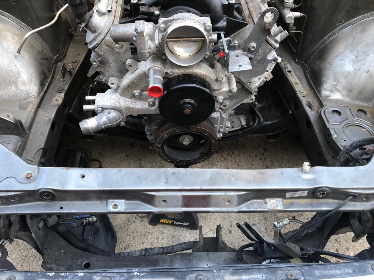

subarubrat Posted April 7, 2018 Author Share Posted April 7, 2018 A bit closer look. 1 Link to comment Share on other sites More sharing options...
subarubrat Posted April 7, 2018 Author Share Posted April 7, 2018 Plenty of room up front for the superchargers, intercooler, radiator and oil cooler! 1 Link to comment Share on other sites More sharing options...
