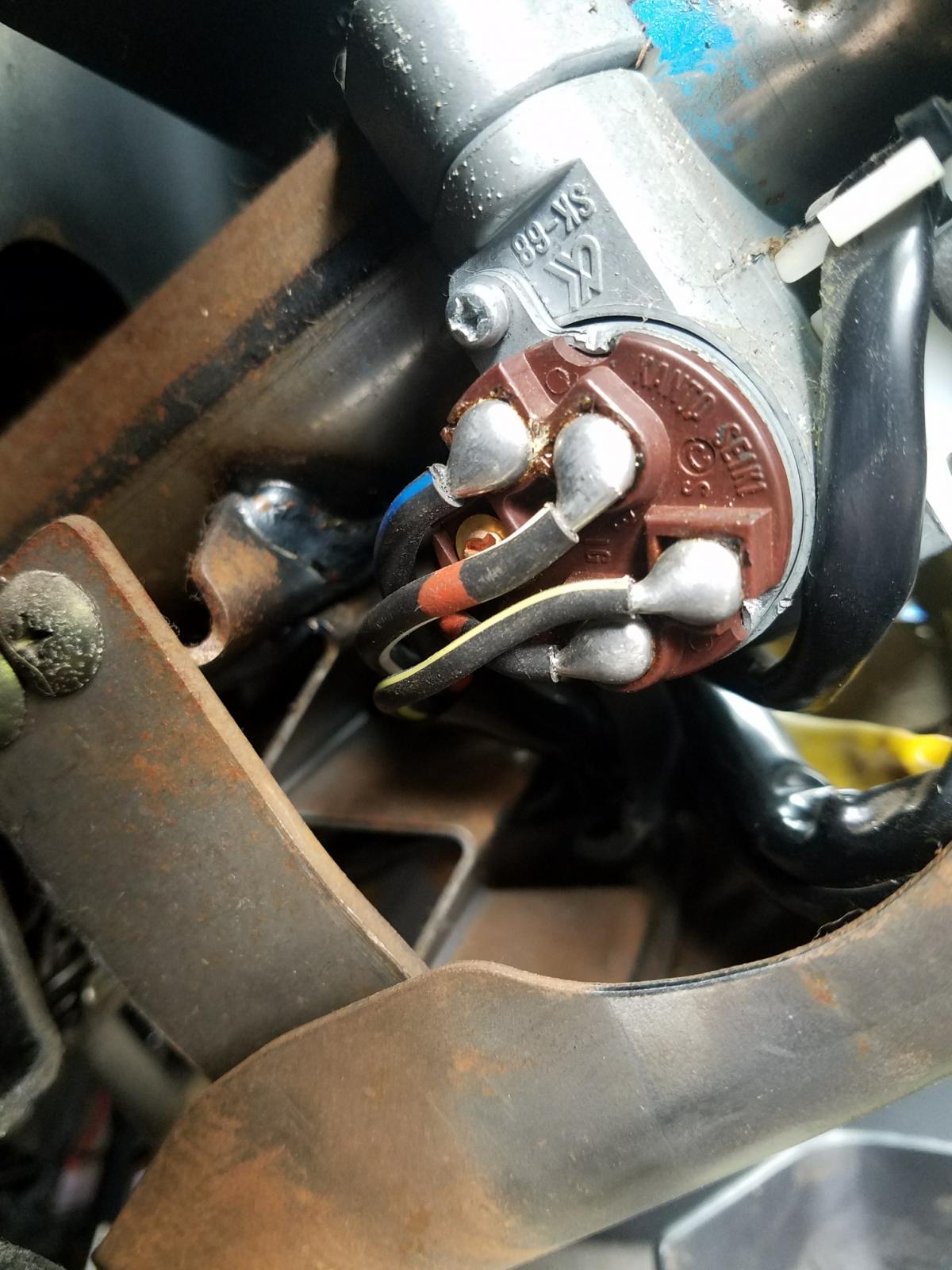

koolminx Posted January 6, 2018 Author Share Posted January 6, 2018 I took a picture of the four wire ignition switch and it's too big to upload to this damn site so I'm frustrated I have 4 wires the power feed wire and 3 others. The power feed wire is black with a white stripe. Key on power is the bottom wire and the top wire the top wires black with a blue stripe and while cranking all of them light up except the black one with the blue stripe which stops lighting up when I start cranking is that the one that needs power? Link to comment Share on other sites More sharing options...

koolminx Posted January 6, 2018 Author Share Posted January 6, 2018 On 1/4/2018 at 1:15 AM, GeneralDisorder said: My bet is on the ECU being faulty. Open it and check for any moisture. I've seen a number of them die and it's almost always the injector driver's that give out. GD Hey general, went over ECu with magnifying glass and reading glasses, it is in fantastic condition and no signs of even dust ever being on it.... I'm trying to upload a picture and a video, someone said I should have a 5 wire ign switch but it's only 4 with a 4 pin plug, and I took a short 5 second video of the cranking and release where the ground pulse to the injector causes the noid flash only after the key is released... Link to comment Share on other sites More sharing options...
koolminx Posted January 6, 2018 Author Share Posted January 6, 2018 Ignition switch.. Any suggestions on where to host a 4 second video in MP4 format so you all can see it? Link to comment Share on other sites More sharing options...

GeneralDisorder Posted January 7, 2018 Share Posted January 7, 2018 (edited) Yeah I still think you need to try jumpering the ignition switch circuit so that it is sending power to the hot in start/run circuit all the time then try cranking it. Also sometimes with these ignition switches.... turn it very slowly till it just barely touches the start contacts. Don't push hard on it, and it might work. The connector pinout is in the FSM you can download from sl-i.net.... GD Edited January 7, 2018 by GeneralDisorder Link to comment Share on other sites More sharing options...
