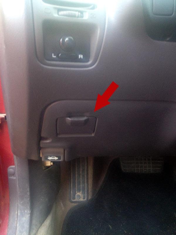

heartless Posted February 5, 2018 Share Posted February 5, 2018 the little door you are looking for is located here... Link to comment Share on other sites More sharing options...
