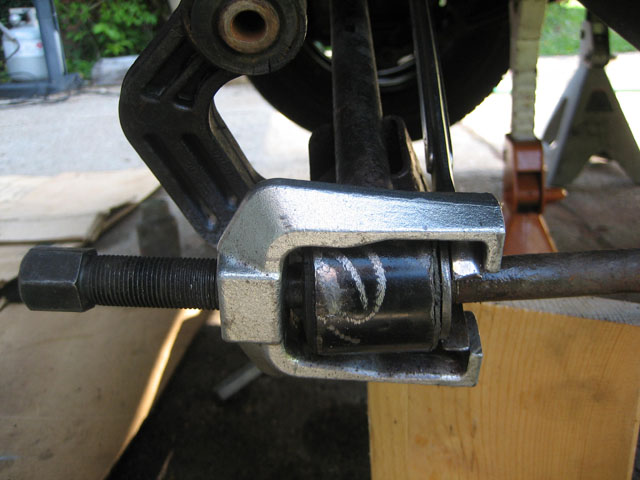

uniberp Posted March 2, 2018 Share Posted March 2, 2018 Oh in Maine we just call it the BAB -- BigArseBolt Here's how you extract the longbolt. Sorry, but you have to cut the head off, and the bolt is a special manufacturer's size, but I think I paid $16. 1. remove strut pinch-bolts, caliper, axle nut, etc. 2. Remove the nut from the "longbolt". 3. HAMMER the longbolt out of the FRONT arm and knuckle. 4. At this point you are kinda stuck, if the bolt is rusted to the inner bushing of the rear arm, and no amount of twisting or hammering will free it. 5. One way is to remove the entire arm, but that inner suspension bolt may be rusted even more badly, and the longbolt is still stuck in the arm. 5a. There just is no way to get between the bushing end and the bolt head. 6. Cut off the bolt head. Sawzall. 7. With that arrangement shown, a washer that just fits the bolt, an open end wrench, and a pitman arm puller. 8. This method saves the rubber bushing. With a new bolt you can just bolt it up and go. 9. Cutting the head off a hardened 16mm(?) bolt takes some doing. Sawzall 10 minutes, or a couple cutoff wheels and that nast smell. 10. It is not pretty, but it is done. Link to comment Share on other sites More sharing options...
987687 Posted March 2, 2018 Share Posted March 2, 2018 Here's how you extract the longbolt. Sorry, but you have to cut the head off, and the bolt is a special manufacturer's size, but I think I paid $16. 1. remove strut pinch-bolts, caliper, axle nut, etc. 2. Remove the nut from the "longbolt". 3. HAMMER the longbolt out of the FRONT arm and knuckle. 4. At this point you are kinda stuck, if the bolt is rusted to the inner bushing of the rear arm, and no amount of twisting or hammering will free it. 5. One way is to remove the entire arm, but that inner suspension bolt may be rusted even more badly, and the longbolt is still stuck in the arm. 5a. There just is no way to get between the bushing end and the bolt head. 6. Cut off the bolt head. Sawzall. 7. With that arrangement shown, a washer that just fits the bolt, an open end wrench, and a pitman arm puller. 8. This method saves the rubber bushing. With a new bolt you can just bolt it up and go. 9. Cutting the head off a hardened 16mm(?) bolt takes some doing. Sawzall 10 minutes, or a couple cutoff wheels and that nast smell. 10. It is not pretty, but it is done. Oh getting it out of the bushing isn't a big deal, worst case you just replace the bushing. The hard part is removing it from the knuckle since a long section is exposed and rusts up. I've literally had them so rusty you couldn't tell the difference between the bolt and the knuckle. The position that picture shows is 99% done. When they won't come out of the knuckle you have to needle scale them as clean as possible, then heat stuff red hot with a torch and assault it with a BFH, being careful not to bend the now superheated knuckle. Link to comment Share on other sites More sharing options...
