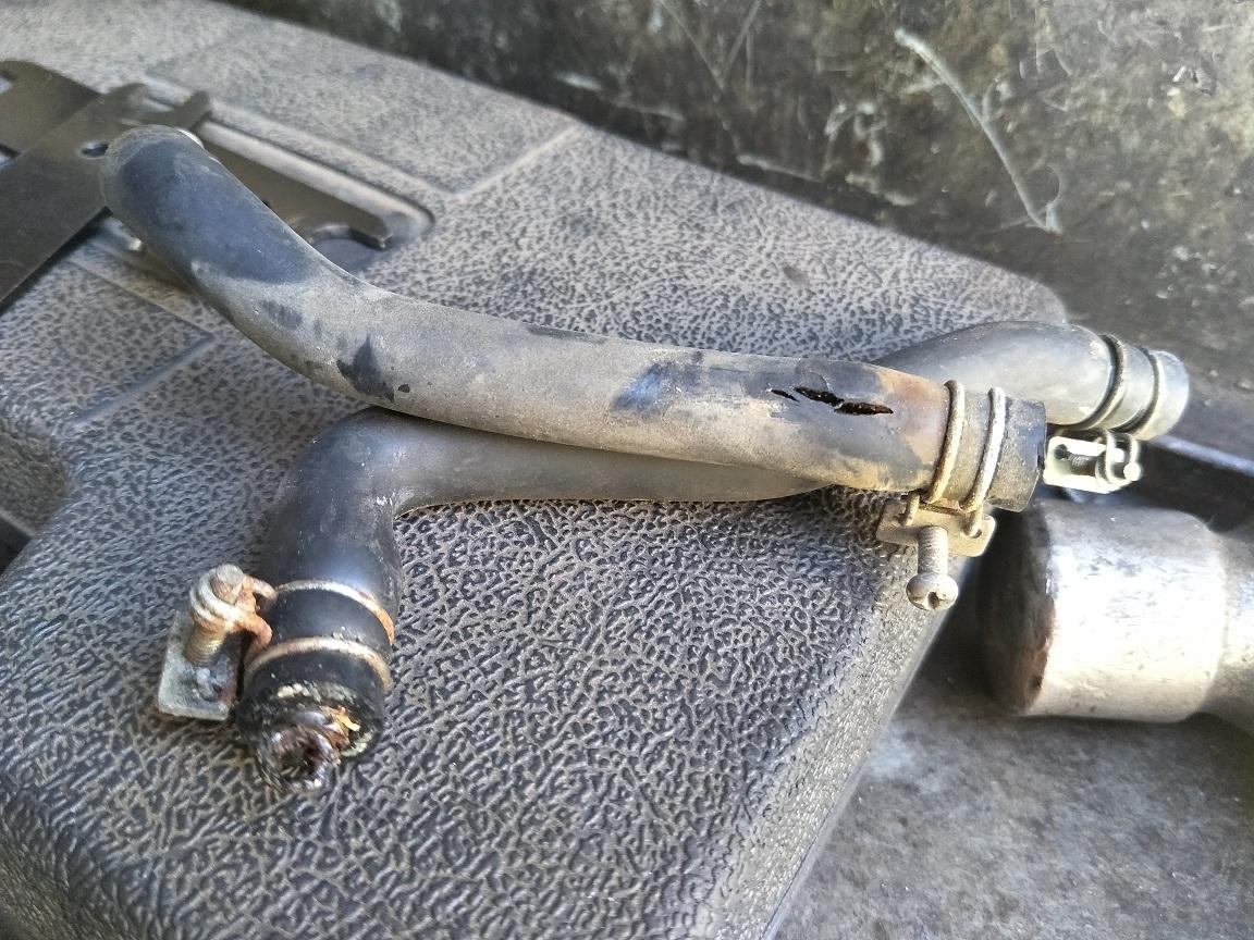

el_freddo Posted February 6, 2018 Share Posted February 6, 2018 (edited) Neat looking Tex! Not many of them getting around anymore A guy on Ausubaru is doing one up atm. You’ll need a compatible version of internet explorer or Firefox to access that forum atm The leak you describe will most likely be the heater circuit pipe over the top of the engine block, or the connecting heater hose above the water pump (hidden under the AC compressor and bracket). This little hose is often missed when general maintenance is carried out on the cooling system. Being that it sat for a number of years without coolant in the block I’d be giving it a good flash of the system, replace all radiator and heater hoses including the two annoying little ones between the block and intake manifold and the manifold and heater circuit crossover pipe. You could expect the heater circuit crossover pipe to be corroded to all buggery and could be the source of your leak too, any EA82 heater crossover pipe will do the job. I’d replace the water pump, radiator and even look into replacing the heater core as it has plastic end tanks (genius idea Subaru!) and typically let go near the 300k km mark. I did two in my L series and it’s not fun! All brass copper units are available and worth the coin for piece of mind. If doing this work be careful not to crack the instrument cluster surround as they’re rarer than hens teeth on rocking horse crap! And pull the steering wheel and drop the column to avoid cracking the windscreen (been there, done that - rookie mistake). Be aware that the headgaskets could be weak now too, after all the above work is done you may find yourself tearing back into it to replace the pesky headgaskets... Keep up the good work and the door wedge love! There’s not many around and good examples will be harder to come by as time goes on. Lastly, get it out of the weather! Even with a car cover you’ll toast the clear coat. Do not ever cut and polish this vehicle as you’ll only be stripping the clear coat. If you want to see what crap clear coat in that Subaru blue looks like I’m more than happy to post a pic of my L’s paint Also ensure the drain pipes in the sunroof are not blocked. Very common for them to rust out here due to a blockage or partial blockage. Maybe one day you can make it to the annual Hunter Valley Cruise in May. I’m keen but haven’t managed to get there yet! Also checkout Subyclub, another Oz based forum They’re mainly into their newer Subaru’s but love hearing about old skool builds such as this And done Cheers Bennie Ps: any engine bay pics? I’m wondering if it’s got a spider manifold and flat ribbed belts. I think the spider manifold came later though. Edited February 6, 2018 by el_freddo 1 Link to comment Share on other sites More sharing options...

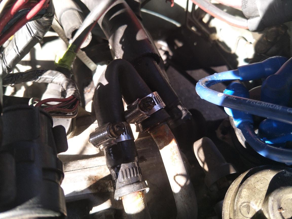

Drano Posted February 9, 2018 Author Share Posted February 9, 2018 Thanks for all that info, el_freddo. Monday morning my mechanic is going to check it out, so I'll know more by the arvo. I don't think it's been sitting for much more than 2 months, as it was registered until mid-January and the owners said it had sprung a leak in December. So hopefully that's a plus, over something that's been sitting for years. I've had a closer look at the engine after your advice, and I can see that (I think) the heater core to the dash has been disconnected at some stage - there are two pipes going into the car that are not connected, and two coming out of the engine that are connected with a u-turn short piece of hose. I think you can see it, up the top of the attached photo. The previous owner mentioned that the heater doesn't work - but here in Queensland it's rarely cold enough to need one. The aircon apparently works very well - and that is essential for me! Thanks again for all the help on this site. Link to comment Share on other sites More sharing options...

Drano Posted February 13, 2018 Author Share Posted February 13, 2018 (edited) Well the Vortex is purring again, after a (stinking hot) day of work by my mechanic at home. I 'supervised'.. The coolant leak was from the throttle body, with one heater pipe split and another crusted and rusted upon removal (see pic). I think that's what you predicted, el_freddo? My mechanic bypassed it - he said it's not cold enough in Qld to worry about it. Then some spark plug jiggering got all 4 cylinders happy (was only running on 2 initially). New fluids and filters, and an engine wash. New bit of pipe to join up the heater core pipes (see 2nd pic). Air conditioning does work a treat - it eventually went from the 'windscreen' down to 'face' fan setting after a bit of pressing the buttons. Just got to fix a muffler hole, and get some new tyres, then I'll try to get it registered! Edited February 13, 2018 by Drano 1 Link to comment Share on other sites More sharing options...

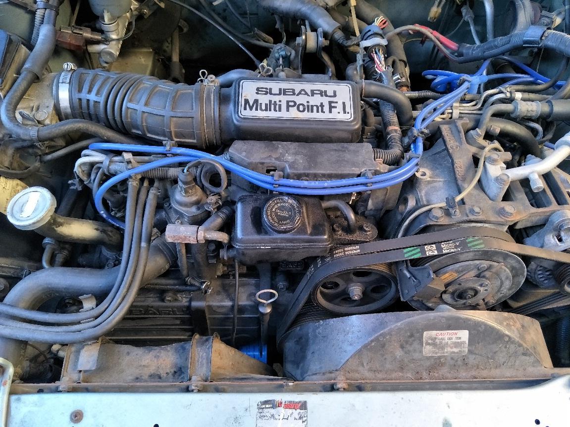

Drano Posted September 7, 2018 Author Share Posted September 7, 2018 Hi everyone.. An update on my Aussie XT (Vortex): it's been registered and on the road for half a year now, after some body work (rust around boot/trunk, respray to bumper).. and bypasses to hidden heater hoses to stop another coolant leak (as suggested by el_Freddo). At one stage It started running a little rough, but I found that whatever the issue was (injectors?) passed after some 'determined' driving to car shows etc. Just using it, basically. After quite a while out of the dashboard, the original radio has been fixed (some dry joints re-soldered I believe).. but the passenger side electric window isn't working. I'll take off the door card again and check out the roller. Plus, some time soon I will replace the front and rear shocks (got to save up for that!). Then it's new velour & padding for the front seats.. 1 Link to comment Share on other sites More sharing options...
el_freddo Posted September 9, 2018 Share Posted September 9, 2018 She looks sweet as mate! Have you gone for a cruise with the roof top removed? They used to have a bag to store it safely in the boot from memory. There may be some tie down straps in the boot too. Keep the pics coming when you can and look after that beast! (can we get an engine bay pic please?) Cheers Bennie Link to comment Share on other sites More sharing options...
