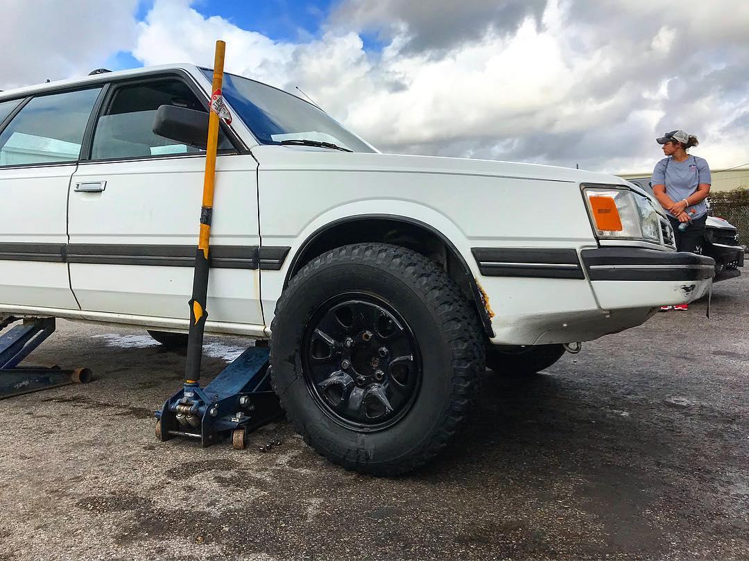

GLoryHoles Posted February 6, 2018 Share Posted February 6, 2018 (edited) Hey guys, been having some issues pinpointing why my Fuel injected 1.8 wont start. She was my daily and i parked her after getting home from work and the next mornig i was getting a dry crank. getting fuel getting power to the coil but not out to the distributor. And the air filter is brand new (also cleaned the air sensor). Bought two brand new coils and both had the same issue (power in but no power out even while cranking). Ive heard to check the ECM or the coil. Any recommendations? Thanks in advance. pic of my poor baby :/ Edited February 6, 2018 by GLoryHoles Link to comment Share on other sites More sharing options...
