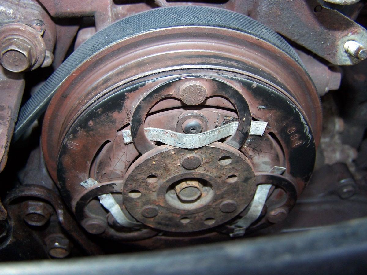

Ah yes two things I should have done.  First put a test light on the clutch power wire, well and then I wouldn't really have had to ask here, but if so I should have done a search.  Not to mention I had another car 20 years ago that had the same problem, but it wasn't this easy to fix.
Anyway it was the clutch and I have a 15 minute fix!  May look a little funny but seems to be working great.  And no I can't see these shims falling out.  Actually after this picture I bent the two ends over on each of the three so they can't slide out.  The metal I used was about .025" thick and very soft so I could bend it as I threaded it through.
If you remove the 10mm nut, the cover slides off and you can remove one of the spacer washers to accomplish the same thing with no modifications required.

Oh!!!  I thought I read that you need to pull the whole clutch with a special puller.  Maybe someday when I have nothing to do I'll do it right.  I did one on a F*rd once but don't remember how it came apart.
