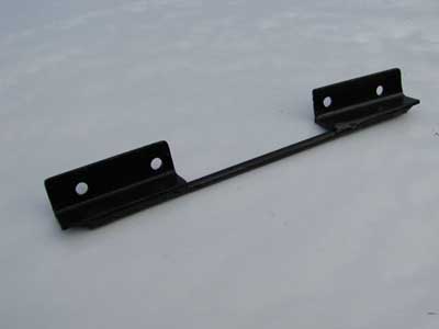

Craven Posted June 28, 2004 Share Posted June 28, 2004 I built this for my 86 Brat. Link to comment Share on other sites More sharing options...

Craven Posted June 28, 2004 Share Posted June 28, 2004 so, youre just going flush with the floor...... welding tomorrow The driveshaft is in the tunnel, stock location. Link to comment Share on other sites More sharing options...

Craven Posted June 28, 2004 Share Posted June 28, 2004 After looking a Qman's and building mine, I have a question. Why didn't Subaru build the mounting tabs strait like most carrier bearings I seen and changed on trucks and such? Instead of the strange angles that thay are at. Hell I thought mine was bent or something. Link to comment Share on other sites More sharing options...
