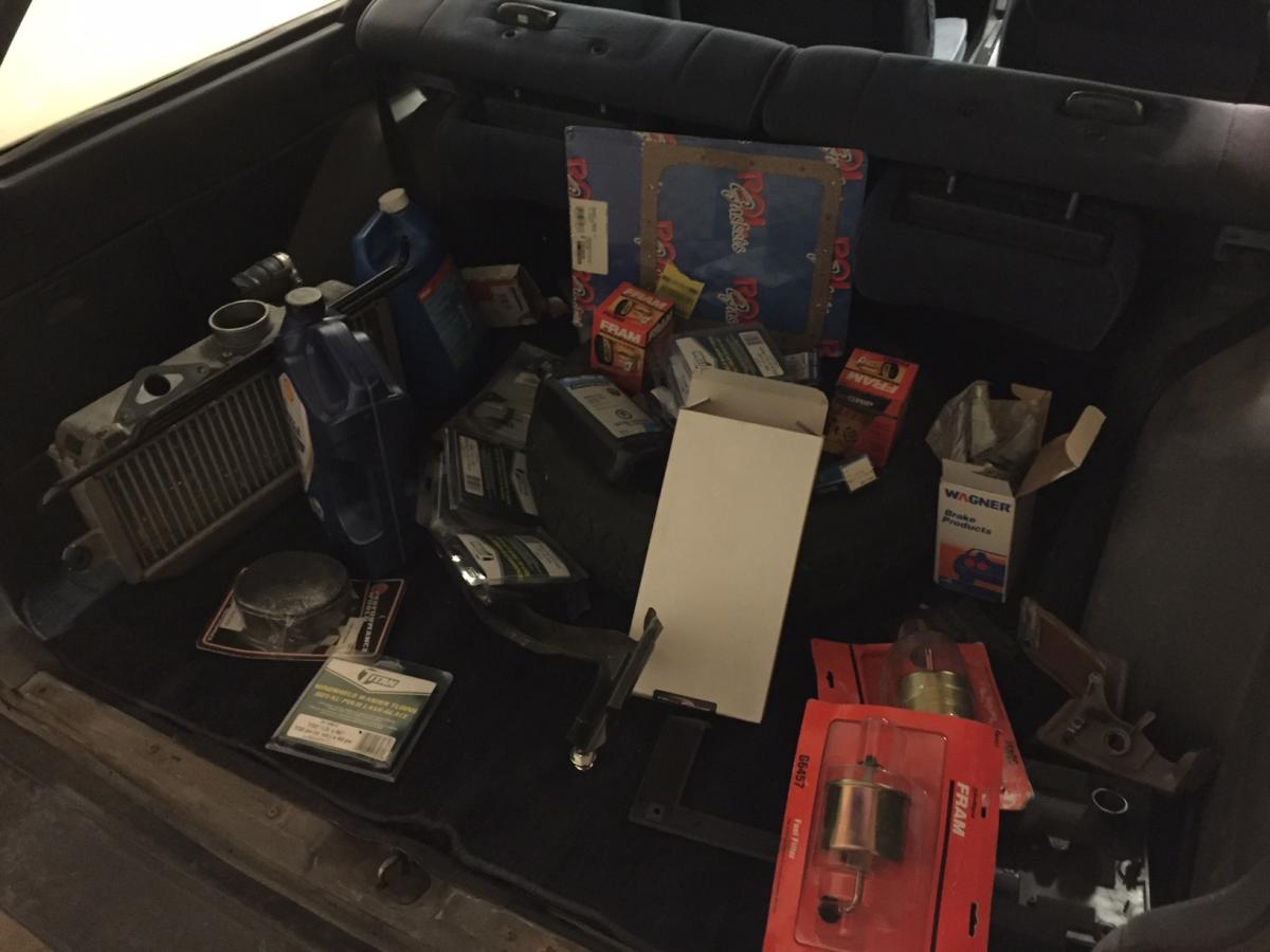

User-Matt Posted March 25, 2018 Author Share Posted March 25, 2018 In the pile of parts; - Oil, coolant, break fluid and power steering fluid - Oil filters x3 - Fuel filters x2 - Heat tape - used most of it on down pipe - Oil pan gasket - currently leaking like a sieve - water pump gasket - thermostat - cap and rotor - installed - Spark plugs and wires - installed - several packages of vacuum line - gonna be fun tracking down all the lines to be replaced - front and rear break lines - Current ones look ok but gonna replace anyhow to be safe - left and right marker light lenses - WRX intercooler - looks to me like way too much capacity for that little turbo, gonna look for a smaller one at the junker and sell this one to boost back up the budget. Unless you all feel different about the capacity I just don't wanna add a bunch of turbo lag? Link to comment Share on other sites More sharing options...

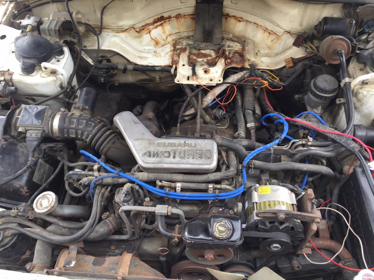

User-Matt Posted March 25, 2018 Author Share Posted March 25, 2018 (edited) Going to clean the MAF and the downstream mesh is trashed so going to try to replace it or just delete it if it ends up being too much of a pain. I'm ditching the air box and installing a cone filter (found brand new K&N cone for $20 on KIJIJI), Appreciate the comments IDOSUBRU and DEE2, gonna try to take care of all the suggestions you mentioned. Edited March 25, 2018 by User-Matt Link to comment Share on other sites More sharing options...
skishop69 Posted March 26, 2018 Share Posted March 26, 2018 (edited) That intercooler is too big and it's going to cause lag in the boost. I personally wouldn't add it since you are running a race, That being said, if you're willing to keep it at 4000-6000 rpm the whole time, it should work ok. Also, if it has the mechanical fan, I would ditch it and grab another electric fan off another Subie and hard wire it on a switch running all the time the engine is. Put it next to the one that's already there. Edited March 26, 2018 by skishop69 1 Link to comment Share on other sites More sharing options...
carfreak85 Posted March 26, 2018 Share Posted March 26, 2018 Keep the original air box and DO NOT install the cone filter. You will lose horsepower by having the engine draw in hot, underhood air. I don't think the WRX IC is too big, but properly fitting and plumbing it will be outside your budget, potentially. A DIY manual boost controller set to about 10 psi could be fun, along with a RRAFPR. 1 Link to comment Share on other sites More sharing options...
Gloyale Posted March 26, 2018 Share Posted March 26, 2018 Keep the original air box and DO NOT install the cone filter. You will lose horsepower by having the engine draw in hot, underhood air. I don't think the WRX IC is too big, but properly fitting and plumbing it will be outside your budget, potentially. A DIY manual boost controller set to about 10 psi could be fun, along with a RRAFPR. +1 Link to comment Share on other sites More sharing options...
User-Matt Posted March 26, 2018 Author Share Posted March 26, 2018 Awesome thanks for the tips guys. That intercooler is too big and it's going to cause lag in the boost. I personally wouldn't add it since you are running a race, That being said, if you're willing to keep it at 4000-6000 rpm the whole time, it should work ok. Also, if it has the mechanical fan, I would ditch it and grab another electric fan off another Subie and hard wire it on a switch running all the time the engine is. Put it next to the one that's already there. As for the electrical fan, this unit had A/C but it was deleted by the previous owner, however the electric fan for the A/C is still there, so bonus just need to wire it to run when the car is on. Keep the original air box and DO NOT install the cone filter. You will lose horsepower by having the engine draw in hot, underhood air. I don't think the WRX IC is too big, but properly fitting and plumbing it will be outside your budget, potentially. A DIY manual boost controller set to about 10 psi could be fun, along with a RRAFPR. Good call with the air box, what I might just do instead is make some ram air piping from the underside of the bumper to increase air to filter box. Underside of bumper should be enough of an incline to keep water from migrating up the pipe to the air box if it rains. Also the manual boost controller is definitely on the list. trying to find a reasonably priced used one, otherwise going with a 3 way plumbing valve. I have a boost gauge to monitor the pressure so should keep it safe even if I go with the cheap plumbing option. Loving the ideas everyone!! Link to comment Share on other sites More sharing options...
carfreak85 Posted March 26, 2018 Share Posted March 26, 2018 I seriously wouldn't bother with any kind of intake snorkus. The OEM air box pulls from the passenger's side inner fender, so as long as you have the fender liner installed, it will be pulling cool-ish, dry air. The A/C fan isn't always running, even when the A/C is on. I would be cautious about running that fan at 100% duty cycle for three days straight, especially given its age. It will probably work, but it could fail. Just thought of this: FIRE EXTINGUISHERS IN ALL VEHICLES. Link to comment Share on other sites More sharing options...
