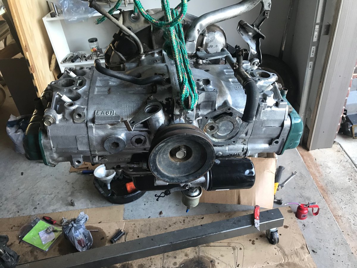

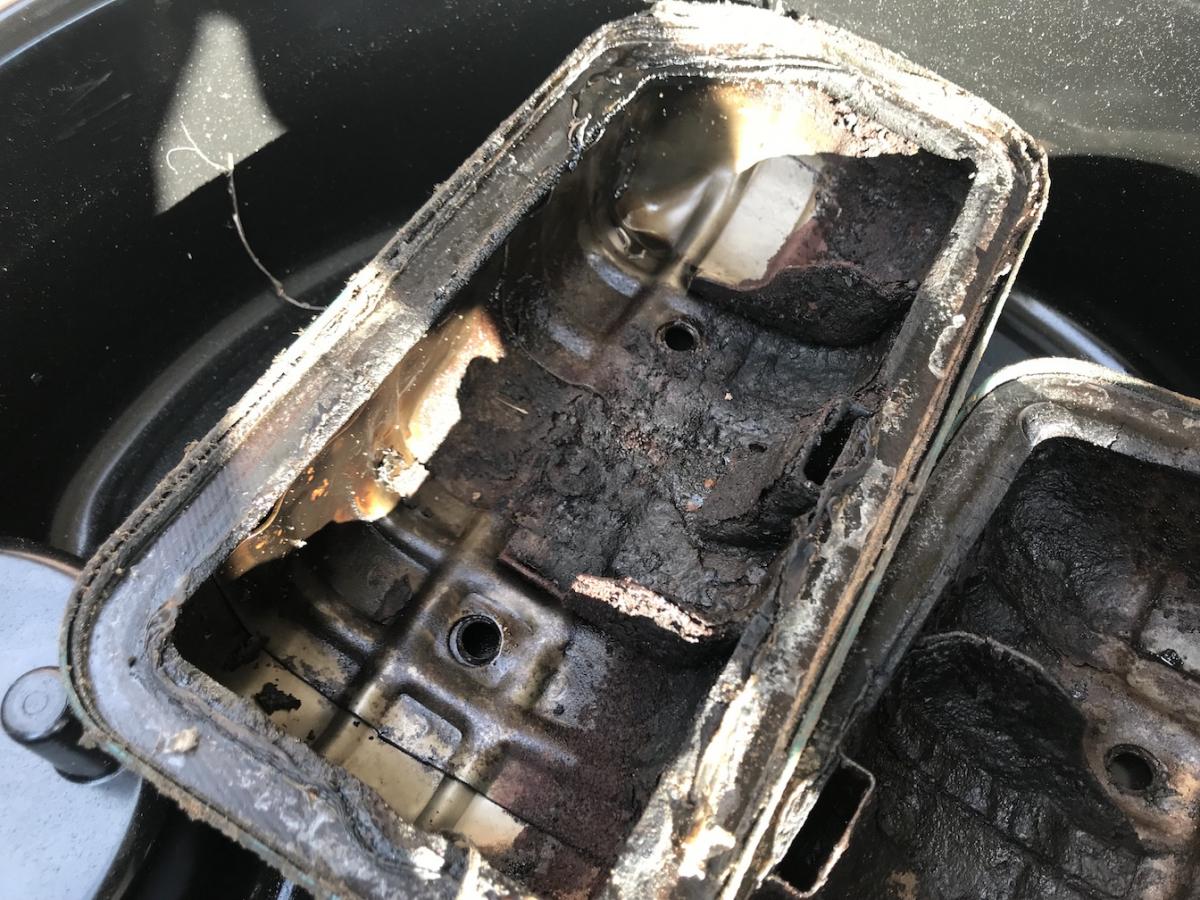

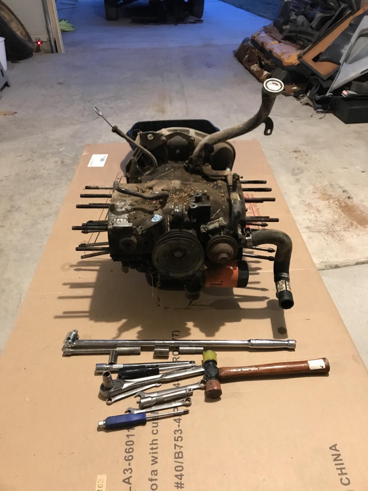

tylertrend Posted April 10, 2018 Share Posted April 10, 2018 (edited) Yesterday I took the manifold, carburetor, and accessories off the engine of my Coupe. I know the engine has been replaced at some point years ago but I'm not sure what the donor vehicle was exactly. To my dismay, I discovered that it has the single barrel C-W factory carb and after baking in the desert for 11 years with fuel in it, I'm sure it needs rebuilt. Yuck. My goal this afternoon was to remove the engine completely as I wanted to give it a good look over and the spark plugs I pulled out the other night didn't look pretty, covered in white crystals and rusty. Now heres the funny part to this story, because there is one. I'm currently in limbo in the middle of a drawn out cross country move so where I am now, the only tools I have is whatever fits in a portable 3 drawer tool box and a breaker bar. And it will be this way for another 2.5 months. So having realized I have no cherrypicker with me, I took the engine apart piece by piece all the way down to the short block, then got some help lifting that whole assembly over the front of the car and onto some cardboard. The pictures attached show the engine pieces and honest to goodness the only tools I used on this whole job. The valve springs were a bit rusty and there is a bunch of sludge in the valvetrain area, but the bores look pretty good, so I'm hoping this shouldn't be too difficult. More to come shortly. Edited December 10, 2019 by tylertrend Link to comment Share on other sites More sharing options...
Subaru Scott Posted April 10, 2018 Share Posted April 10, 2018 Yep, that’s the wonderful thing about the old sobs, you really don’t need many tools to work on them! Hard to tell from the pics, but it looks like you could have a rebuildable base there. If you do decide to go that route, I would replace the rusty valve springs, they have a tendency to break. I would also look for another manifold and Hitachi carb, or Weber 32-36, those Carter-webers were crap. You may want to keep one eye open for a good used engine instead. They are getting harder to find, but it you can, it will be much cheaper than a rebuild. An EA81 that has been cared for and not left to sit and rot, will run great for hundreds of thousands of miles. Link to comment Share on other sites More sharing options...
tylertrend Posted April 10, 2018 Author Share Posted April 10, 2018 The shortblock looks pretty decent so I'd like to rebuild it if at all possible. Good call on the springs. Also discovered that at least several of my push rods are bent, but need to look at that more tonight. I wonder if they will tolerate being straightened and reused? Hmm, time for more internet time. Link to comment Share on other sites More sharing options...

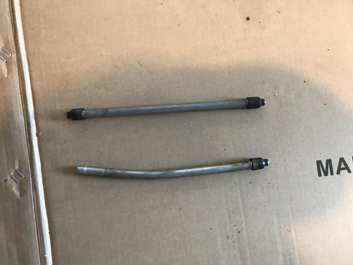

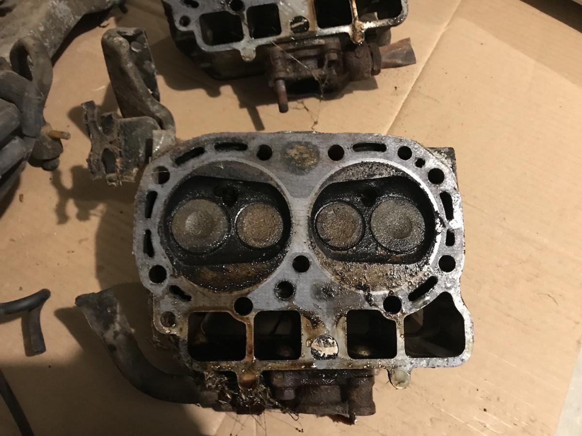

tylertrend Posted April 11, 2018 Author Share Posted April 11, 2018 Got a few small things done today. Removed the flywheel and clutch, no pictures but it was roasted, explains the immense slop in the clutch pedal and a fully tightened down cable. I removed and wiped down all of the pushrods. All 4 on the left are fine, all 4 on the right are bent, some a little, a couple a lot. Explains the symptoms the PO described to the T. Guessing by the look of the sparkplugs and the crystals on the valve heads, I'm wondering if it had a HG or other leak and had an episode of hydrolocking. Oh well, I'll get it fixed right. I'm going to attempt to straighten the pushrods and resuse them. Picture: Right side vs Left side rods. Link to comment Share on other sites More sharing options...
carfreak85 Posted April 11, 2018 Share Posted April 11, 2018 Yup, that's bent... Link to comment Share on other sites More sharing options...
Subaru Scott Posted April 11, 2018 Share Posted April 11, 2018 I’m sure someone on here can get you some pushrods. Aluminum really doesn’t like to bend twice. Link to comment Share on other sites More sharing options...

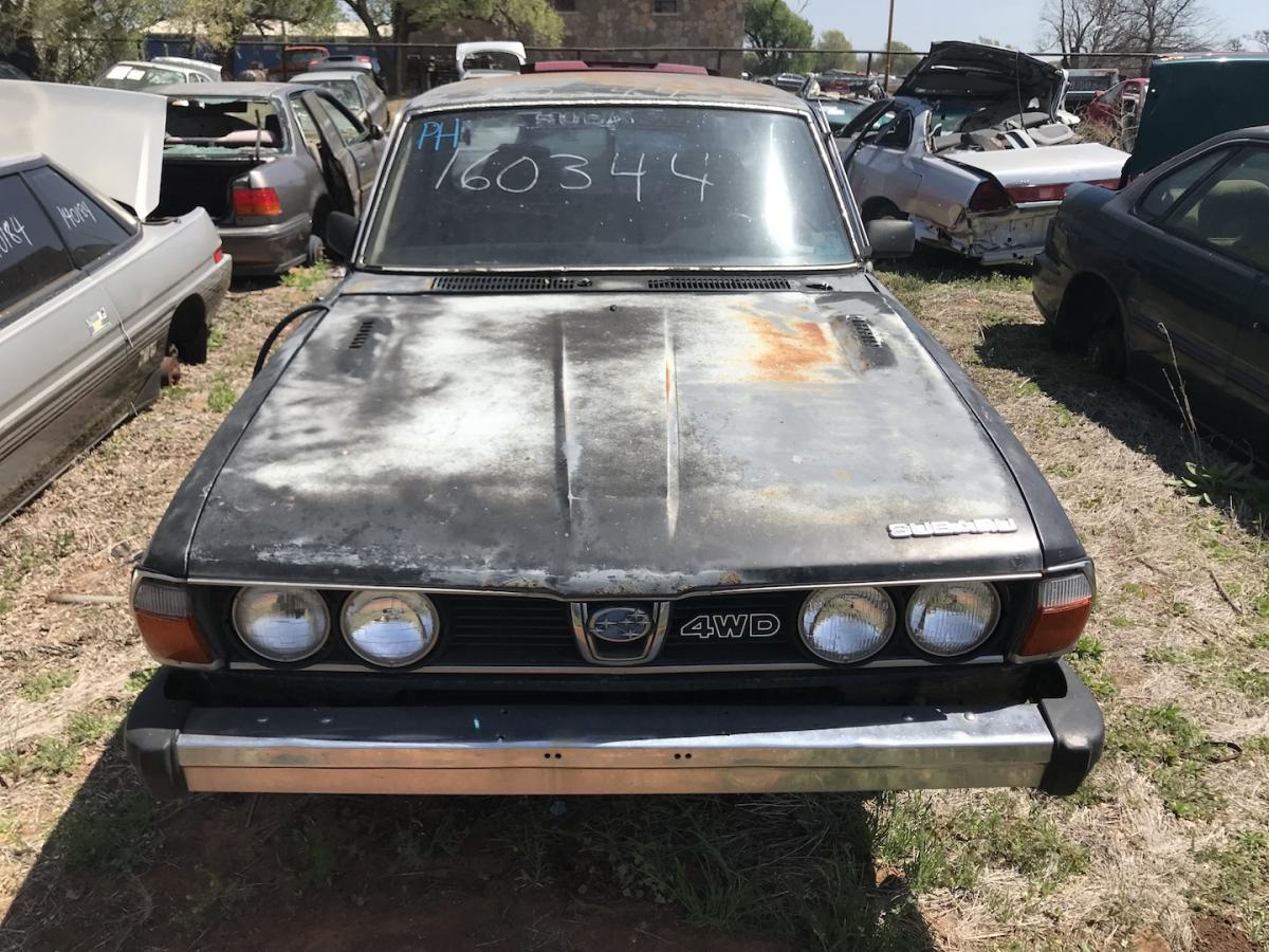

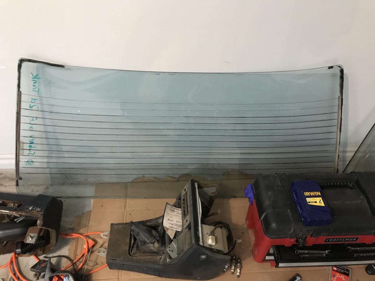

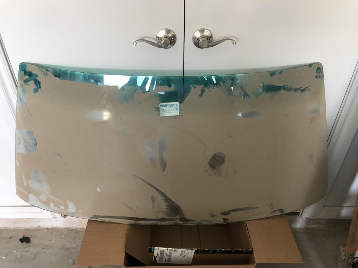

tylertrend Posted April 11, 2018 Author Share Posted April 11, 2018 Today turned out to be a great day for the project. I drove down to a junkyard thats the size of a small town in Roosevelt, OK. Called Parts World. They are very helpful and have so much inventory I almost passed out. I went down there to snag a NOS Windshield for the coupe and also a good used rear windscreen. For a bit over $100, I'm pretty happy. My windshield cracked badly when I took it out and I haven't done the rear yet so I wanted to have a backup plan. Then as I was walking through the yard, there I could see it, recognizable from a mile away, a first gen brat. This was the first time I'd stood next to one in person, and even though they are quite small, I now know why myself and many others are so fascinated with them. Aside from rotted floorpans, this 1981 GL built in 06/81 with only 112k is almost fully complete and has a ea81 with 4spd d/r. After mucking about a bit and snapping some photos, I saw that it had a hitachi carb on it w/ manual choke. Not wanting to deal with the C-W that I have now, I got out the 4-6 basic tools I always carry in my trunk and removed the whole manifold and carburetor right there. Score! I really am still getting used to this whole some cars aren't fully rotted to high heaven after 8 years thing (I grew up in Maine), it makes these operations so easy! I have attached a few pics for your enjoyment. 1 Link to comment Share on other sites More sharing options...

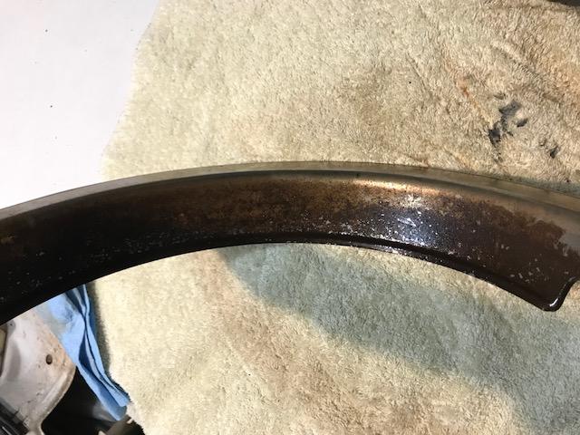

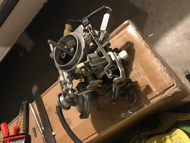

tylertrend Posted April 26, 2018 Author Share Posted April 26, 2018 Alright, here's a couple days of updates at once. 1) I got the carburetor cleaned up and torn apart, cleaned the innards and reassembled with new gaskets. It didn't look nearly as bad inside as I thought it might which was great. I'm almost positive I am going to have to play with the float adjustment when things get put back together but I did not have any leftover parts when I was done so thats a good start in my book! 2) I worked on cleaning up the chrome wheel rings which were pretty rusted and nasty but a few hours and a bottle of chrome polish has them looking almost new. Very impressed with the durability and look of them. Also shined up the center caps. 3) I received my Front and Rear windshield gaskets from Phils Rotary/ New Old Car Company. They are the correct part and appear to fit well. Not much I can do with them right now but I'm very excited for that search to be over. For reference, the factory part numbers are: Front 765061030 Rear 765061040 1 Link to comment Share on other sites More sharing options...

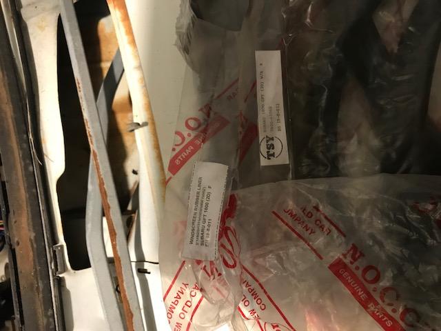

carfreak85 Posted April 26, 2018 Share Posted April 26, 2018 Do you mind sharing the landed cost of those two gaskets? Link to comment Share on other sites More sharing options...
tylertrend Posted April 26, 2018 Author Share Posted April 26, 2018 At current exchange rates it was $188 to the door. 1 Link to comment Share on other sites More sharing options...

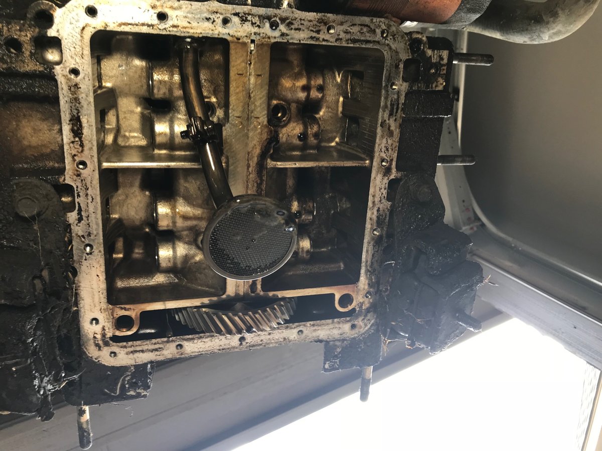

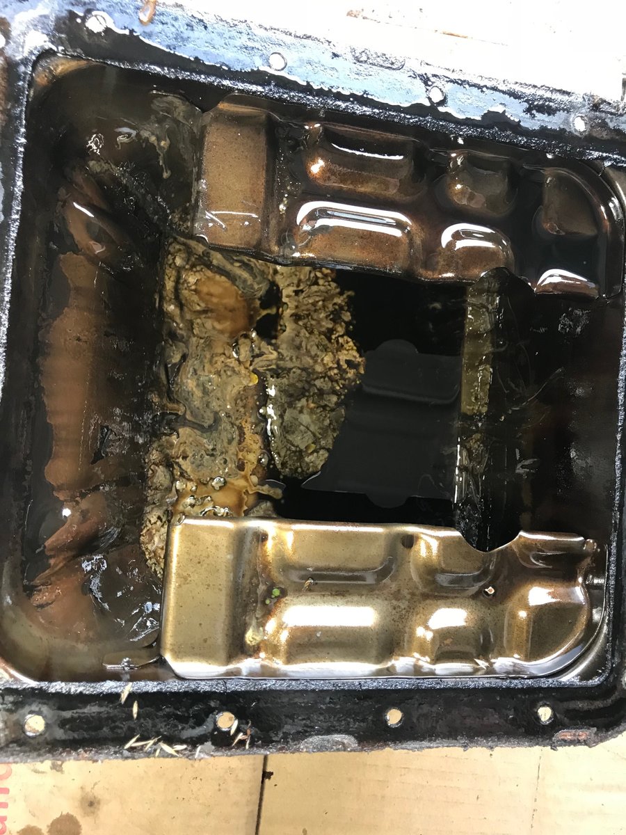

tylertrend Posted July 1, 2018 Author Share Posted July 1, 2018 Hello all, I am finally back home after some time away and back to working on projects. I finally have all of my spare ea81 parts at my house and some of them are going to come in very handy. The last couple of days have mostly consisted of preparing my replacement dash, going over wiring, changing light bulbs, etc. Work on the engine has involved cleaning the heads and getting them ready for reassembly, resealing the oil pump, changing WP and cleaning the oil pan. I was lucky, on the oil pump I just took the 4 bolts out and lightly tapped the oil filter twice and it fell right out. It looks pretty healthy inside. The same cannot be said for the oil pan. When I removed it there was nearly an inch of thick, coolanty sludge on the bottom. The bores, inside of the block, lifters and everything else look really good, but this certainly reinforces my thinking of a significant coolant breach in the past. Regarding the oil pickup, I was hoping some of you could offer some input. I loosened the holder and tried for a few minutes to remove it but it won't budge. The gasket is cracking away and looks unhealthy but if the tube is pressed into the block that well, is there really any worry about it leaking? Or do I need to find a way to remove it and reseal? The last thing I was working on was cleaning out the hvac box/ heater core. Found a blown HC and leaky coolant control valve that I am trying to deal with. That post is linked below. Any input on that is also appreciated. Until next time.. 1 Link to comment Share on other sites More sharing options...
Bdamit Posted July 1, 2018 Share Posted July 1, 2018 Inspirational work sir, keep at it! thanks! Link to comment Share on other sites More sharing options...

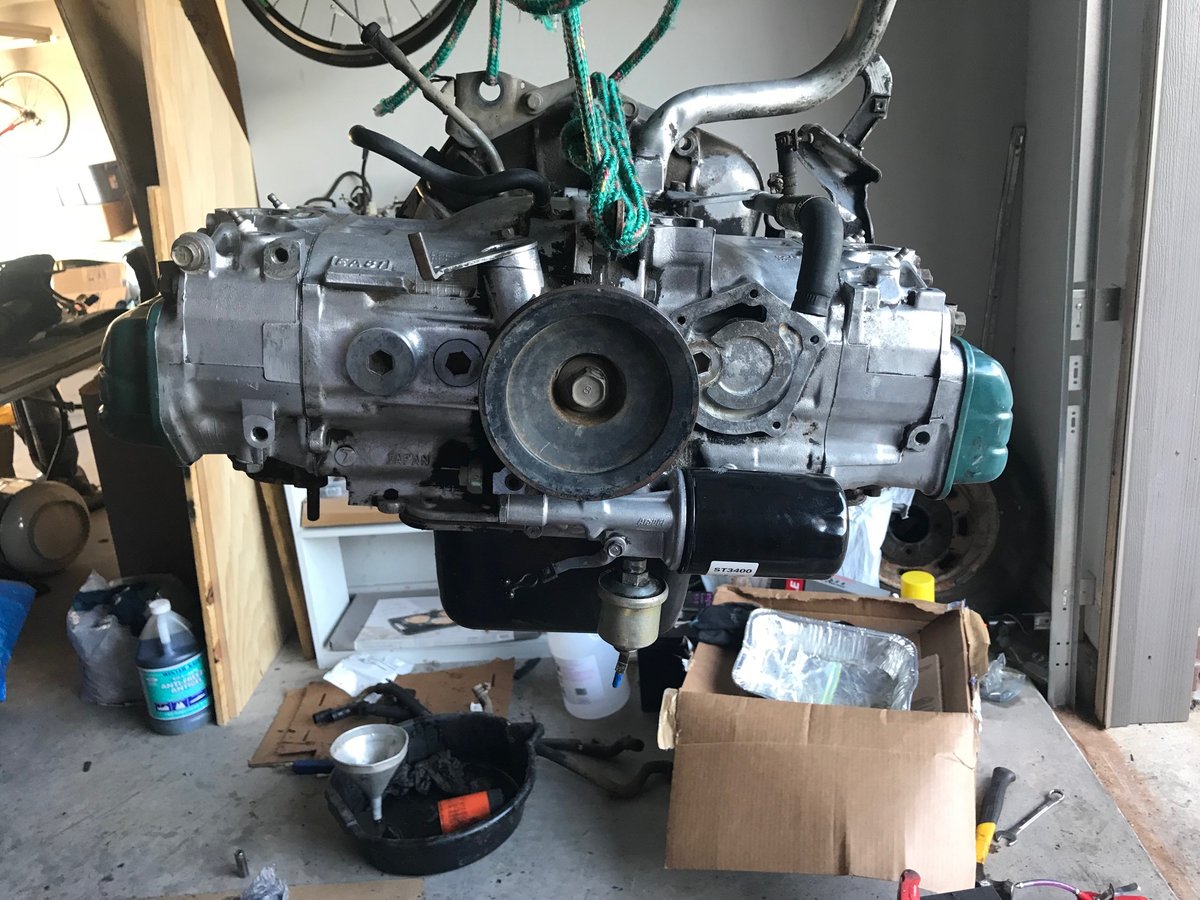

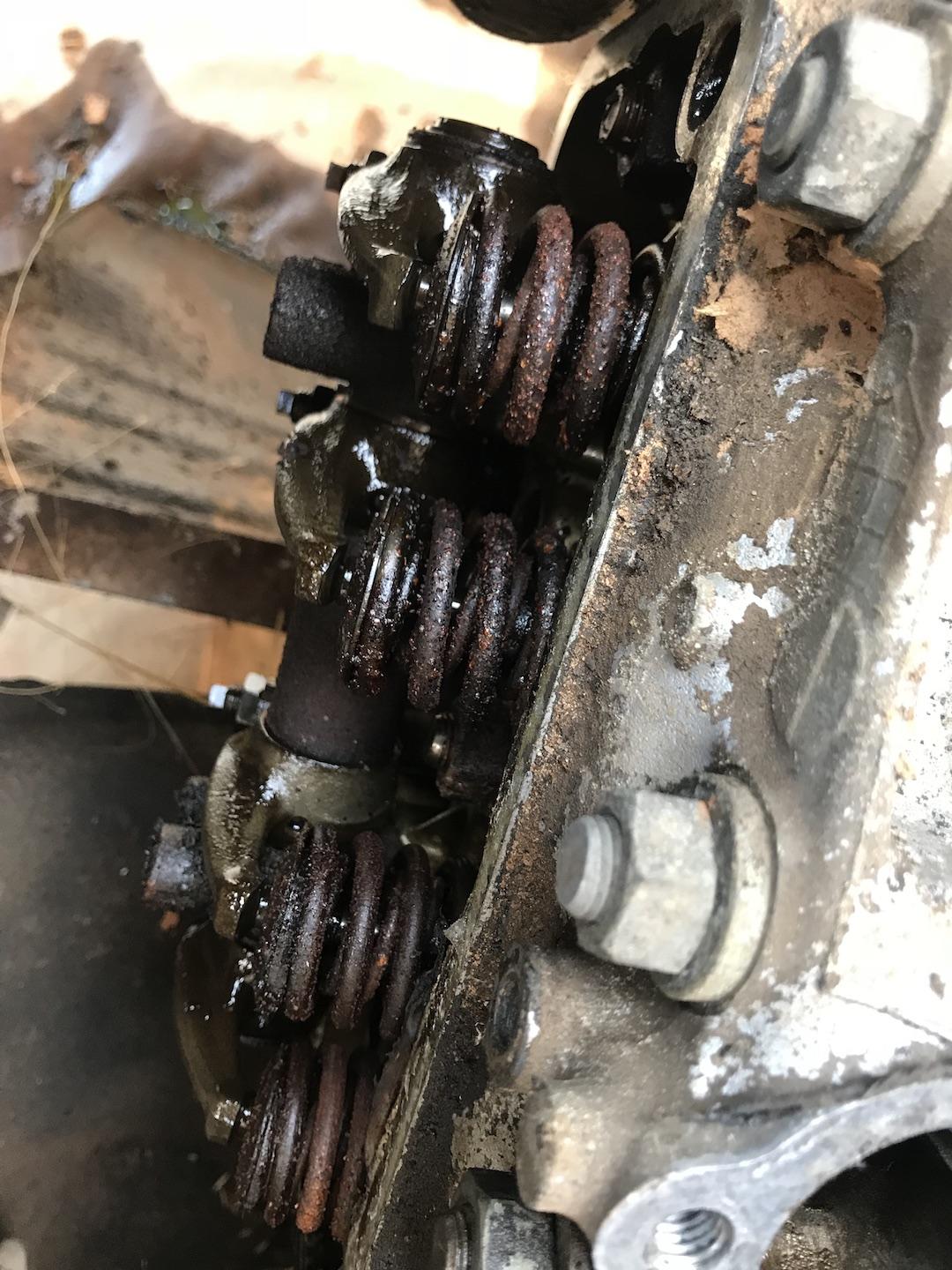

tylertrend Posted July 5, 2018 Author Share Posted July 5, 2018 Todays work involved getting the heads on, adjusting valves, bolt on oil pan, reseal oil pump and install and wash the whole engine. I am very pleased with how clean it came out. I guess all of that crud on there did a good job of keeping the aluminum clean! All I need to do is install clutch and WP and the engine will be going back in, hopefully on Friday. Link to comment Share on other sites More sharing options...
tylertrend Posted July 5, 2018 Author Share Posted July 5, 2018 Also a picture of the cleaned up valve train. The springs were very healthy under a light surface rust so I just cleaned them and put them back in, after grinding the valves. Link to comment Share on other sites More sharing options...

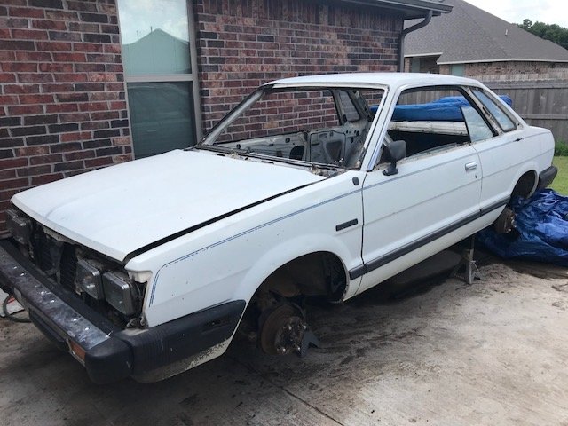

rdweninger Posted July 12, 2018 Share Posted July 12, 2018 can you post pics of your coupe? Can't wait to 'hear' it run... Link to comment Share on other sites More sharing options...
tylertrend Posted July 12, 2018 Author Share Posted July 12, 2018 2 hours ago, rdweninger said: can you post pics of your coupe? Can't wait to 'hear' it run... I will tomorrow, although its pretty torn apart so it won't be looking too hot. I actually ran the engine today for first time and she goes pretty good but theres no fuel or water system yet so I won't run it again until the vehicle is all back together. Link to comment Share on other sites More sharing options...

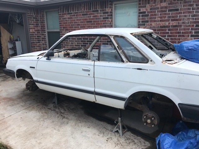

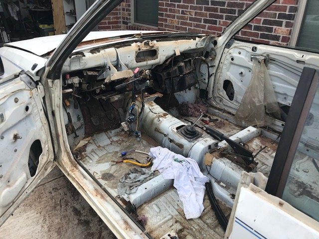

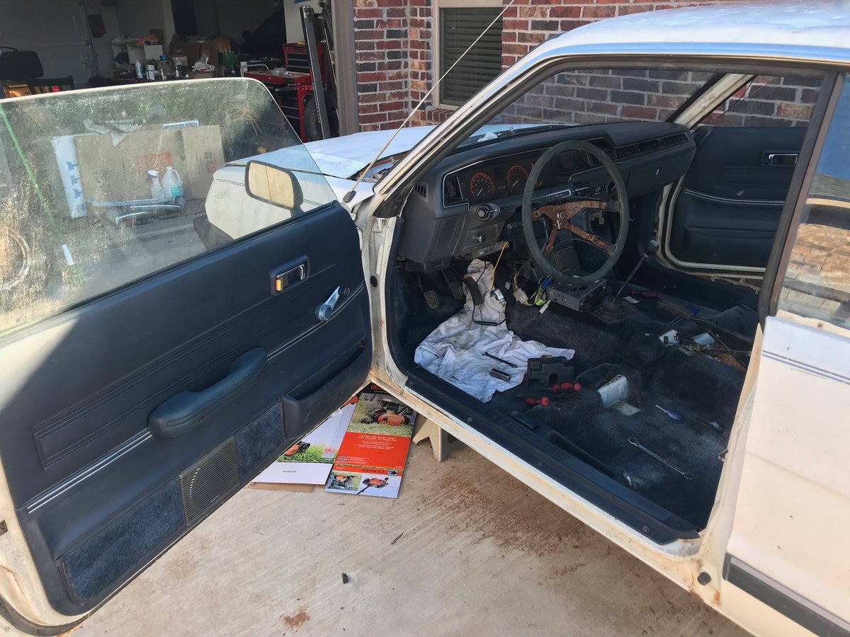

tylertrend Posted July 12, 2018 Author Share Posted July 12, 2018 Update: the engine is installed and has been run momentarily. It works, pumps oil and actually sounds pretty good - Success! Work will now be shifting to the body and interior which is being held up while I wait for parts to figure out this heater core debacle. As requested, attached are some pics of the car currently. 2 Link to comment Share on other sites More sharing options...

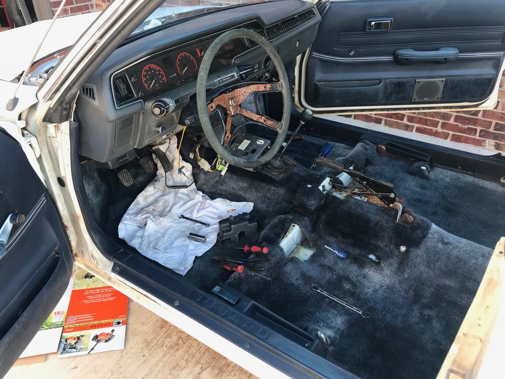

tylertrend Posted November 25, 2018 Author Share Posted November 25, 2018 Wow, time really flies when you're having fun . Since last update this project has been so trying at times that I was ready to light a napalm fire under it and laugh while it burned, but luckily mind prevailed over matter. The engine is now tuned and running quite well, although loud due to the missing muffler. All the glass is reinstalled (Holy .... what a cluster that was). Most of the interior is reinstalled less the seats which need serious surgery. I am very impressed with how well I was able to clean/ revitalize much of the interior; the carpet is a standout example. I wasted half of my day today finding a short in the horn/ chime circuit. Turns out way back when I was prepping the dash I plugged the harness side of the key switch for the chime into probably a lighting circuit or something. Doh, I guess we all make mistakes, and now my chime works again! I also got around to testing the A/C. It works when jumping the pressure sensor so it just needs recharged. Its an original R-12 system, great! Progress has been slow the last few months but things are falling into place now and updates should be more frequent. I admit I may have gotten slightly sidetracked when I bought an old Mercedes diesel in August . Video of the engine running and accompanying racket of noise coming up soon. Link to comment Share on other sites More sharing options...

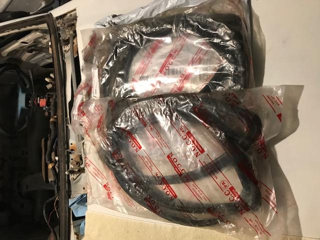

tylertrend Posted November 27, 2018 Author Share Posted November 27, 2018 (edited) On 11/26/2018 at 9:41 AM, carfreak85 said: The carpet looks great! Tell us more about your window glass reinstallation experience. Yes, very pleased with the carpet. The story on the windshield is such: I broke the original taking it out being stupid. Sourced a NOS replacement and new rubber seals which was an experience in itself. When I was putting in my new windshield I cracked the upper right corner. Thinking it would shatter if I kept messing with it, I left the project alone for a while until a family member came to visit for Thanksgiving and I had them bring yet another windshield down with them. Ended up being for a completely different vehicle make. Hilarious. So we ended up putting my cracked NOS windshield in and it cracked more going in but didnt shatter so it'll be like that for a while until I come across another good one. And thats the story. Oh, and we put the rear window in in under 20 minutes with no issues. It's a much easier install. Go figure. Edited November 27, 2018 by tylertrend Added details Link to comment Share on other sites More sharing options...
