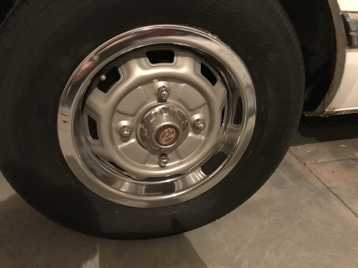

tylertrend Posted July 9, 2019 Author Share Posted July 9, 2019 New update, I just got done moving to a new place across town and I brought the car over to her new home last night. First time I have driven the car ever outside of the driveway. The ride was less than comfortable on my back because I still don't have my seats done, so a stack of old sheets had to suffice. I was very impressed with the ride, the shifting, and the power (props to me for knowing carburetors well and timing engines by feel ). The tires look like they were made in the last millenia and are not perfectly round but that's little stuff, and I'm hoping they get better with use. And the tires are supported by freshly painted wheels, complete with OE trim rings and center caps. They turned out great for a weekend job, I used my auto guns with a Nason primer and base/clear system. As soon as the seats are done along with some other interior tid bits, she'll be cruisin' around town regularly. Other recent work has included fitting the rear window trim, exterior trim, full brake job, axle, a replacement front hub and the like. More to come, Stay tuned 3 Link to comment Share on other sites More sharing options...

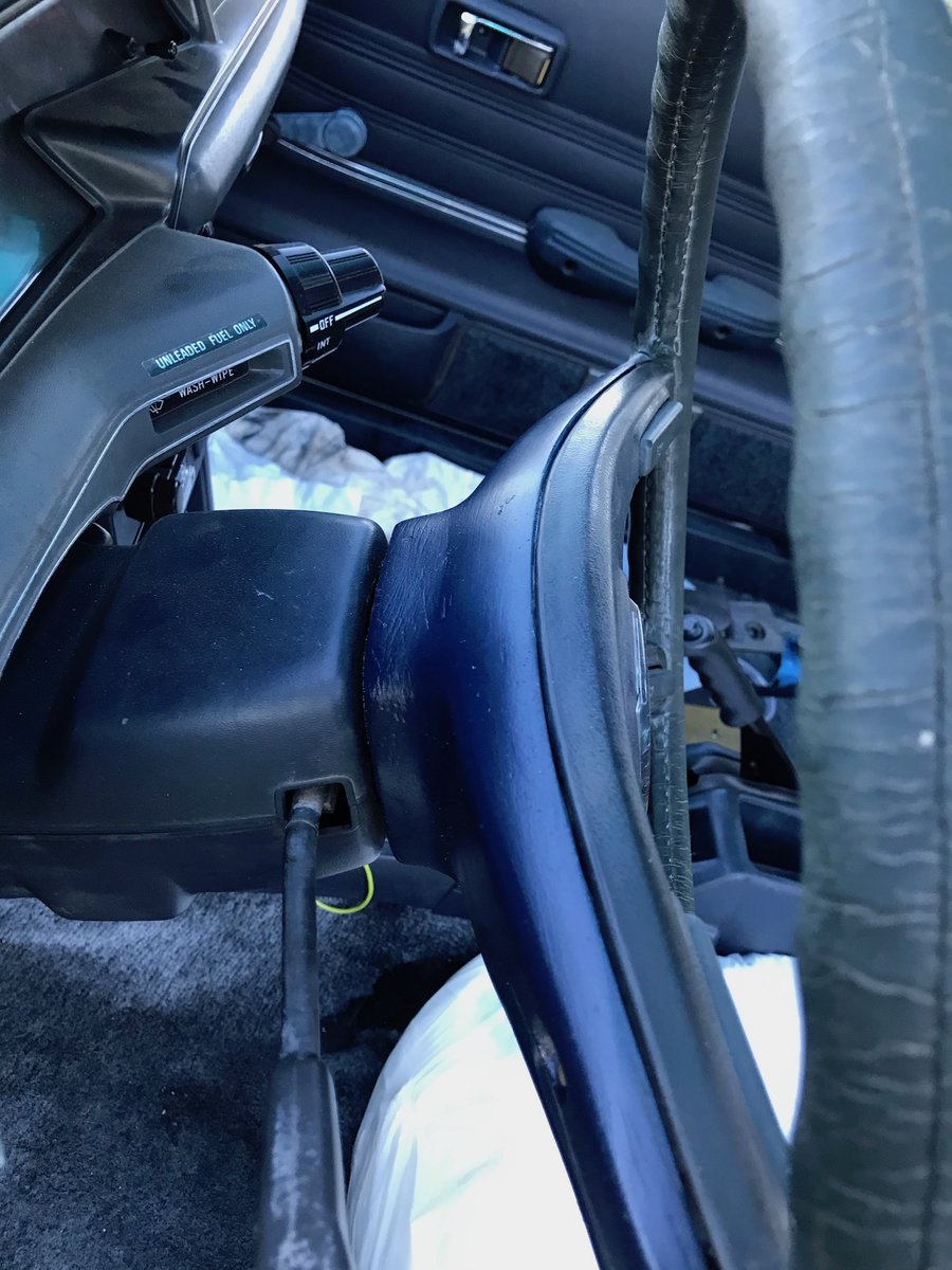

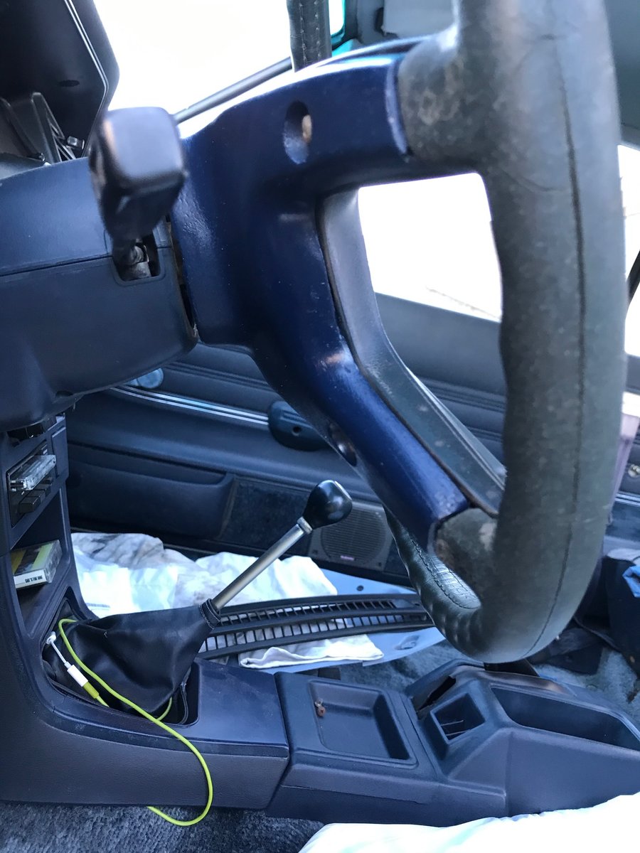

tylertrend Posted October 29, 2019 Author Share Posted October 29, 2019 (edited) Finished repairing the trim behind the steering wheel. The plastic was breaking apart so I built it back up with epoxy where it was disintegrating, shaped it and painted it. The paint is a Rustoleum Classic Navy blue which is close enough the the blue interiors to be acceptable. The making of the new seats is underway also. Edited October 29, 2019 by tylertrend Fixed Pictures 1 Link to comment Share on other sites More sharing options...

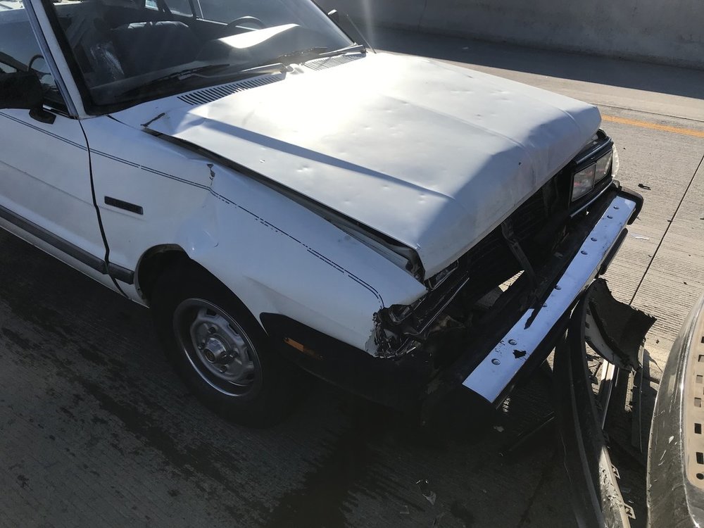

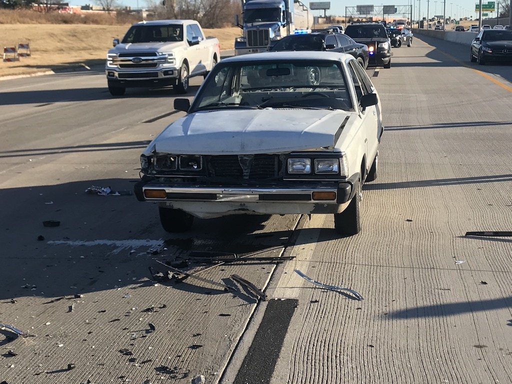

tylertrend Posted December 19, 2019 Author Share Posted December 19, 2019 (edited) So today was a rough day. I was in involved in a 4 car collision on the freeway, luckily being the last of the string to rear end the one in front of them. The Coupe sustained damage to the front trim, core support, fender, hood, rad etc but luckily the frame looks largely unharmed. It is sitting at the shop where I work part time and we are assessing the damage to see about how or if we can repair it. At this point all I can say is I will do everything to keep it from turning into your next bud light can but this process will take time. The causation of the accident was not my fault, I just ended up being the last one involved and didn't act quick enough to save it (was not distracted or road raging. I truly do enjoy driving this car, it's easy to drive and has a lot of character, but this was a huge blow mentally and somewhat physically. That big 'ol steering wheel leaves a little to be desired when it comes to crash safety but I walked away so, eh. Edited January 25, 2020 by tylertrend Link to comment Share on other sites More sharing options...

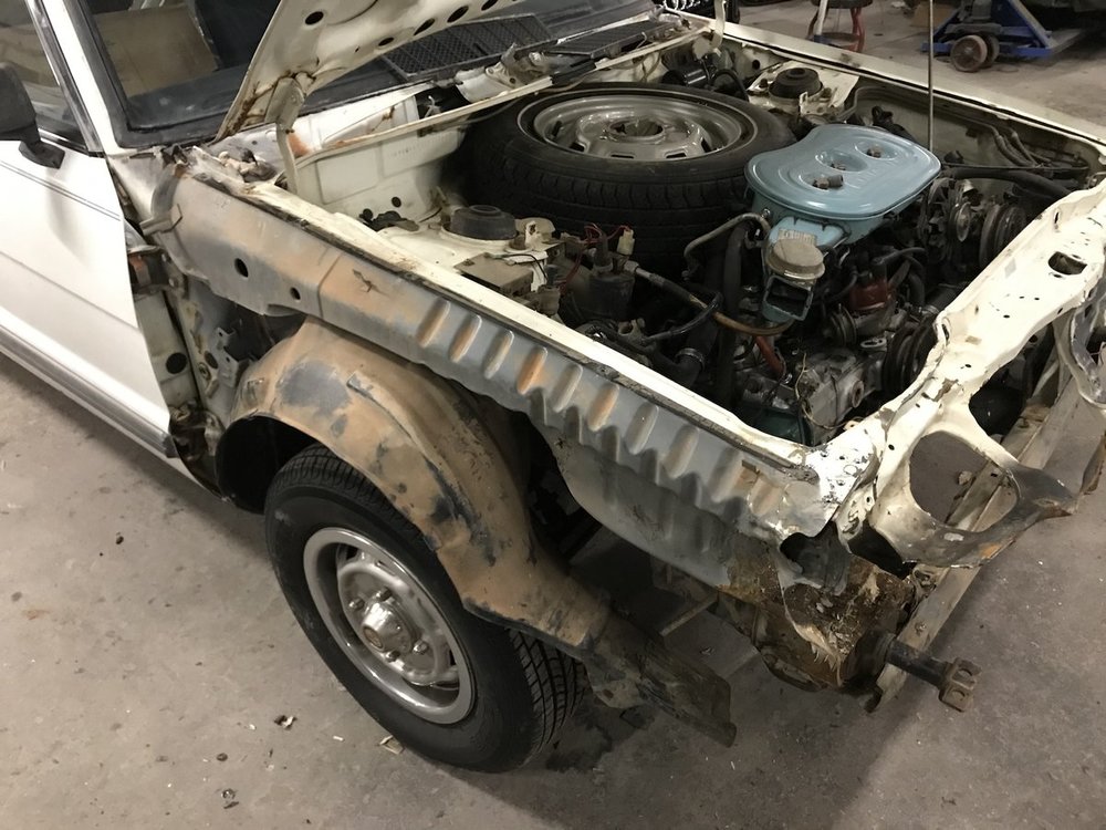

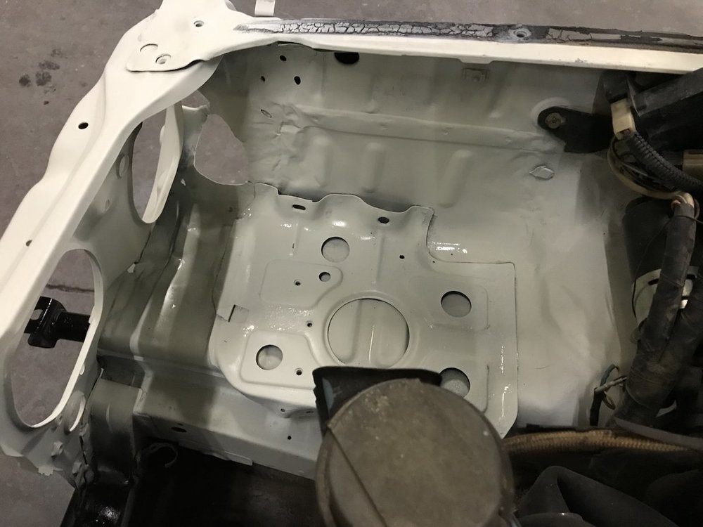

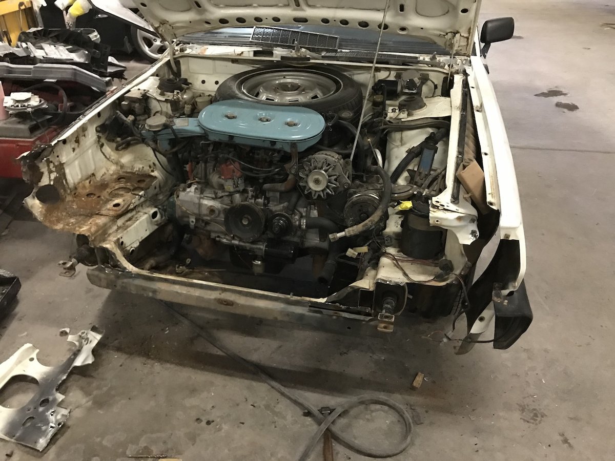

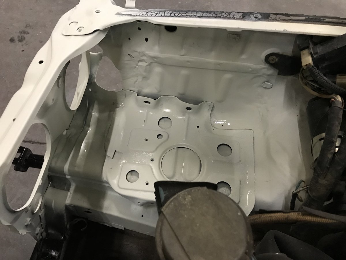

tylertrend Posted December 29, 2019 Author Share Posted December 29, 2019 Thanks everyone for your supportive comments. I am in the process of ordering parts to get her fixed up! Got the hood open and the fender apron is very easily repairable. I have ordered a crank pulley, headlamp assembly and a NEW core support (Don't ask, I don't want to wear out my god powers). Just need to make a trip to get my radiator and fender. The shop figures 1-2 days to pull it all straight, cut out the old and weld in the new. Plan on it being roadworthy the end of January. 1 Link to comment Share on other sites More sharing options...

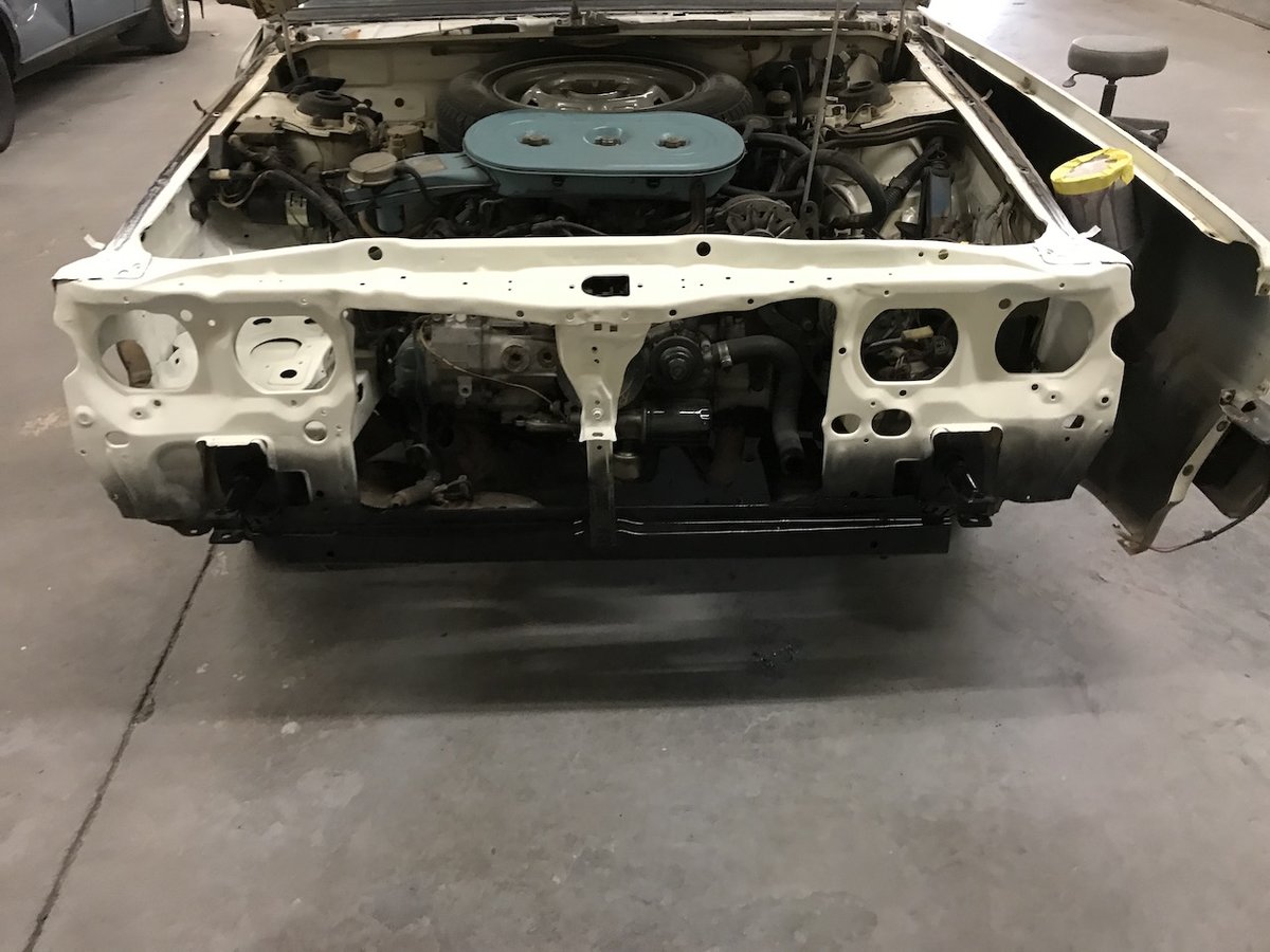

tylertrend Posted January 25, 2020 Author Share Posted January 25, 2020 (edited) Not bad for a couple days work. I am putting everything back on the front end tomorrow and it'll be back prowling the streets sometime next week. We were all surprised and impressed by how well the structure held up, and whatever degree of energy absorption engineering is there did its job well. I feel lucky that no major frame rails were acutely bent or mashed, as that probably would have been the end of the road. Time to throw all this ugly business to the past and get back to enjoying my.., erm, classy ride. Edited January 25, 2020 by tylertrend Link to comment Share on other sites More sharing options...
Mitchy Posted January 25, 2020 Share Posted January 25, 2020 Amazing comeback! i’m really stoked for you and your coupe, so much work going into it. It’ll be better than ever, no doubt. Looking at the post-crash pics, I suppose you were a bit nose-dived when you hit the high bumper of the suv, so really the hood and upper front panel took the impact, and not the chassis rails. I‘m now wondering if it wouldn’t be a great idea to fix the smashed Legacy..... Link to comment Share on other sites More sharing options...
tylertrend Posted January 25, 2020 Author Share Posted January 25, 2020 3 hours ago, Mitchy said: Amazing comeback! i’m really stoked for you and your coupe, so much work going into it. It’ll be better than ever, no doubt. Looking at the post-crash pics, I suppose you were a bit nose-dived when you hit the high bumper of the suv, so really the hood and upper front panel took the impact, and not the chassis rails. I‘m now wondering if it wouldn’t be a great idea to fix the smashed Legacy..... It was quite nose low on impact and my bumper just BARELY slid under theirs. Those Subie bumpers are surprisingly heavy duty and a good hit to one would bring that frame rail to its knees, is my guess. It wont be the prettiest thing around for a while, but at least it's still around. Where did your Legacy take damage? Link to comment Share on other sites More sharing options...

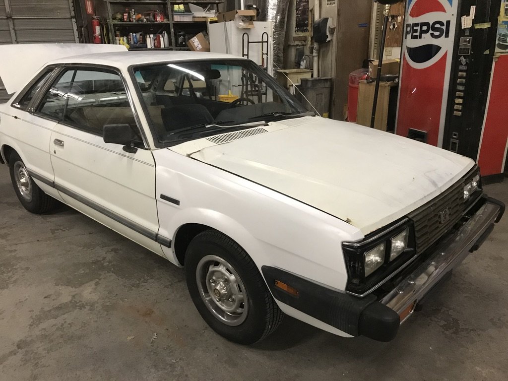

tylertrend Posted February 2, 2020 Author Share Posted February 2, 2020 Well chaps, she is all done! Got the rest of everything put on today and drove it home. Drives just like it did before.. straight, true and zippy. The fender I painted with a rattle can of Rustoleum white satin. It's at least white but I will try to get something a bit closer to dust it with in the future. Also painted the black on the headlight surrounds while they were off. Time to finally try to get through this whole tank of fuel and figure out my MPGs. In case anyone might be wondering, we estimate the hit velocity somewhere in the upper teens, in MPH. The full parts list is: Core support Fender Headlamp assembly Crank pulley Radiator Battery Rad Fan (I had) Headlight surround (I had) Grille (I had) Straightened the existing hood Total parts bill was shy of $500. Shop estimated $2-4k if someone had just brought it in wanting it fixed. Good thing I had plenty of time to put into it! I elected not to replace any A/C parts as I see that as a *maybe* project down the road. 2 Link to comment Share on other sites More sharing options...
