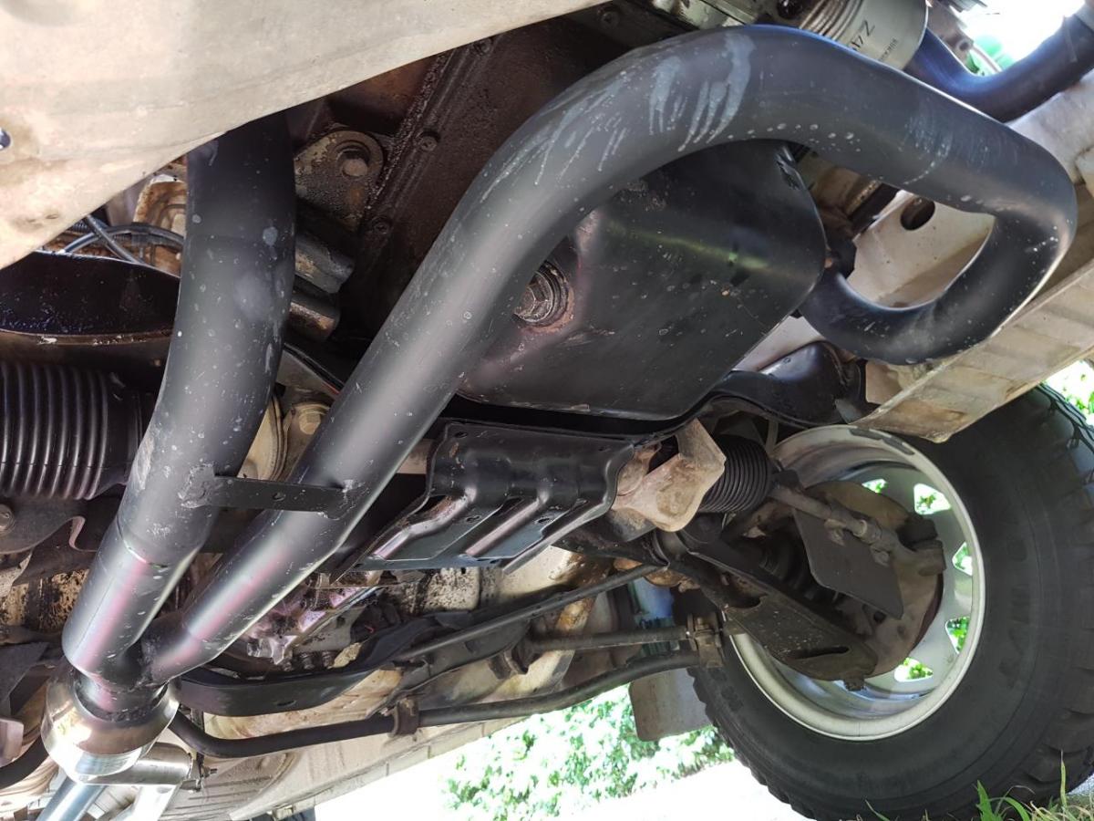

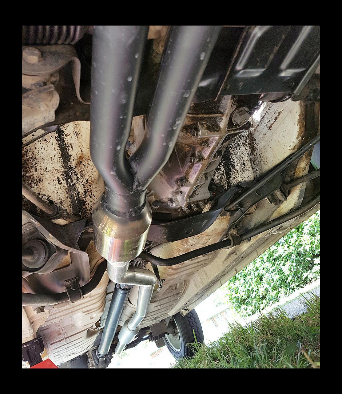

Knucklehead Saloon Posted April 13, 2018 Share Posted April 13, 2018 I drew up what I wanted on a piece of paper and saw a good exhaust dude. Found a shop close by who did custom work on cars and harleys. I got unequal length headers for that suby throb in 1-3/4". From there into a side by side motorcycle type 2" collector-> to 2" hiflow cat -> 2" pipe -> 2" resonator-> 2" turbo pattern muffler. Sounds great, makes more power over 3500rpm. My exhaust fab skills are nowhere near as good as the guys who do it for a living. 1 Link to comment Share on other sites More sharing options...
