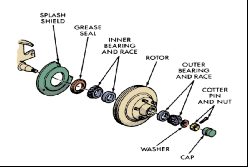

I have two single tapered roller bearing with a spacer between. Not the wheel bearing rockauto has.
can someone please tell me what I need, part numbers, and where to get it
attach file wheel bearing
The aftermarket wheel bearings have the roller surfaces as one complete unit, the spacer on the axle is typically built into the bearing eliminating the extra rings - basically making a 6 part bearing into a three part bearing package.

 I have the three part singel bearing. and it do not fit my car. two different ways to mount wheel bearings. My rear wheel setup is more like front wheel setup. where you push the bearing from both sides with a sleeve between. I use two two single tapered roller bearing with a spacer at the rear, in front I use two ball bearing with a spacer. I can not find any number on the bearing,

If you have a 4wd Brat, You're wheel bearing is nothing like any of your above pictures.
The 6 piece bearing has been superceeded to the large, 3 piece roller.
You need to remove the rtainer ring at the inner side to remove the bearings and stub.
Then press the stub through the 3 piece roller.
then press/hammer, the bearing and stub through the back side of the swingarm.  Reinstall retainer.
you need a bearing like this  www.ebay.com/itm/For-DL-Brat-FE-GF-GL-GL-10-GLF-Loyale-RX-Standard-XT-Rear-Wheel-Bearing-New/361740436262
