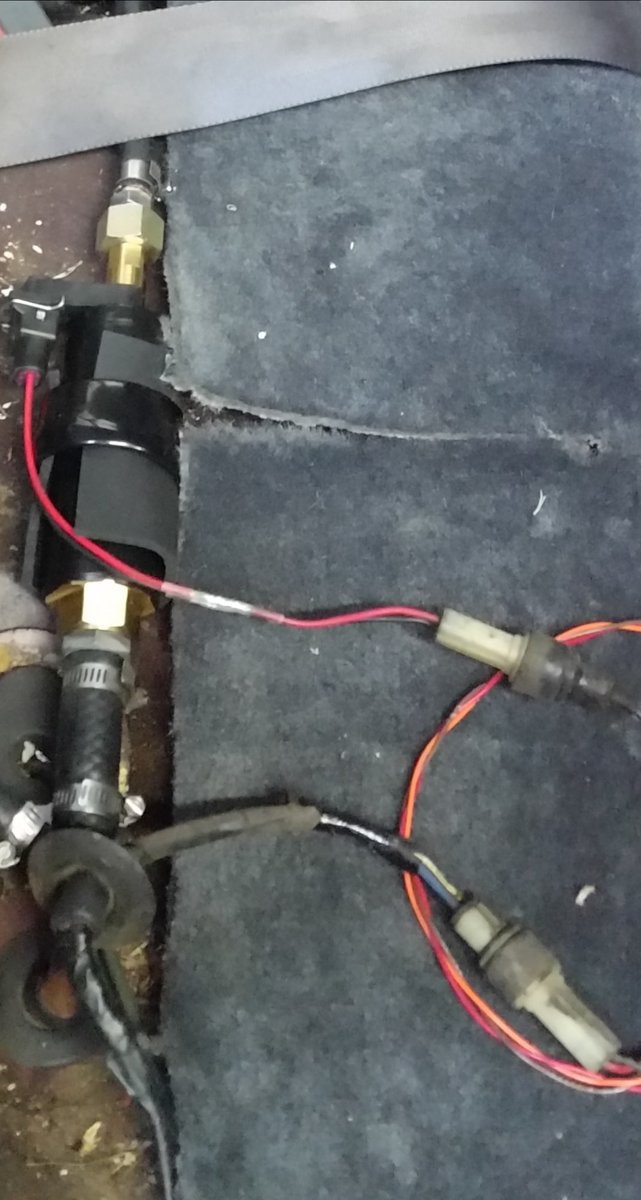

DaveT Posted June 28, 2018 Author Share Posted June 28, 2018 Another update. The new pump is hooked up fuel line wise. I'll add pictures once it's mounted and wired. Link to comment Share on other sites More sharing options...
DaveT Posted June 28, 2018 Author Share Posted June 28, 2018 On 6/27/2018 at 11:34 PM, Silas Cruse said: Which pump , part number did you go with ? Expand I got a Carter P5000. Link to comment Share on other sites More sharing options...

DaveT Posted June 29, 2018 Author Share Posted June 29, 2018 I should have a chance to get a test run in over this weekend. The only thing left to do now is solder the 2 wire from an old Subaru connector to the new Carter connector. A whole list of other things going on has been making my progress on this a bit slower than typical. Link to comment Share on other sites More sharing options...
DaveT Posted July 1, 2018 Author Share Posted July 1, 2018 Test run done. It's not the fuel pump. Last night, I ran the new pump, pressure looked good,etc. Today, I started the car and the pressure was bopping up and down again, 20 to 22 PSI. Ran great and normal, until I got it warm and decided to take the bigger risk of a main road with a steep uphill grade, when the sputtering began under load. Made it home ok at least. Debating next move... Swap the pressure regulator, or the injector? I installed the Carter P5000 in the space between the rear set and the floor, so it is not in the weather. Link to comment Share on other sites More sharing options...
