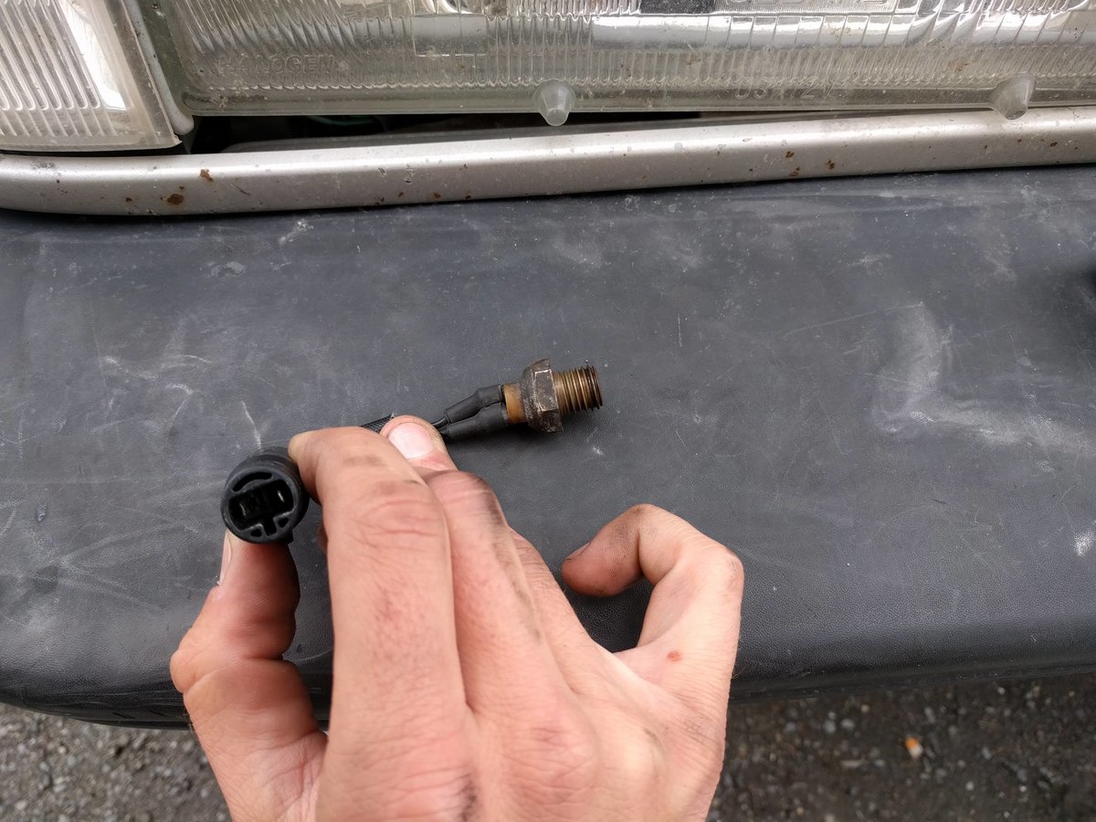

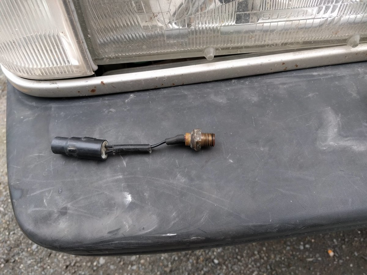

Brianmitchtay Posted June 19, 2018 Author Share Posted June 19, 2018 Ha! just as I felt like I had it solved! Last night I was camped out by Kenai Lake on a rural road and it took me 45 minutes of cranking and playing with things to get it started this morning. Wah Wah. Conveniently I already had an appointment with a "Subaru Specialist" in Soldotna this morning, and they were very confident on the phone that they would have no trouble solving the problem. The "Specialist" says that he's confident that the problem is the CTS even though it puts out the correct resistance value at all temperatures, his reasoning was that everything else "looks good" he also said that the CTS for this model is no longer available. It's a black, round, two prong plug off a two blade sensor. I also haven't been able to find a sensor that looks the same in my brief search. It's worth noting that while having a friend turn the key to "on" I couldn't hear the fuel pump pressurizing the fuel system, it is supposed to do that, right? I can hear the pump running when the car is idling. If anyone has a spare Coolant Temperature sensor laying around that looks like mine, I'd be happy to buy it off you and pay for shipping just to give it a shot. Link to comment Share on other sites More sharing options...
DaveT Posted June 19, 2018 Share Posted June 19, 2018 If it reads the correct resistance at a number of temperatures, and that is read steady, not jumping around, only slowly drifting as it heats or cools, then it is probably good. If it is jumping around, that's bad, like the bad one I had. Yes, the fuel pump should run momentarily when you first turn the key. I'll add this part to my list of pieces to find replacements for.... 1 Link to comment Share on other sites More sharing options...
Brianmitchtay Posted June 19, 2018 Author Share Posted June 19, 2018 14 minutes ago, DaveT said: If it reads the correct resistance at a number of temperatures, and that is read steady, not jumping around, only slowly drifting as it heats or cools, then it is probably good. If it is jumping around, that's bad, like the bad one I had. Yes, the fuel pump should run momentarily when you first turn the key. I'll add this part to my list of pieces to find replacements for.... Yeah it gives a steady reading that is right in line with the resistance values posted in the FSM, I'm figuring that it's not the sensor that's bad. Do you know if it could be a fault of the pump that would cause it to not run when the key is turned to on? Or would that more likely be a problem in the circuit where I put the key in the ignition? I've been sleeping in the car and there's been quite a bit of condensation on these rainy nights with the windows barely cracked. So maybe there's some corrosion or something there... I'll try to look into it. Thanks as always Dave Link to comment Share on other sites More sharing options...

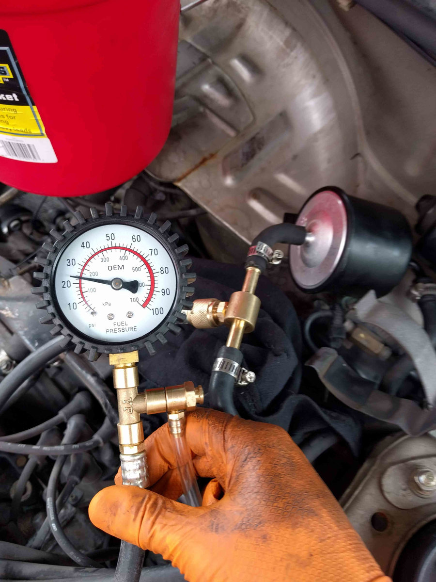

Brianmitchtay Posted June 27, 2018 Author Share Posted June 27, 2018 (edited) Well today I finally got a chance to plug a fuel pressure gauge into the line and I'm still a little confused. The FSM says that the Fuel pump's discharge pressure spec on a SPFI is between 36-50psi. With the fuel pressure gauge T'd in between the fuel filter and the throttle chamber I had the pressure bouncing up to ~25psi when the pump turned on, and falling to about 20 when the pump was off. Here's a video of that if you want to see for some reason - I had connected the test mode plugs so the fuel pump would operate intermittently with the key turned on (Otherwise I don't think it runs unless you're cranking or the car is running, if I understand the FSM correctly) So just looking at this I thought, Ha! my fuel pump isn't pumping hard enough! Problem solved! But then since I had the fuel gauge rented already, and the FSM says a faulty pressure regulator could be the problem for hard cold starts, I decided to look at the procedures for testing the Pressure regulator. Book says to T the gauge into the fuel line that goes to the throttle chamber (So where I already had it) and that at idle the fuel pressure should be regulated to ~21. I disconnected the test plugs and started it up and the fuel pressure at idle was exactly where it was supposed to be. So I guess my question is, did I test the pressure from the fuel pump correctly? Should I have T'd in directly after the fuel pump under the car? I didn't have another person there with me so I couldn't exactly race the engine to watch for a change in pressure. It might be worth noting that the only procedure the book gives to check the pump on a SPFI is to hot wire it with 12v and see if it turns on. I'll be honest it's pretty fun having a car mystery to solve like this since it basically just gives me a reason to play around under the hood and learn new things, but since the GL is my daily driver and also my home for the summer, I'll also be pleased to have this squared away. For what it's worth I'm pretty confident the CTS isn't the culprit at this point, it always gives the correct resistance reading, even when the car is having trouble starting, but I took the time to test one and pull it off a junk car at a scrap yard here anyway, along with a fuel injector that looks and tests just fine. So if it gets really bad and a new fuel pump doesn't fix it I'll do some soldering and replace those things. Edited June 27, 2018 by Brianmitchtay CTS and injector stuff Link to comment Share on other sites More sharing options...
DaveT Posted June 27, 2018 Share Posted June 27, 2018 Normal pressure with it running, T'ed after the filter, is 21PSI, steady. You can unplug the wires from the pump, under the car, and wire 12V directly to the pump for testing, if the engine won't stay running. If you block the output of the pump [only momentarily] the pressure should pop up to 50 PSI. Block it by pinching the hose after the pressure gauge T with smooth pliers / pad the jaws to avoid damage to the hose. Link to comment Share on other sites More sharing options...
