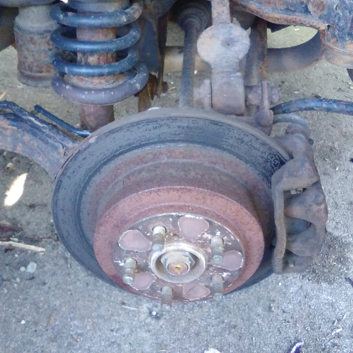

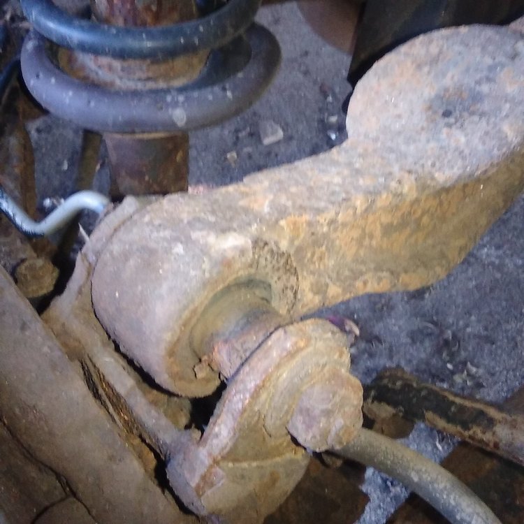

xdeadeye1 Posted July 11, 2018 Author Share Posted July 11, 2018 Regardless ng breaking power. I was rotating my wheels. I took some pics. Calipers look pretty rusted. Given its a 18 yr old car I figure I'll probably just get new rotors pads and calipers. I'm kinda concerned about the suspension parts and how they're rusted. Let me know your thoughts Link to comment Share on other sites More sharing options...

xdeadeye1 Posted July 12, 2018 Author Share Posted July 12, 2018 specifically the joint by the rotor in the first picture. Just above the caliper.. Looks like it should move or slide left to right.. But that thing isn't going anywhere. Link to comment Share on other sites More sharing options...

xdeadeye1 Posted July 30, 2018 Author Share Posted July 30, 2018 partial update. put thrans x in transmission fluid. The delayed engagement went away really quickly. As you can see in the picture of the brake rotor above. The caliper isn't engaging with the rotor. I pulled the caliper, the slide pins are moving easily. the caliper piston shoved back into the caliper. The rotors are wore out I believe. They are high along the edge of the rotor. you can really feel the wear with your hands, where the pad meets. Anyway.. The pads also seemed jammed in the hardware/bracket and don't move due to the high edge of the rotor. At least it seems that way. So im getting new rotors and pads and hardware. 1 Link to comment Share on other sites More sharing options...
MaxxRockatansky Posted August 14, 2018 Share Posted August 14, 2018 Looking at the pics, your brake rotors are done for, and it looks like the pads haven't been making proper contact, which is most likely the pads being more or less locked into the caliper mounts. When you replace the pads, make sure you either wire brush or carefully file the tracks for the pads to get rid of any rust/ crud buildup that is keeping them from sliding easily. Also remember to lube the caliper pins. If you are still looking for new ceramic pads and rotors, I found a matched 4 corner set for my 2K Legacy Wagon - should be same bits as the Outback - for just under $100 on flea-bay... there were a few sets for a bit less, but they didn't pass my muster. My rear rotors weren't as cooked as yours, but they did have at least that much of a rust ridge on the edges of the rotors when I bought my Subie 6 weeks ago, and I was going crazy from the major squealing coming from the pads from just going around turns (not even touching the brake!), so you may have been lucky that the pads weren't touching the rotors anymore!! Link to comment Share on other sites More sharing options...
xdeadeye1 Posted August 14, 2018 Author Share Posted August 14, 2018 (edited) Thanks Maxx. I just replaced all 4 rotors and pads from rockauto. you are correct about the rear pads not making contact they were indeed stuck . on the back brakes I ground the edge of the pads to make them fit. On the front caliper brackets I did use a file and file down parts of the caliper, and the pads fit without grinding them. Driver front caliper (dual piston) had one piston sticking. I pulled the pistons and polished them up and replaced seals and boots. the one piston does have some minor pitting. I polished it up but idk how long before it rusts up and starts sticking again. Should have just replaced the calipers, but was trying to save money. Edited August 14, 2018 by xdeadeye1 Link to comment Share on other sites More sharing options...
