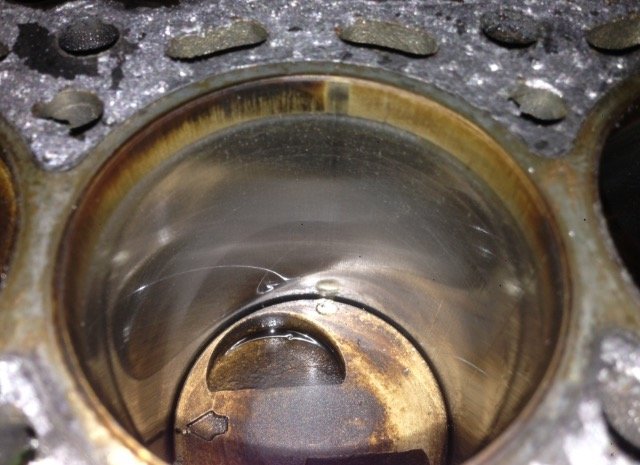

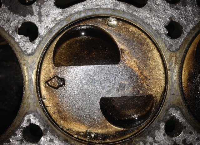

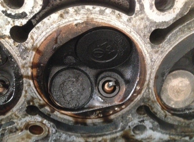

Bdamit Posted July 2, 2018 Author Share Posted July 2, 2018 Piston #2 has been mashing that piece of insulator against the head: There's a 5mm wide x 0.5mm deep crater (top centre) in the piston, and a few nicks. Can I get away with some light sanding? Your thoughts please... The remains of the insulation can be seen on the top centre border .... and you can see the nicks in the head (bottom right): The 4 cylinder bores are very good, a little polished perhaps, very few fine vertical score marks. Cylinder 2: I was planning to pull the crank and pistons this month for a light bore honing, install new rings, main seals etc. 1 Link to comment Share on other sites More sharing options...
