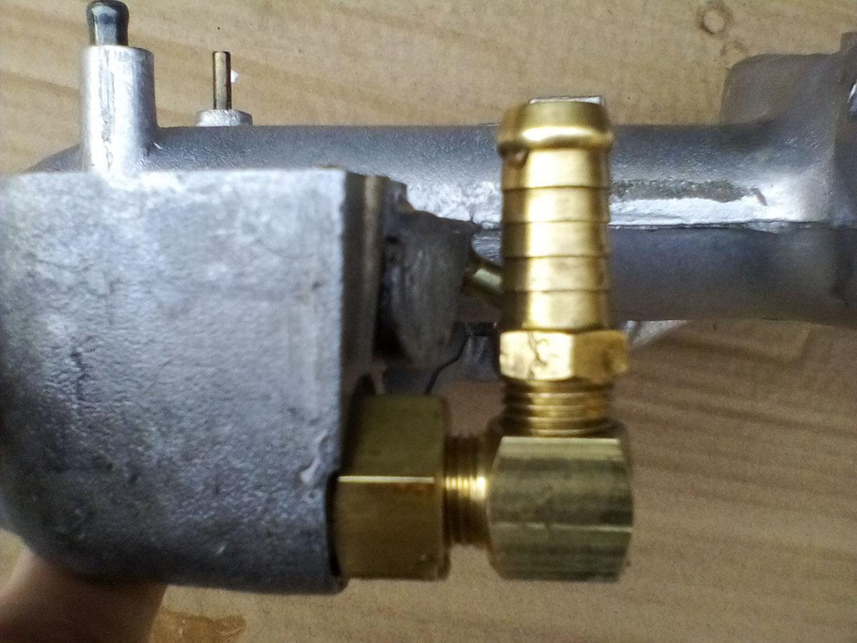

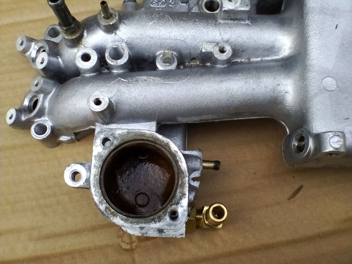

A dialogue before photos land. To avoid replacing/ renewing throttle body heater hoses I have drill out the crusty fittings, drilled and tapped to 28 tpi taper and plugged them.
Also pulled the cold start air bypass tube and capped it with a Welch plug
The main thing this post is about is the metal coolant tube from under thermostat to turbo. I could only find an NA inlet manifold so whipped out the temp sender, fitted in a reducer from M16 1.5 to the taper fittings, added a 90° and then a barb. Eliminates one PITA spot for a clamp in usual spot. Using numerous metal temp sensors to monitor engine temp. Reckon the twin core Brumby radiator takes better care of EA82 cooling than standard issue single core EA82 radiator

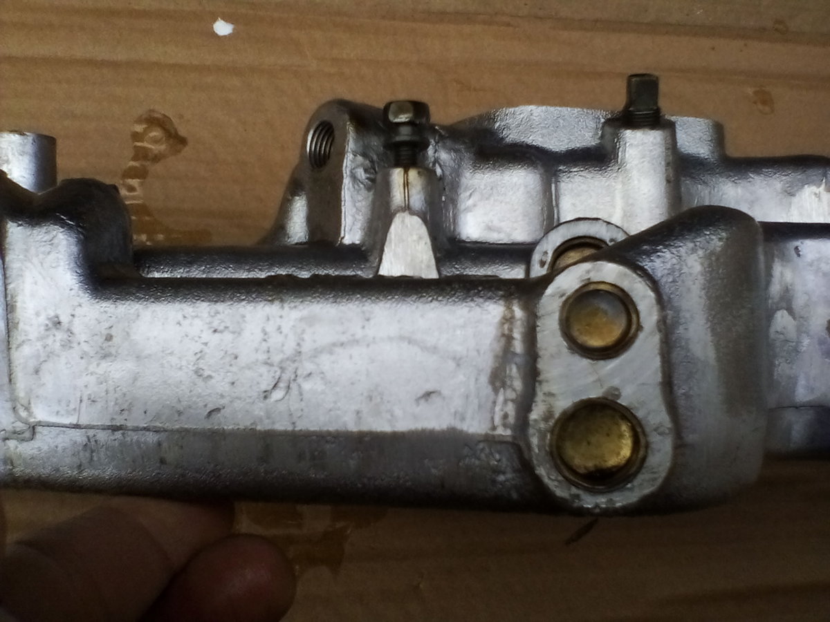

Also a shot of the two Welch plugs at the back of the water log. If you run ea82 mpfi na or turbo and not replaced these babies due to failure or dare I say - preventative maintenance '- you are fortunate something is still holding the rust together !
Cleaned out the EGR port from entry to exit. Can only say holy crud fujiman !
