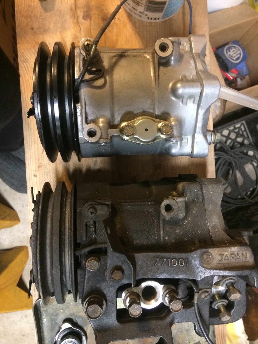

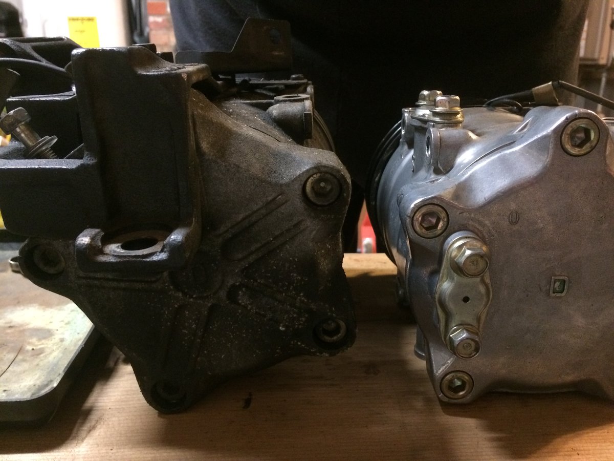

BEECHBM69 Posted August 9, 2018 Share Posted August 9, 2018 (edited) On 8/8/2018 at 2:39 PM, czny said: The comp I have here is a MJS170 6DP, 2 groove pulley. 5 sided(pentagonal) rear discharge cover. Minus the pulse pickup & bracket. Tested the clutch & its good. Let me know & if not I'll put it up for adoption in the parts section. Matsushita = Panasonic. Not to be a pain, but if this means what I think it means, it won't work in his application. The bracket will be right about where the discharge is. It's the same one I got sent the first time. If by rear you mean the side of the back cover then I sincerely apologize. Dan On edit: Pictures attached. Edited August 9, 2018 by BEECHBM69 Link to comment Share on other sites More sharing options...
czny Posted August 9, 2018 Share Posted August 9, 2018 Dan, it looks just like the lower used one with brackets attached in your picture. If you still have that one you could maybe unbolt the rear cover & turn the discharge port to up position where it belongs(?) If you don't want to void the warranty then tell the rebuilder what orientation the ports must be in. 1 Link to comment Share on other sites More sharing options...
BEECHBM69 Posted August 9, 2018 Share Posted August 9, 2018 3 minutes ago, czny said: Dan, it looks just like the lower used one with brackets attached in your picture. If you still have that one you could maybe unbolt the rear cover & turn the discharge port to up position where it belongs(?) If you don't want to void the warranty then tell the rebuilder what orientation the ports must be in. They made it right when I showed them what I had. The stock photo in the add was like mine, so I didn't think to specify (actually, I had no idea there was more than one back case ) Back of the back, vs side of the back. Glad it's all going to work out. Back to your deal already in progress with no further interruptions from me Dan Link to comment Share on other sites More sharing options...

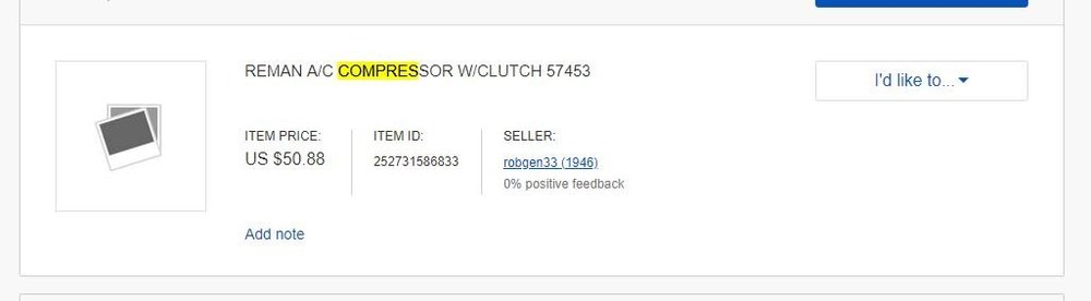

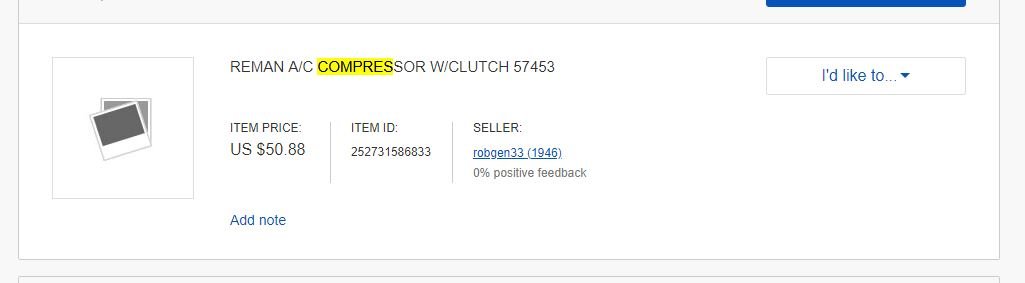

BratshitCrazy Posted September 5, 2018 Share Posted September 5, 2018 Dan, I'll sell it for $50 plus actual cost of shipping (cheapest available). I paid $50 for it myself (my transaction record from ebay is attached). Link to comment Share on other sites More sharing options...
