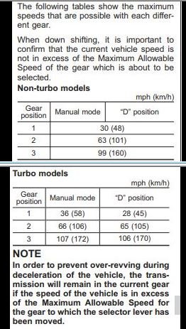

wtdash Posted August 3, 2018 Share Posted August 3, 2018 (edited) Disclaimer: have not driven any Subaru this new w/the 4EAT or 5EAT. Assuming this is a NON-turbo? Not an XT, correct? I'd start w/the AT service - up to date? You're in the high country so you're down on power anyway you look @ it, but I wouldn't expect 2nd to be 'that' bad. I'm confused as to why it wouldn't shift to 3rd in the mtns...see attached shows that 3rd should be good to 99 MPH (assuming that's Redline). SOHC Boxers have a pretty flat torque band, so it shouldn't have a high RPM 'kick' like a DOHC or turbo. You could try resetting the ECU/TCU by unplugging the Neg battery for 30 minutes (NOTE: you'll lose your radio presets, MIGHT have to re-program your keyless fobs, etc.). This doesn't 'fix' anything but If it runs better/different initially then you may a problem....it'll revert back to the same behavior after a few miles. But these are generally reliable transmissions. Go test drive another Subaru w/the same trans for comparison? Edited August 3, 2018 by wtdash 1 Link to comment Share on other sites More sharing options...
