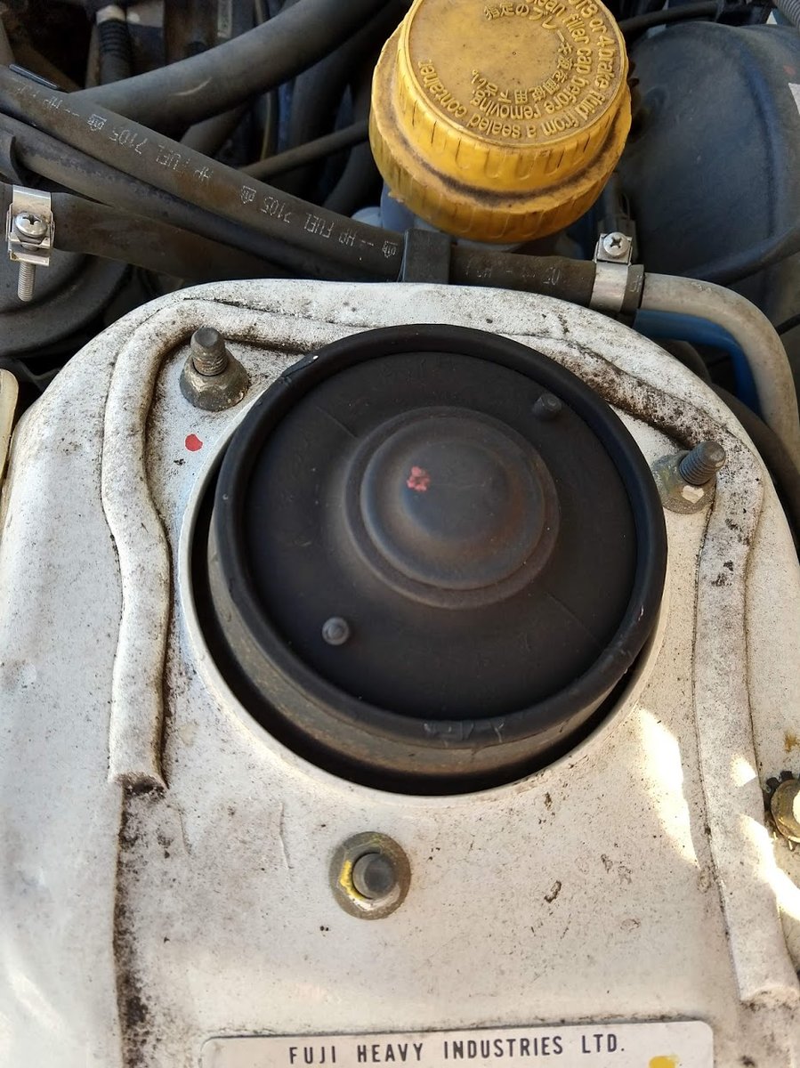

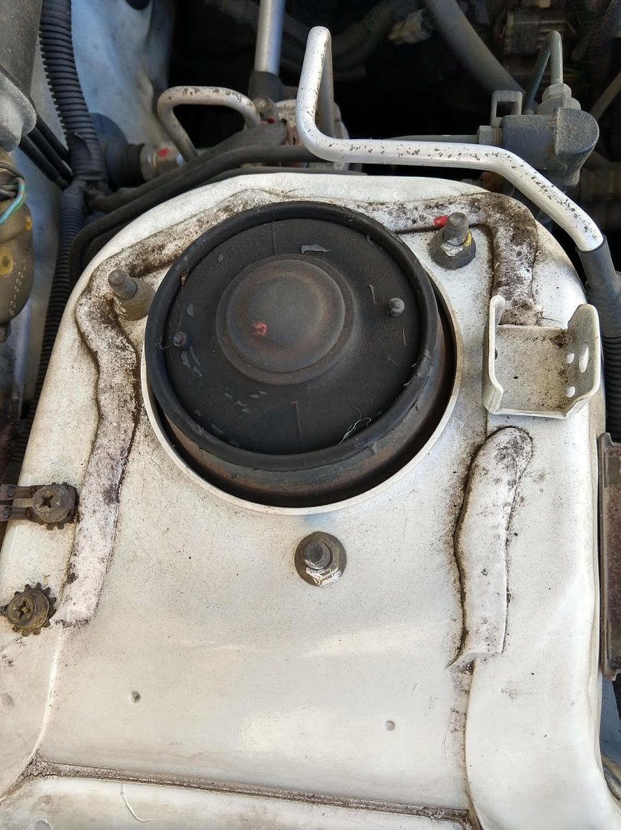

cgates30 Posted August 4, 2018 Author Share Posted August 4, 2018 I'm thinking mine look pretty good... Wow, 330K, that would never happen on my other car. I have a BMW 530i (e39) and at 150k miles they were pretty much shot. Of course, it's a much heavier car with a large engine sitting up front. Link to comment Share on other sites More sharing options...
heartless Posted August 4, 2018 Share Posted August 4, 2018 LOL - you can not tell just by looking at them.. you need to disassemble and check the bearing itself if it rotates smoothly with no binding, no slop, no crunchiness or notchy feeling then yeah, it is fine. but if there is ANY slop, binding, or anything other than smooth movement it needs to be replaced. As an example - the other half has a 2006 LL Bean Outback with around 180K that we just put new struts in... the top mounts "looked" fine, but once we had things apart it was VERY obvious the one was completely shot, there was a lot of slop in the bearing.. 1 Link to comment Share on other sites More sharing options...
idosubaru Posted August 4, 2018 Share Posted August 4, 2018 You have to remove it and check condition. Ive never tried but you could try to jack the wheel off the ground and see if you can get any diagnosis by moving and loading the strut or even unbolt it from the knuckle and do the same It is unfortunate to not know until the strut us disassembled another option is to buy two struts mounts from somewhere that would let you return them if they’re not needed Then you have them on hand but onky replace if needed Link to comment Share on other sites More sharing options...

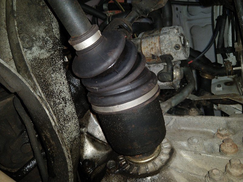

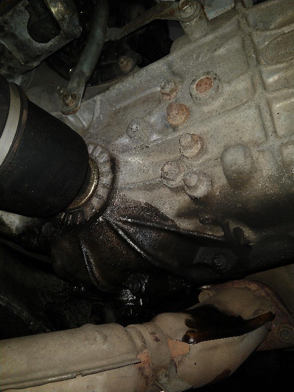

cgates30 Posted August 6, 2018 Author Share Posted August 6, 2018 While taking a look at the suspension components, I got a better view of the front differential. Looks like it is leaking on both sides. In the records I have, it looks like they changed the gear oil ~50k miles ago. Link to comment Share on other sites More sharing options...
idosubaru Posted August 6, 2018 Share Posted August 6, 2018 11 hours ago, cgates30 said: While taking a look at the suspension components, I got a better view of the front differential. Looks like it is leaking on both sides. In the records I have, it looks like they changed the gear oil ~50k miles ago. You may have just captured your issue, that looks like an aftermarket axle, unless the grease covered inner joint is deceiving me. Aftermarket axles are notoriously problematic, I would replace them even if they are not making the noise. They're not long time reliable components, they're risky trash for penny-wise-dollar-dumb time wasters and used car flippers. You could alternately pull the boots back and clean and regrease them. More than likely they didnt' have enough grease or it's watery and degraded and knocking...or it's one of those and the joint is a trashed POS, that's no surprise either. You would want to concentrate on the inner joints - they're the ones that have the exact symptoms you're describing when they lack (good) grease. But for my time and money I'd just throw those away and get Subaru OEM axles. $15-$35 all day long on car-part.com or local yards. buy one, clean it, reboot it. i've rebooted open-boot, dirty as #(!)%* knocking, clicking Subaru axles and never had an issue, they've all quieted right up with no failures. i've had multiple brand new aftermarket axles blow apart within 50 miles (one was less than 100 yards that was awesome) and have multiple other issues besides that. which is funny because I spend way more time and miles with OEM so I should see more OEM failures...but nope, it's the aftermarkets blowing away the competition...quite literally. 1 Link to comment Share on other sites More sharing options...
idosubaru Posted August 6, 2018 Share Posted August 6, 2018 check your diff (and other) oils and make sure that's loosing fluid. it does appear to be the case but other leaks can drip/blow back to that same rearward/central location so best to verify. 1. be very careful changing those diff side seals - it's a very precise process and not getting it right will mean you need a new transmission. the retaining rings has to be returned to the exact same number of turns and precise location it's currently installed or the bearing pre-load/ring and pinion backlash will be lost and you'll need a new transmission. 2. if you have issues present (thumping) after a significant job (strut replacement) - then more than likely the issue is due to the work done. So those struts and the associated work done during that time needs backtracked and checked. 3. ***Can you tell which "side" is more prevalent? Like is it more likely to do it on the left or right - when you hit a bump on the right (but not the left) or the left (but not hte right) - are the symptoms still identical no matter what? 4. *** Do the symptoms change at all if you encounter the same situation driving straight or while turning? If it makes the noise in a certain situation - will it make that exact same noise under the exact same situation while turning left, driving straight, and turning right? Link to comment Share on other sites More sharing options...
