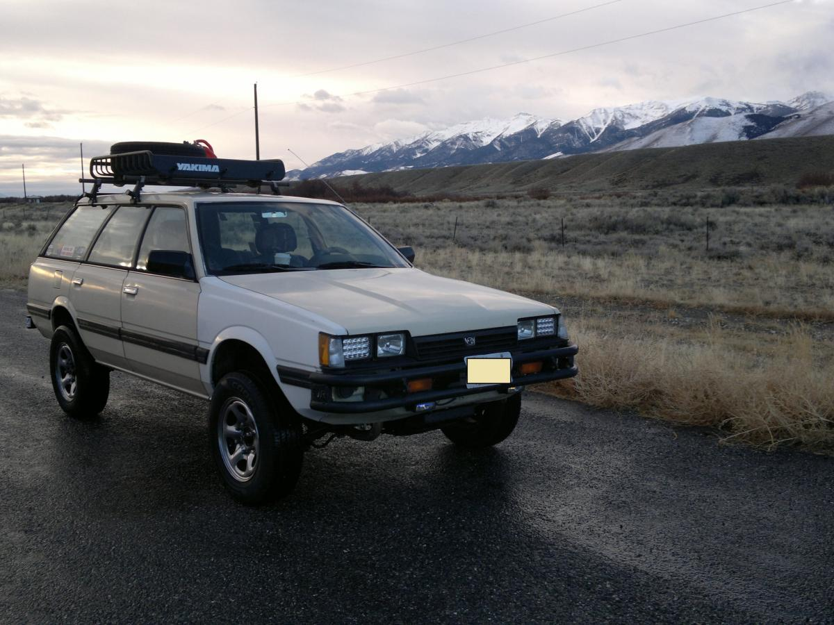

image.thumb.png.7b659896000737918e8ca618d42a106c.png              Corner marker lights with pigtails, headlight buckets, headlight retainers & hardware, grill, lower headlight valance pieces & valance. Relays plus 4 headlight connectors. Some wire of course. Suppose you could get the complete front harness & do it that way.
Wired mine so LED low beam is outers only, LED high beam is outers & halogen inners, fog lights are halogen inner low beam + fogs with separate switch. Was lucky enough to find an OEM fog light switch at a PNP yard. Headlight switch in turn signal assembly activates relays that are powered directly from fused battery source under hood.
