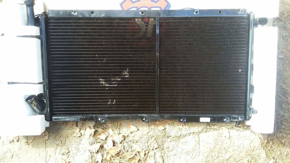

I am a little bit... but not so much. Since the head gasket job a couple yrs back. And replacing the stock rad with a supposedly new CSF RAD and factory Oem thermostat.
Think I need to dial back the timing a smidge to stop the pinging. Get close to the red zone but it always drops back on the other side after climbing longass hills.. here is a complaint I left for CSF them on Facebook that I never got a reply lol!
https://m.facebook.com/photo.php?fbid=1003055443105370&id=100002027723629&set=o.129092457127268&_rdr
Edited by Len Dawg
Added a link
