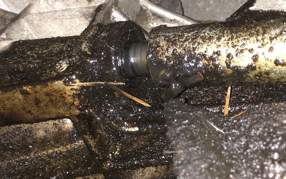

ErikAnderson Posted August 22, 2018 Author Share Posted August 22, 2018 So here are some updates. I can get it to shift pretty good if I pump the clutch. I had a lot of deadband in the pedal and took most of it out. The underside where the shifting mechanism goes into the transmission looks awful, oil and slime everywhere. I kinda want to drop the transmission since I have a new clutch just sitting around. Do these cars have a clutch master or slave cyl? Is it located inside the transmission? Im going to change the clutch on my WRX here in a few weeks so I may as well get back into practice. Link to comment Share on other sites More sharing options...
ErikAnderson Posted August 22, 2018 Author Share Posted August 22, 2018 Link to comment Share on other sites More sharing options...
el_freddo Posted August 22, 2018 Share Posted August 22, 2018 Cable clutch. Not hydro. The wrx clutch is a whole different kettle of fish! Cheers Bennie Link to comment Share on other sites More sharing options...

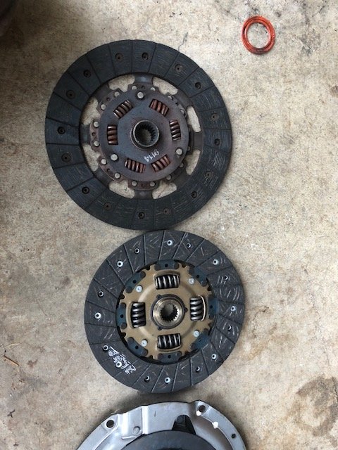

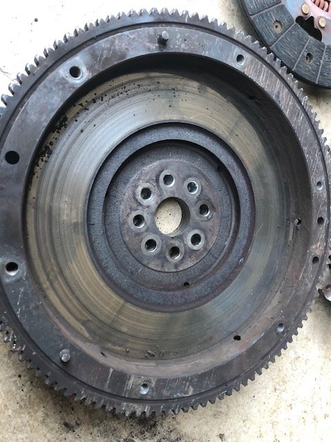

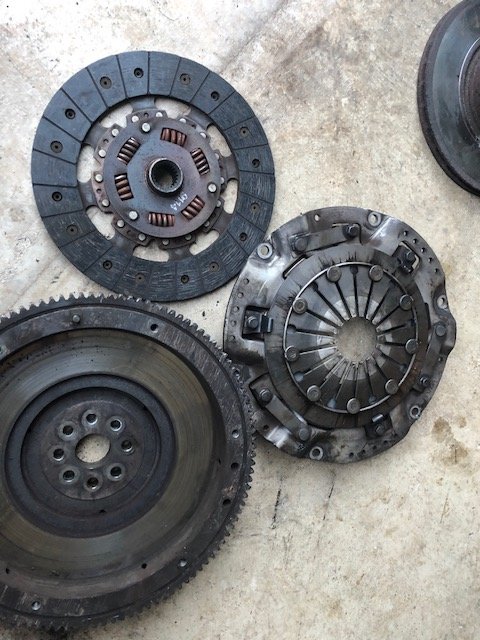

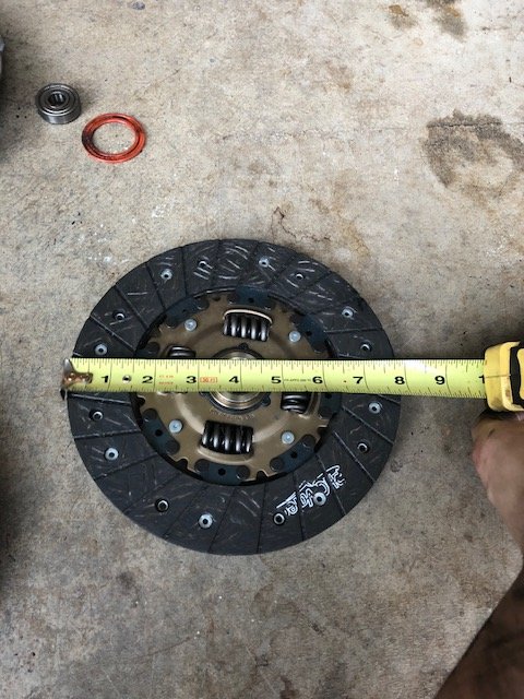

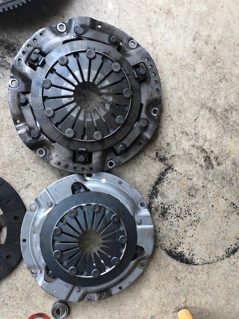

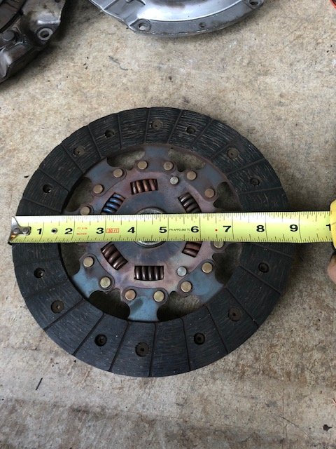

ErikAnderson Posted August 28, 2018 Author Share Posted August 28, 2018 Pulled the transmission. The replacement clutch I have is the wrong size even though online it says it’s a match. Existing clutch disc is around 9” replacement is 7 7/8” the pressure plate is quite smaller as well. A bit frustrated right now. Any ideas? When I look up clutch info it keeps giving me this 7 7/8 size. Gonna resize some pics and stop for the day. Tomorrow I’ll just start degreasing everything. Link to comment Share on other sites More sharing options...

el_freddo Posted August 28, 2018 Share Posted August 28, 2018 There are two different clutch sizes for the MY series. Typically the smaller is the 2wd and I believe the early 4wd unit. I can't see anything wrong with that pressure plate going by the pics but that doesn't mean much. Have you had time to look at the other components in the clutch system? Cheers Bennie Link to comment Share on other sites More sharing options...
ErikAnderson Posted August 28, 2018 Author Share Posted August 28, 2018 Okay I see that now. I must have picked this clutch up for my 2wd DL years ago. Thought I could get lucky. Oh well. Heh, anyone want to trade??? I’ll start cleaning and inspecting stuff this week as it’s clear I’ll not be ready to install anytime soon. Lets talk transmission guts? I’m a technician but not an automotive one. If I open that transmission: a) with the availability of parts for these cars will I be able to actually repair anything. B) will I bite off more than I can chew from the moment I open it? I have access to a pretty stocked factory shop and some smart folks if I need to. What do your folks suggest? Link to comment Share on other sites More sharing options...
