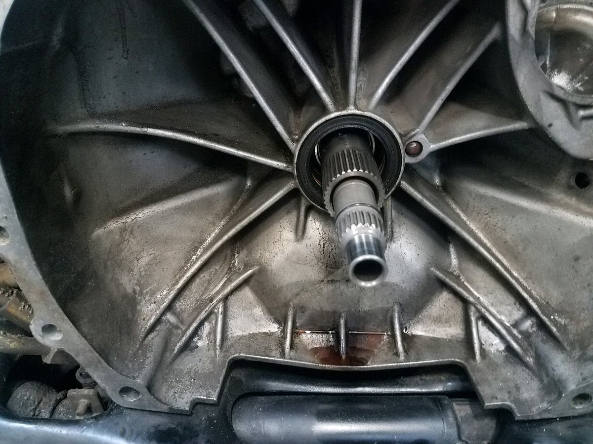

steve56 Posted August 22, 2018 Author Share Posted August 22, 2018 33 minutes ago, GeneralDisorder said: I think you not understanding which part we are talking about. In that diagram the pump drive is #7. It's a hollow tube about 2" in diameter. You need to fish it out of the trans. GD Yes I'm defiantly confused. Here's a pic looking down the shaft into the trans. Can the tube be seen from this pic Link to comment Share on other sites More sharing options...
GeneralDisorder Posted August 22, 2018 Share Posted August 22, 2018 (edited) Yes it's the tube surrounding the stator splined shaft in the pic. You will need a 90 degree pick tool to pull it out where you can get at the wire clip, etc. You can grab it by the raised notches that interface with the TC tube. GD Edited August 22, 2018 by GeneralDisorder Link to comment Share on other sites More sharing options...

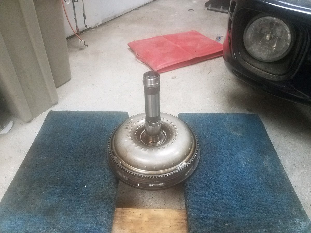

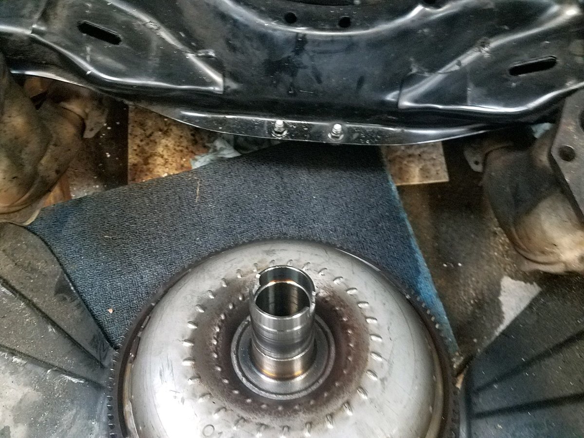

GeneralDisorder Posted August 22, 2018 Share Posted August 22, 2018 Here's a pic of the shaft in question: GD 1 Link to comment Share on other sites More sharing options...
steve56 Posted August 22, 2018 Author Share Posted August 22, 2018 2 minutes ago, GeneralDisorder said: Here's a pic of the shaft in question: GD Link to comment Share on other sites More sharing options...
steve56 Posted August 22, 2018 Author Share Posted August 22, 2018 Thanks GD. Appreciate your knowledge and help. Link to comment Share on other sites More sharing options...

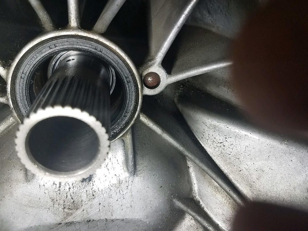

steve56 Posted August 23, 2018 Author Share Posted August 23, 2018 Hi GD. Got the tube out of trans and installed on torque converter with the retainer clip. When I reinstall the oil pump shaft, how far should it be sticking out measuring from the trans seal? It usually is sticking out 4 1/2 inches. but sometimes stops at 4 inches and 5 inches out from the seal. Link to comment Share on other sites More sharing options...
GeneralDisorder Posted August 23, 2018 Share Posted August 23, 2018 You mean the input shaft? The "pump shaft" is the tube...... I've never measured I just push them in till they are seated. Whatever the shortest measurement is I would say. GD Link to comment Share on other sites More sharing options...
steve56 Posted August 23, 2018 Author Share Posted August 23, 2018 1 hour ago, GeneralDisorder said: You mean the input shaft? The "pump shaft" is the tube...... I've never measured I just push them in till they are seated. Whatever the shortest measurement is I would say. GD Yes I meant input shaft. Have the pump shaft connected to the TC with retainer clip. Should I pull the input shaft back out of trans and reinstall the TC, pump and input shaft together as one unit or reinstall the input shaft separately? Link to comment Share on other sites More sharing options...
