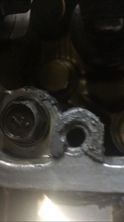

Winterpie0220 Posted August 27, 2018 Author Share Posted August 27, 2018 I’m gonna tear into that pretty soon, but another issue that I have is I broke the thread housing on my cylinder head when attaching my valve cover. Everyone at my work says I need to replace the whole head. But performance wise it’s running great. Is there a way to repair the thread to eliminate the headache of basically doing a whole new top end job? Link to comment Share on other sites More sharing options...
DaveT Posted August 27, 2018 Share Posted August 27, 2018 Is the thread just stripped, or part of the casting broken off? Link to comment Share on other sites More sharing options...
Winterpie0220 Posted August 27, 2018 Author Share Posted August 27, 2018 Casting is broken off. (Sigh) Link to comment Share on other sites More sharing options...
DaveT Posted August 27, 2018 Share Posted August 27, 2018 Got any pictures of it? The broken part of the head. Link to comment Share on other sites More sharing options...
GeneralDisorder Posted August 27, 2018 Share Posted August 27, 2018 You need to replace the camshaft carrier, not the head. GD 1 Link to comment Share on other sites More sharing options...

DaveT Posted August 28, 2018 Share Posted August 28, 2018 If you don't have pictures, which side, and which bolt tab is broken off? Link to comment Share on other sites More sharing options...
Winterpie0220 Posted August 28, 2018 Author Share Posted August 28, 2018 I had tried to jb weld it back together. It didn’t work. It’s the lower left valve cover bolt. Link to comment Share on other sites More sharing options...
idosubaru Posted August 28, 2018 Share Posted August 28, 2018 i'd entertain thoughts of addressing this without pulling the cam carrier... a small tack of tig welding? A bead of sealant...The Right Stuff?... along that bottom edge? google it - someone has gotten creative with broken ears and tabs before even if it's not an EA engine...? Link to comment Share on other sites More sharing options...
GeneralDisorder Posted August 28, 2018 Share Posted August 28, 2018 Welding that dirty cast aluminium with JB contamination isn't an option without removing it from the engine bay. Might as well replace it. The EA82 doesn't have enough valve cover bolts to not leak without one of them. Even a dual cam EJ will leak without one of the corner bolts. Shouldn't be too hard to find a cam carrier from a core motor. Perfect reason to do an EJ swap - or just buy a car with an EJ that you can actually get parts for. The EA82 is a dead platform for anyone but those with many parts and parts cars. GD Link to comment Share on other sites More sharing options...
DaveT Posted August 29, 2018 Share Posted August 29, 2018 1st choice, replace. MAybe a piece of aluminum could be fabricated that would attach under the bolt to the left, and have a threaded hole. But that's a big maybe. Problem is, it's probably as much work to do that as replacing the carrier. What's left of the casting would have to be cut out so a decent piece of metal could be put there. I wouldn't want to try that with the engine in the car. No "glue" is going to stick to oiled metal. And endure the heat cycles. Welding cast anything is a complex process involving controlled heating of the entire piece, and controlled cooling. Link to comment Share on other sites More sharing options...
GeneralDisorder Posted August 29, 2018 Share Posted August 29, 2018 (edited) Any good cylinder head shop could fix that easily. Probably for less than $100 Not worth it though. It's about knowing the right people. I could have that fixed for a few beers. But I wouldn't bother my highly skilled friends with such nonsense. And the only reason I could do that is I pay for their services often and typically pay them more than they ask. So when I need a favor.....which is rare. Honestly I would just spend the time and effort on something newer and/or more deserving of the effort. EA82's are worth so little that if you don't pay someone to haul them away you are a damn criminal. GD Edited August 29, 2018 by GeneralDisorder Link to comment Share on other sites More sharing options...

idosubaru Posted August 29, 2018 Share Posted August 29, 2018 the car doesn't need a head or headgaskets - so that means the engine doesn't have to come out - which means you don't "need" to replace the clutch if that was only preventative due to the perceived head removal/job that you thought you needed, but don't. so if the car is reasonable enough that you just need the cam carrier, timing belts, and struts - that's all nominal maintenance stuff really that any used car will need so it could be worth fixing. if you need much more than that then an EJ swap or selling it and getting into an early legacy which is super reliable and easy to work on/get parts for looks financially attractive over the long haul. alternately - pull the valve cover and slather The Right Stuff on there really good and bolt it together. that should get you by for a year or two and you can save and plan your next attack and set yourself up for a good 5+ year plan that saves you money and keeps your reliable. good decisions now, pay off later. Link to comment Share on other sites More sharing options...

Winterpie0220 Posted August 30, 2018 Author Share Posted August 30, 2018 That’s my plan eventually. I’m a poor college student at the moment, so an ej swap although tantalizing is kind of out of the question for me financially. My plan is to keep the ea82 until I graduate (or later) lol. I’m in the process of pulling the motor cause it needs seals and gaskets anyways. I’m gonna have to pull the heads anyways to get them machined, and a shop in town said they could probably fix the head thread anyways. So that’ll knock out two birds with one stone (hopefully). And hopefully by doing that it’ll buy me time to save up for the motor swap and other issues. (There’s quite a few of them). Lol. So if and when I do the 2jz swap, will that make the 4wd useless? Or will it just be awd? Link to comment Share on other sites More sharing options...
