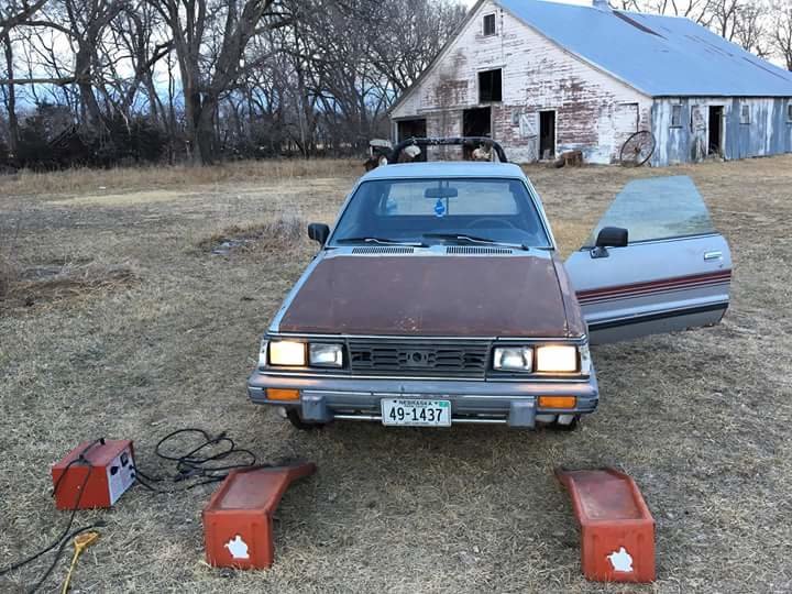

Subarute1984 Posted August 31, 2018 Author Share Posted August 31, 2018 Thanks to everyone. Need to get her in good running order before the end of september. Heres a pic if you guys are interested. Shes a little rough but only 92k miles. 1 Link to comment Share on other sites More sharing options...
