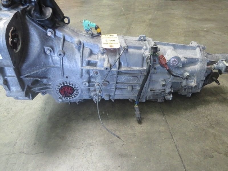

suprunner Posted September 6, 2018 Share Posted September 6, 2018 (edited) Hi all, I am about to throw my SOHC 2.5/DOHC 2.5 frankenmotor into a '98 outback in pretty great (cosmetic) condition.... but it is 200,000 miles. I have gone through about 4 different 5mts in the past 6 years... All were cheap, but all were high mileage. I'm planning on purchasing a transmission that came out of the '05 Legacy GT wagons... Transmission code: TY757VBAAB... The gear ratios look to be a dream! With my wheel/tire choice, I can be at 3000 rpm and going 75 mph down the interstate and thus keep very good fuel economy. My problem though... In the picture of the transmission that I'm looking at, there doesn't appear to be a speedo-sensor installed... There is a plug circled in orange... Anybody have a guess if there will be a speedo gear in there when I take the plug out? If not, I'm assuming that I'd have to split the case halves to install? Just a matter of spending the time to do so? Unfortunately I'm not in a position to get this information as the transmission is coming from an online auction source. Supposed to be at about 50,000 miles. I guess I could go without a speedometer, and just memorize the tachometer-to-gear-ratio-to-wheel-size speeds off of a chart... I figure it'll last much longer behind a NA motor versus turbo... http://www.rallispec.com/downloads/Transmission ID Chart_Public.pdf http://www.gearhack.com/myink/ViewPage.php?file=docs/Subaru Transmission Chart Thanks all, Greg Edited September 6, 2018 by suprunner more info Link to comment Share on other sites More sharing options...

Numbchux Posted September 8, 2018 Share Posted September 8, 2018 Those cars use the ABS sensors to run the speedo, AFAIK there's no shaft or gear in there. BUT, I do believe the 3-4 gear is cut to accept one, so you'd "just" have to split the case, and install the shaft, seal, and gear to accept a cable. And yea, you'll have a few negative running characteristics without a VSS. Link to comment Share on other sites More sharing options...
GeneralDisorder Posted September 8, 2018 Share Posted September 8, 2018 You just need to wire in a VSS Pro from The DCCD guys. Works off the wheel speed sensor: https://www.dccdpro.com/product/vsspro/ GD 1 Link to comment Share on other sites More sharing options...
suprunner Posted September 9, 2018 Author Share Posted September 9, 2018 9 hours ago, Numbchux said: Those cars use the ABS sensors to run the speedo, AFAIK there's no shaft or gear in there. BUT, I do believe the 3-4 gear is cut to accept one, so you'd "just" have to split the case, and install the shaft, seal, and gear to accept a cable. And yea, you'll have a few negative running characteristics without a VSS. Is “VSS” a vehicle speed sensor? Why would I have issues if I installed a speedo gear wouldn’t that take care of it? I’d rather split the case then actually replace transmissions these days.. Link to comment Share on other sites More sharing options...
wtdash Posted September 9, 2018 Share Posted September 9, 2018 (edited) Quote I guess I could go without a speedometer, and just memorize the tachometer-to-gear-ratio-to-wheel-size speeds off of a chart. We're responding to this comment....if you put in a VehicleSpeedSensor (the correct one for your car), this wouldn't be an issue. Edited September 9, 2018 by wtdash Link to comment Share on other sites More sharing options...

suprunner Posted September 9, 2018 Author Share Posted September 9, 2018 23 minutes ago, wtdash said: We're responding to this comment....if you put in a VehicleSpeedSensor (the correct one for your car), this wouldn't be an issue. Perfect! I am excited then. Link to comment Share on other sites More sharing options...
