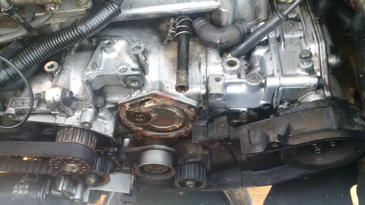

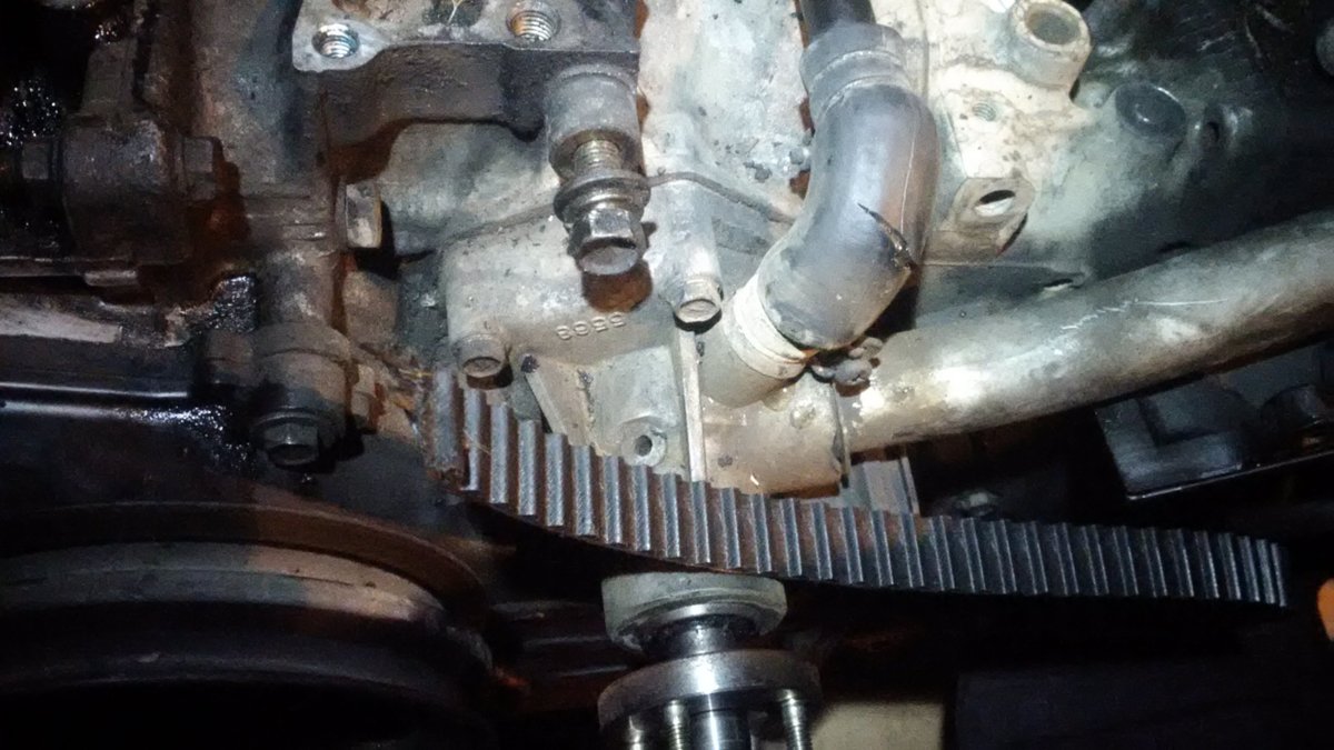

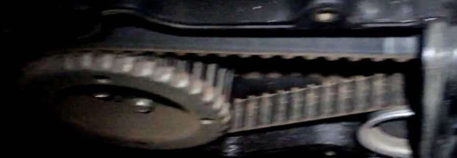

Craigar Posted October 24, 2018 Author Share Posted October 24, 2018 Got the AC out of the way, removed power steering, alternator and radiator. Then took off outside fronts of plastic timing chain covers - driver side has snapped AND 90 degree elbow rubber hose (going to pipe to heater) coming of water pump has a BIG SPLIT in it! I wouldn't be amazed if this isn't the original timing belts and the 90 degree elbow rubber hose. The broken timing belt has NO MARKINGS at all from what I can see of it so far, but the passenger belt looks like it may have 2 white alignment marks is that how the original belts are? Quote Link to comment Share on other sites More sharing options...
DaveT Posted October 24, 2018 Share Posted October 24, 2018 Original belts are marked Subaru. I have never had a belt go more than 70k miles. Usually, expect a lot less. I have been running ea82 engines since 1988. The idler bearings are not good for much more. If the hose clamps are the oem wire ones, that hose is probably original, and that is way too long to go before replacing the 7 hoses. Quote Link to comment Share on other sites More sharing options...
idosubaru Posted October 24, 2018 Share Posted October 24, 2018 The wire type clamps don't look like they're spaced/installed like factory new ones and the hose itself looks off - the bend and curved lips at the end past the clamps looks different. maybe it's the split hose/overheating/age/photo - but given the age and those small details i'd guess the hose isn't original...and unlikely original belts too. Quote Link to comment Share on other sites More sharing options...

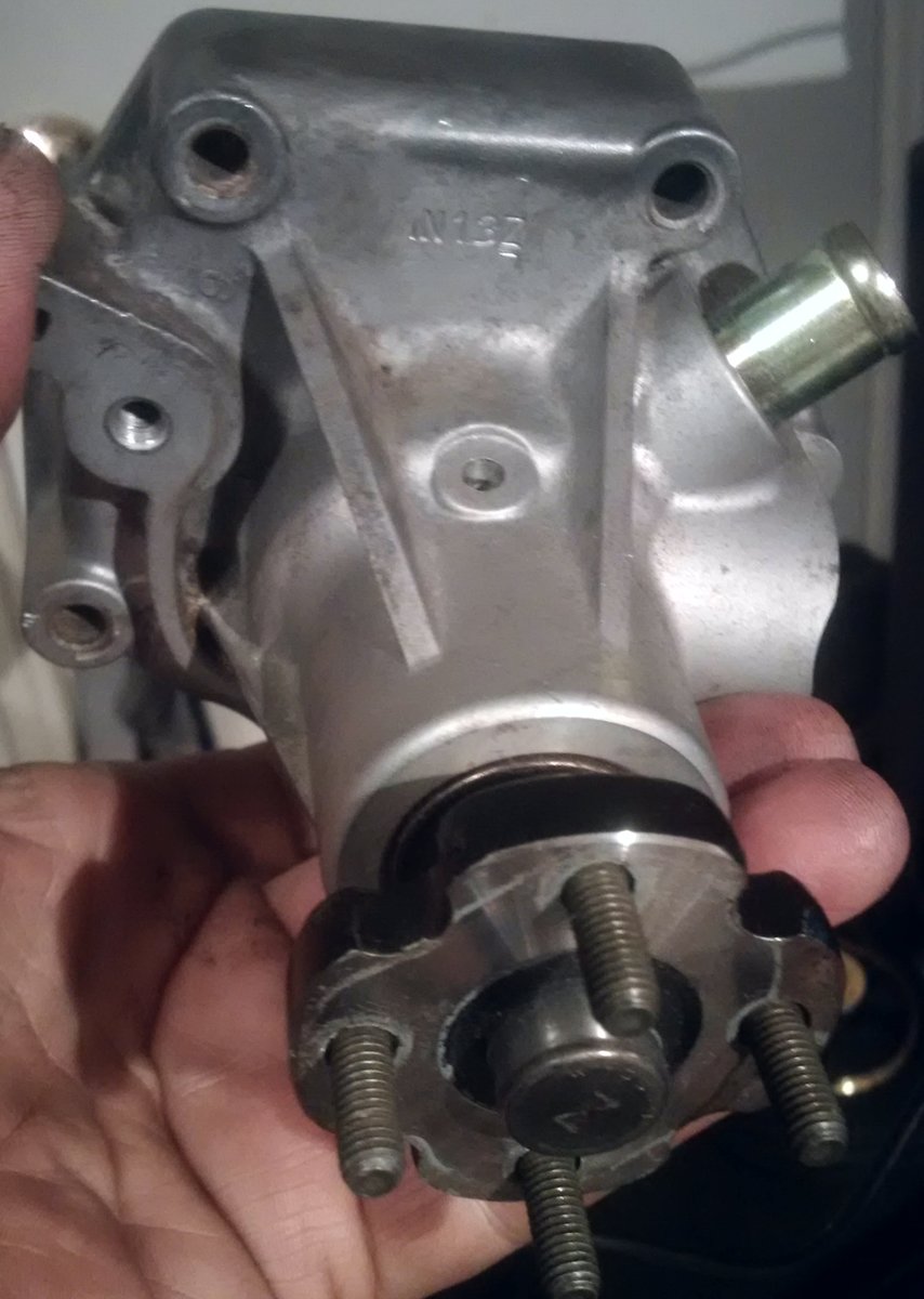

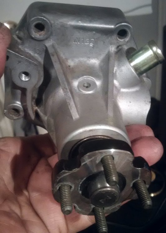

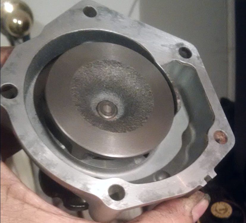

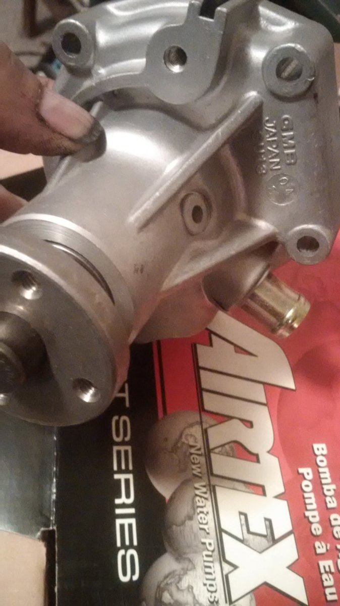

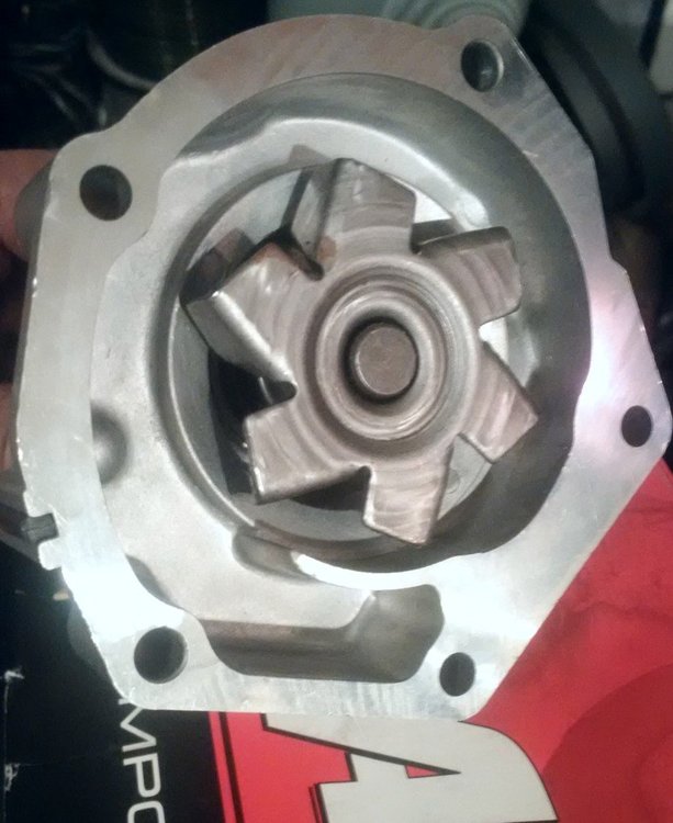

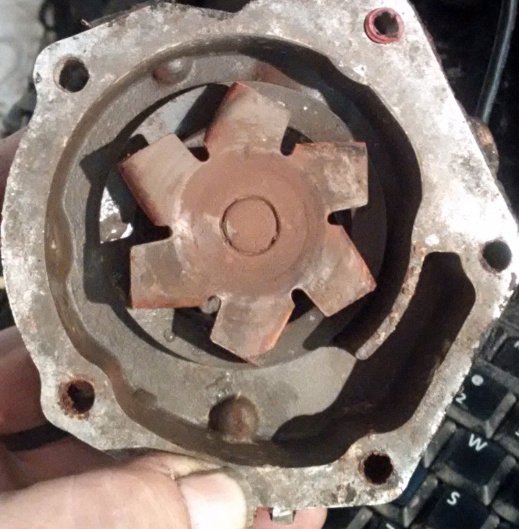

Craigar Posted October 25, 2018 Author Share Posted October 25, 2018 (edited) I've got a choice of TWO different pumps a can use - the one came from a member here, czny and he says it is used and works fine but looks like new to me - it has the cast impeller and the only markings are " N13Z " . I also bought a "brand new" one from Rockler that says "GMB Japan SU13 " with a stamped impeller. I can't easily decide which one use? Probably the new one ? Edited October 25, 2018 by Craigar image upload fighting with me ;) Quote Link to comment Share on other sites More sharing options...
Brianmitchtay Posted October 25, 2018 Share Posted October 25, 2018 Looks to me like either one will get the job done, I'm partial to any part that has 'Japan' on it since that's Fuji heavy industries' home turf, but that's probably just a logical fallacy. Good luck! Quote Link to comment Share on other sites More sharing options...
idosubaru Posted October 25, 2018 Share Posted October 25, 2018 If it looks OEM that’s preferable. Theres is preference between stamped and cast impellers but ive never seen either fail so I’m uncertain why that sentiment exists. Quote Link to comment Share on other sites More sharing options...
DaveT Posted October 25, 2018 Share Posted October 25, 2018 Get rid of the stamped one. The cooling system is the most important thing to keep in top condition. The stamped impeller cannot work as effectively as the cast one. It is cheaper to make, that is all. Quote Link to comment Share on other sites More sharing options...

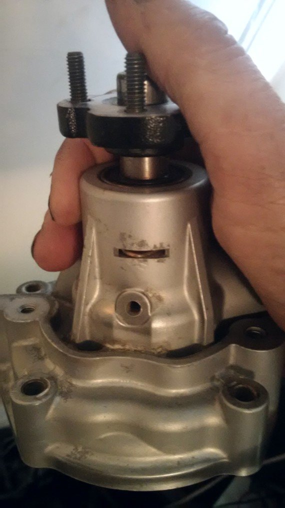

Craigar Posted October 25, 2018 Author Share Posted October 25, 2018 (edited) another "feature" I like of the cast impeller one is it has this "locking tab, I ASSUME?" pressed/punched in through this slot to prevent the shaft from moving horizontally? Also I would imagined the cast impeller should "macerate" most solid debris (including (if any) undissolved Barr's stop leak pellets I used) ? Edited October 25, 2018 by Craigar more details... Quote Link to comment Share on other sites More sharing options...
DaveT Posted October 26, 2018 Share Posted October 26, 2018 Flush the stop leak crud out thoroughly. Don't use it again. Quote Link to comment Share on other sites More sharing options...

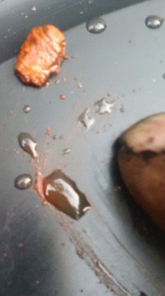

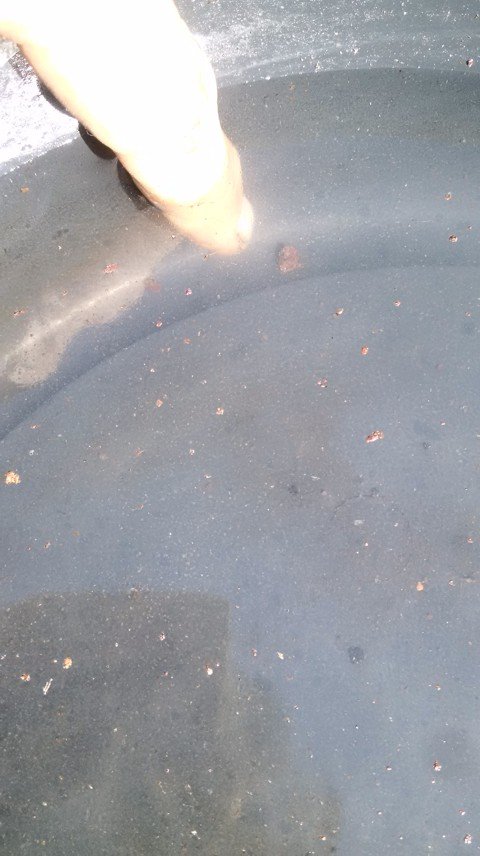

Craigar Posted October 26, 2018 Author Share Posted October 26, 2018 1st back flush of radiator with garden hose, moderate flow from garden hose 2nd flush, using full flow from garden hose no signs of "pellets" from Barr's stop leak - but some rusty looking little chunks. The water at full force had no noticable resistance going in, I just sealed it going in with my grip - seemed to come out of radiator as quick as going in Quote Link to comment Share on other sites More sharing options...
DaveT Posted October 26, 2018 Share Posted October 26, 2018 yes, run the water through backwards. Hose to the lower fitting. Hot wouldn't hurt, tends to loosen up stuff. Just don't allow pressure to go above 12 or so PSI, so loose / leaky connection. IF the radiator is not plugged, the flow capacity is a lot higher than the garden hose so no risk. Quote Link to comment Share on other sites More sharing options...
DaveT Posted October 26, 2018 Share Posted October 26, 2018 Sounds good, and looks like you got some junk out of there. Definitely do the engine and heater core. Quote Link to comment Share on other sites More sharing options...

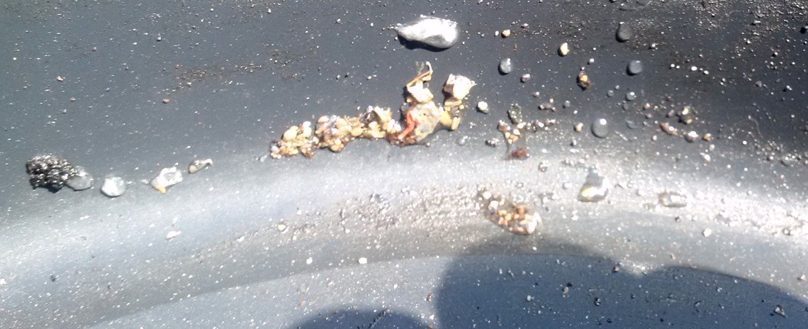

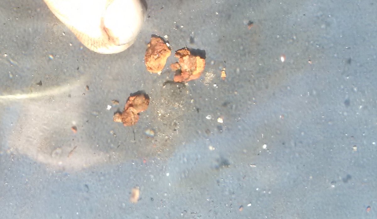

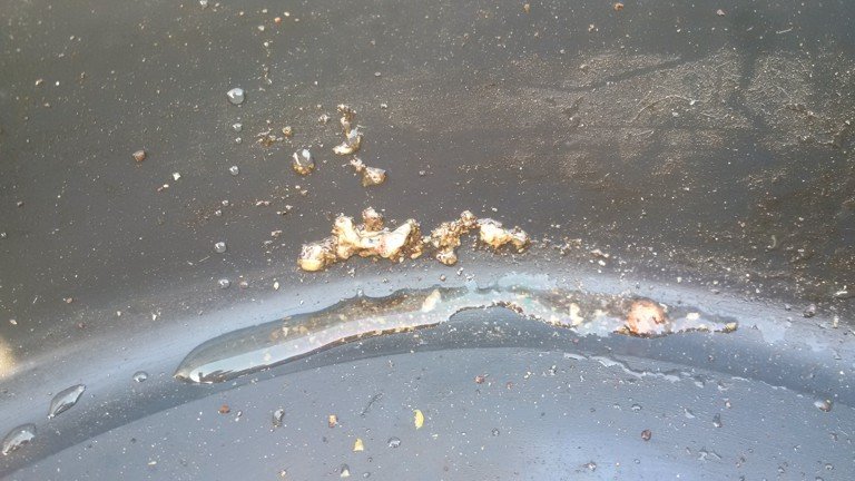

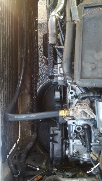

Craigar Posted October 27, 2018 Author Share Posted October 27, 2018 (edited) Pulled off good passenger timing belt and it's a Gates T300 U.S.A. - but the snapped driver side belt has no markings at all - maybe they didn't EVER replace it - and if it was stock original I'd think it would have "Subaru" markings? All the old idler pulleys are fine and spin smooth, but going to replace anyways. OK here's my setup for back flush starting at the the heater core, after I opened house water spigot all the way & ran back over to car, let kink out of hose and let water run through while holding hose nipple tight against heater core's return pipe - and exiting through the block via water pump opening .. probably would be "best" to seperate core from block & do both separately, but seems like so little junk overall that it's unnecessary for this around town commuter car. Junk from first back flush of heater core via block drain hole.. Junk from SECOND back flush of heater core and block via block drain hole.. "Raisin" looking junk (probably orange/red hi temp silicone - pretty soft) from SECOND back flush of heater core and block via water pump opening.. backside of old water pump - more surface rust on impeller then when pulled yesterday, lots of humidity right now) Edited October 27, 2018 by Craigar more details... Quote Link to comment Share on other sites More sharing options...
DaveT Posted October 27, 2018 Share Posted October 27, 2018 wow, lots of crud in there. Might be good to run it both ways. Quote Link to comment Share on other sites More sharing options...
