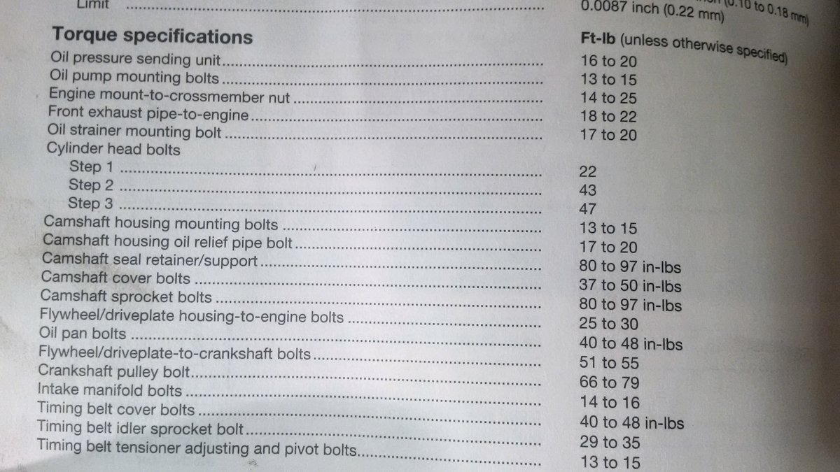

Craigar Posted November 2, 2018 Share Posted November 2, 2018 (edited) that's what this "Haynes Manual 890003 (681) pg 2B-2 ©1998" says and I'm probably up to 10~11 and it feels tooo tight - should I go all the way? These are 10mm bolts with M6 thread going into the aluminum block? Here's the page out of a Haynes manual I'm going from also VERY LEARY that I couldn't find the torque specs for these bolts in either part 1 or 2 of the online 1986 Subaru Subaru EA-82 Service Manuals at http://jdfinley.com/file-downloads/subaru-manuals/ all the engine specs are in 1st manual "Engine section 2-3" page 11-16 and oil pump details are in section 2-4 page 8 has torque specs and the ONLY THING that gets 13-15 foot pounds is the nut the holds on the sprocket - and I think it's a 12 or 13mm nut going onto a steel shaft - no reference to the oil pump housing bolts (except verbal saying assembly is reverse of dis-assembly)? I've also really searched through the topics & posts in this forum. Thanks! Edited November 2, 2018 by Craigar more details & links Quote Link to comment Share on other sites More sharing options...

naru2 Posted November 2, 2018 Share Posted November 2, 2018 I think Haynes meant Newton metres not ft lbs. Standard torque for a 6mm bolt(w/a 10mm head) is 12-15 Nm or 9-11 ft lbs. 3 Quote Link to comment Share on other sites More sharing options...

Craigar Posted November 2, 2018 Author Share Posted November 2, 2018 Thanks Everybody! Thank You GeneralDisorder for the "low down" - it does NOT appear to be stated in the online Subaru manual ( or the 1990 FSM that BEECHBM69 looked through) so I'll say this "Haynes Manual (890003 (681) " is flat out INCORRECT about this (IMHO) . I would say 95% of all DIY's that follow that Haynes manual torque spec here will strip those holes! Love their line "Every manual is based on a complete teardown and rebuild.."Here's the cover of the manual. Thanks again, maybe I didn't go too far already (those holes would be really fun to repair with the motor still in the car) Quote Link to comment Share on other sites More sharing options...
Dee2 Posted November 2, 2018 Share Posted November 2, 2018 I wonder how many people have been screwed over by that little typo ...... clearly the reference should be as you stated, for the oil pump drive sprocket. Quote Link to comment Share on other sites More sharing options...

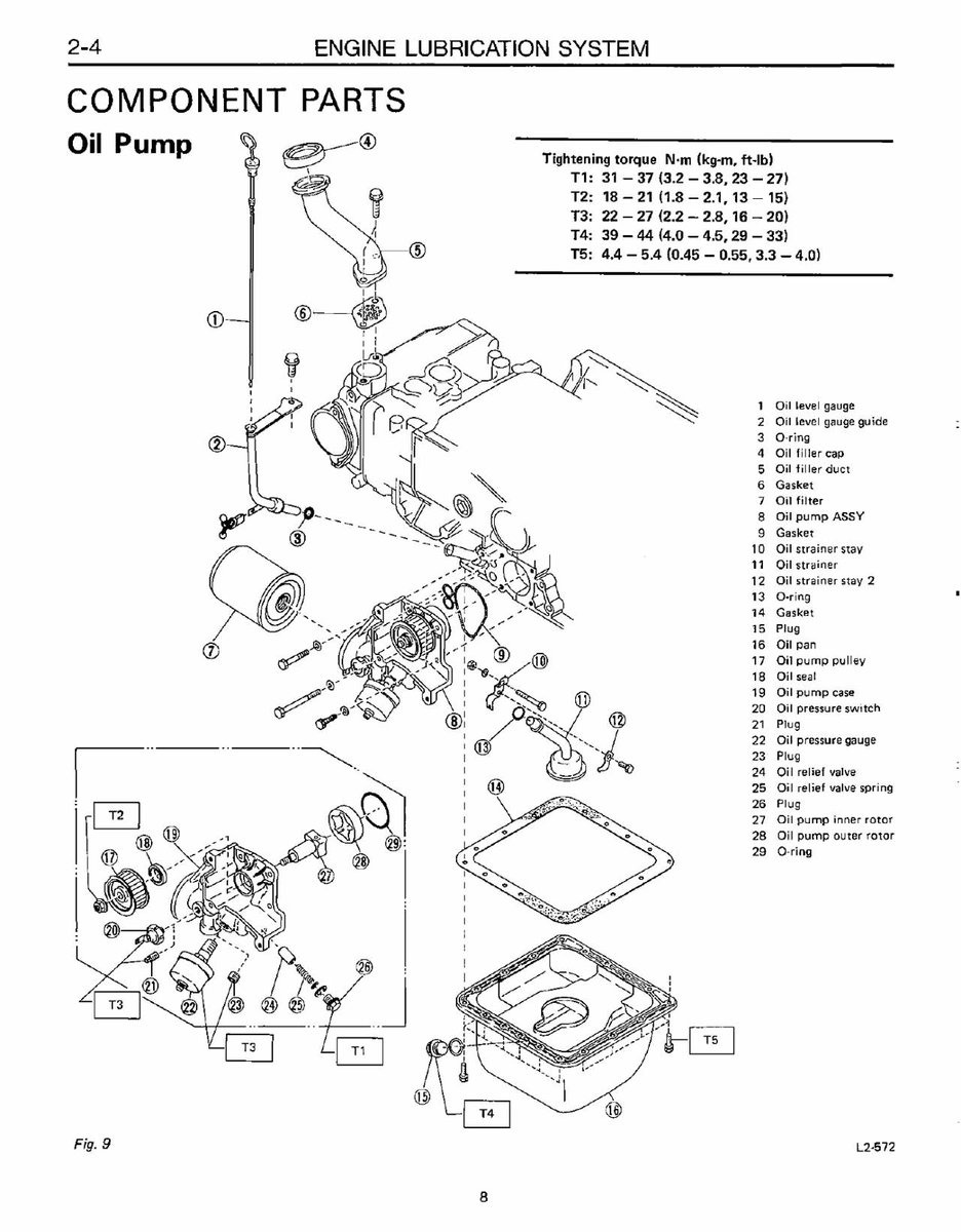

Craigar Posted November 3, 2018 Author Share Posted November 3, 2018 (edited) Thanks Dee2, got me thinking - and "to top it off.. pun intended" the Haynes DOESN'T mention the torque at all for that oil pump drive sprocket nut! Here's the page from the "SubaruEA82-ServiceManualPart1" that does.. They refer to that nut as "T2" Edited November 3, 2018 by Craigar Quote Link to comment Share on other sites More sharing options...
