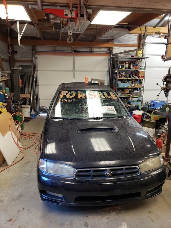

98GT Posted November 8, 2018 Share Posted November 8, 2018 (edited) Here's the skinny. The engine in my son's 98 Legacy continues to overheat after we did a short block rebuild. I have done all that I can think of to do as to figuring out what is causing it. The car warms up at idle-2000rpm just fine and cycles the fan and thermostat normally. But when I take the car out on the road, after several minutes, the gauge starts to climb and the upper hose gets swollen and really hot, while the lower hose stays very cool with no pressure on it. After turning off the car, you can hear coolant boiling in the engine and radiator, and it forces coolant out of the neck. into the overflow. Once it all cools down, it works like normal again until I drive it. Oh, and it starts running like crap once the temps go up. I've done several tests including looking for signs of a blown head gasket. So. now I'm looking for some help, before I roll it out in the field and set fire to it. No, seriously, I'm thinking of burning it to the ground, and cutting my losses. Here is what I have done: Flushed the radiator and had good flow. Replaced the new thermostat , with another and tested it before it went in. Jacked the car up, and burped the air out of the system, which it did have a good burp after it was up to temp and I revved it a few time up to 3-4k rpm Compression test. (Result: 190-200PSI) Leak down test. (Result: Pass) Coolant system pressure test with warm engine: (Results: System held pressure and had no sign of coolant in the cylinders) The only thing I haven't done is replace the water pump, which was replaced just before he bought the car. I haven't changed it, because I'm thinking with the pressure in the upper part of the system, tells me the pump is working. UPDATED EDIT: The solution to this problem was never found, as the car was traded off. However, there is a lot of good info here to guide you to a answer, if you're having the same problem, just no final solution. Here's a couple pics/video I managed to take Edit: The gold/brown stuff on the plugs, is anti seize, not oil Edited November 18, 2018 by 98GT Link to comment Share on other sites More sharing options...

98GT Posted November 14, 2018 Author Share Posted November 14, 2018 2 hours ago, scar13 said: I notice the 2 center plugs in the pic have white porcelain while the 2 outer ones are the proper tan color. the white ones(typically) were running hotter or leaner. Do the t-stat. I'm curious, did you have the heads machined and did you use quality MLS head gaskets? Did the t-stat, and still over heating. It passed the first short test drive, on Monday, after I installed it. I was in the woods hunting yesterday, when my son took it for a longer drive, and it FAILED! However, he said the gauge pegged out on hot, then within 30 seconds, it dropped back to normal. I thought may be an air bubble passed by the sender, but he drove it again, and it did the same thing, however, he said the upper hose didn't swell this time. As soon as I get home from hunting this afternoon, I'm going to break out the digital thermometer again and get a couple more actual temp readings from the upper hose, the cylinders around the water jackets, AND the sending unit its self. The plugs may have been a little lighter in color. The plugs have less than 100 miles on them. Not sure how long it takes to get a true reading. As far as the heads, I did not have them machined, since the engine had no top end issues, and ran great until it spun a bearing. Plus, I checked them as well as the block for flatness. And yes, multi layer gaskets were used. 1 Link to comment Share on other sites More sharing options...
