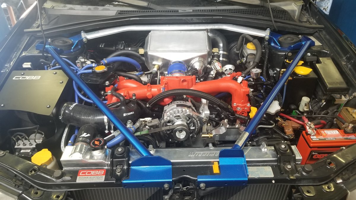

GeneralDisorder Posted November 10, 2018 Share Posted November 10, 2018 I refer to most everything as junk. And I trash on most of it. It takes quite a machine to impress me these days. Here's a work of art. 500 AWHP. Yes, I built it. No, it isn't mine: Link to comment Share on other sites More sharing options...

Myxalplyx Posted November 30, 2018 Share Posted November 30, 2018 On 11/10/2018 at 4:11 PM, GeneralDisorder said: I refer to most everything as junk. And I trash on most of it. It takes quite a machine to impress me these days. Here's a work of art. 500 AWHP. Yes, I built it. No, it isn't mine: Expand Gawd...this is beautiful Link to comment Share on other sites More sharing options...
GeneralDisorder Posted November 30, 2018 Share Posted November 30, 2018 Thanks! She's not mine. I just designed and built it. But the customer lets me use it for promotional purposes. GD 1 Link to comment Share on other sites More sharing options...
