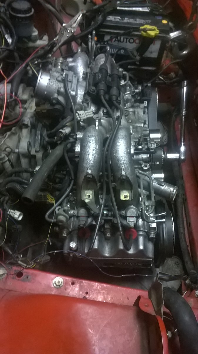

sparkyboy Posted November 15, 2018 Author Share Posted November 15, 2018 (edited) On 11/14/2018 at 7:49 AM, jono said: did you need to space between any mounts or cross members to fit the EJ22 and clear the underside of the bonnet ? Looks very clean and tidy Does the bonnet release work ? I'd love to see a pic of the EJ in the engine bay .... Expand The 85 xt still has her factory ea82t The ej swap was in my 86 GL and to answer your question the engine dropped right in with no modifications I understand the xt is the same frame and suspension setup as the ea82 cars so I'll be happy if the swap goes half as smooth. And I am trying to slap the turbo setup on as quickly and cheaply as possible, I have 2 IHI turbos that came factory on ea82s Edited November 15, 2018 by sparkyboy Link to comment Share on other sites More sharing options...
sparkyboy Posted November 15, 2018 Author Share Posted November 15, 2018 My 86 GL 1 Link to comment Share on other sites More sharing options...
Steptoe Posted November 15, 2018 Share Posted November 15, 2018 I misread as you already got EJ in the XT Word is you need to space the front castor bar bracket further from the body to clear underside of bonnet Your EJ looks to be free from AC and PS. I just measured up an EJ20 alternator only drive belt to be about 5PK700 and luckily that is a size available My project is EJ20 into std height EA81 Brumby Link to comment Share on other sites More sharing options...
sparkyboy Posted November 16, 2018 Author Share Posted November 16, 2018 On 11/15/2018 at 7:16 AM, Steptoe said: I misread as you already got EJ in the XT Word is you need to space the front castor bar bracket further from the body to clear underside of bonnet Your EJ looks to be free from AC and PS. I just measured up an EJ20 alternator only drive belt to be about 5PK700 and luckily that is a size available My project is EJ20 into std height EA81 Brumby Expand Hmmm, I'll do a little more research on the subject and look into the hood clearance thing. Oh and a fan belt from a 96 or something ford escort works perfect for ej swap with no power steering or ac. Link to comment Share on other sites More sharing options...
